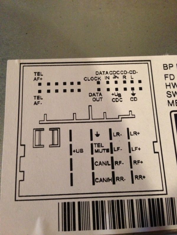

All I can think of them is the previous owner may have fitted a new stereo and changed the aux wiring to work with that, and then before selling put back in the original head unit without correcting the wiring. Might be worth removing it and check the quadlock wiring against the diagram on back of head unit.
Cheers mate, I spoke to the previous owner and apparently the car used to have a CD changer in the boot. I'm guessing this could be the issue, maybe some wires need changing back?
Yes that is probably your answer as the CD changer uses the same connection as the AUX input. You'll need to pull your radio out and make sure the AUX wiring is going to the right pins on the quadlock.
This is the pin out for the stock head unit in a 07/ 08 Leon:
Cheers I'll have a look, so the chances are the aux wiring has been put into the cd changer but after the cd changer has been removed it hasn't been put back where it came from?
I think they share the same wiring, so the AUX would have been removed and replaced by the CD changer but it hasn't been put back.
