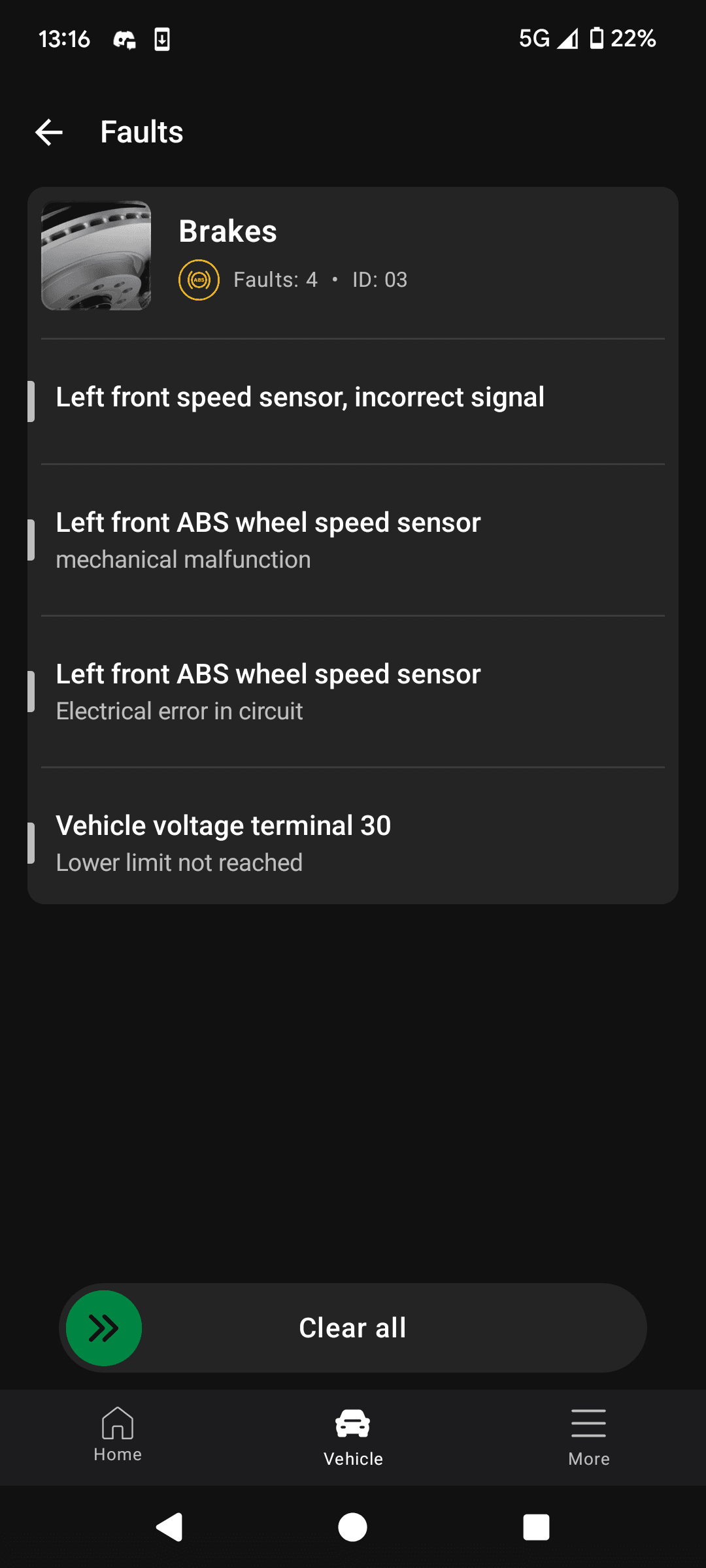

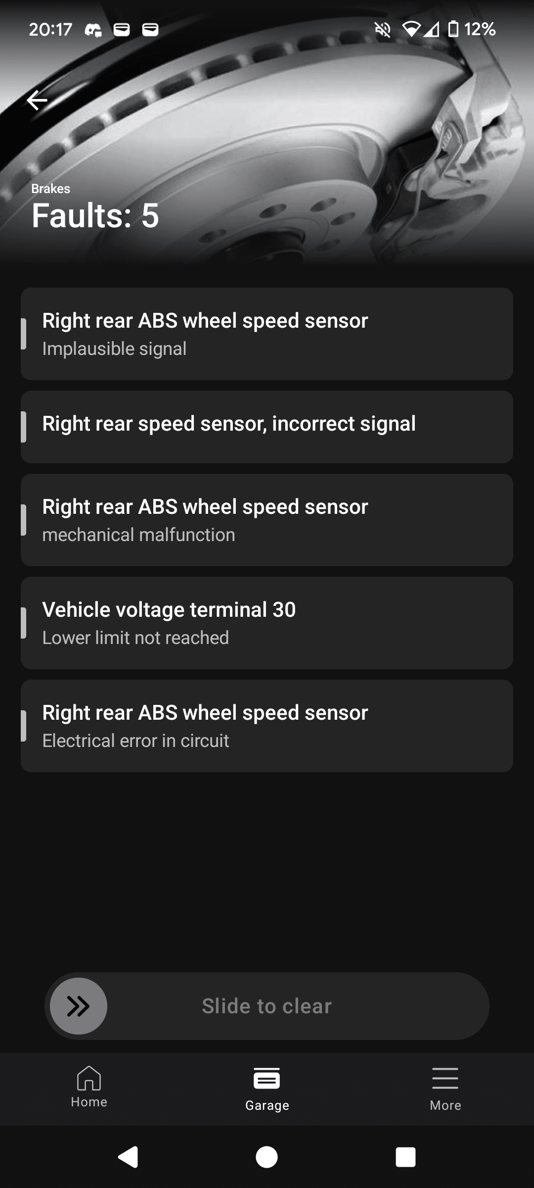

I am having issues relating to my Traction Control, ABS and Tire pressure lights.
I have an obdeleven scanner and diagnosed the rear right sensor, but having replaced it the problem partially improved but moved to the front left.
Does anyone have any ideas?
Ps, I also occasionally get an error on my dash saying Start-Stop error, potentially related?

Where is the BCU located? Perhaps there is corrosion?
What voltage does the battery have during startup? Otherwise, you'll need the circuit diagrams. I don't think all the sensors are defective. Do a log run with all four sensor signals and KL30.
So with my battery the meter says a minimum of 9.3v at starting.
The lights have disappeared from the dash since removing and reinstalling my battery but refuse to clear with obdeleven.
