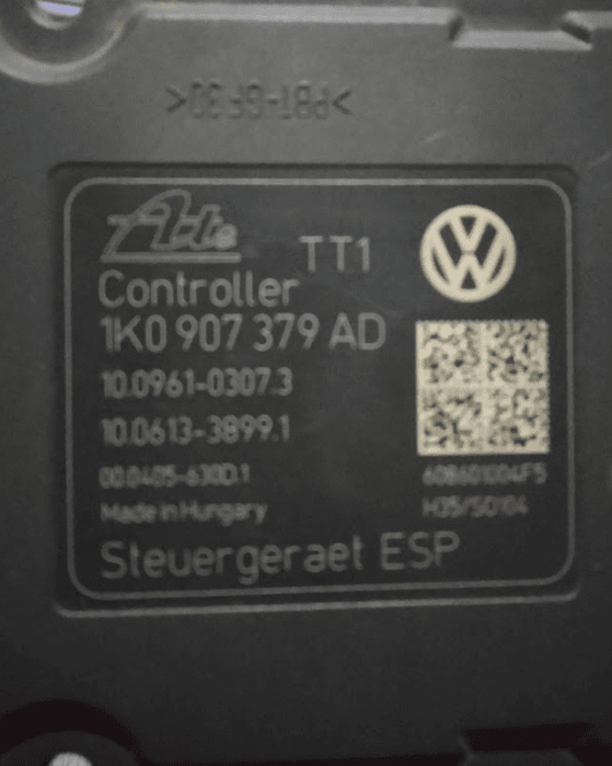

I had these lights on, I recall the break light blinked and another times wont.
To make it shorter, my abs module had a factory fault and it was replaced by SEAT without cost, recall program.
This was my failed ABS module...
The cars affected report:
