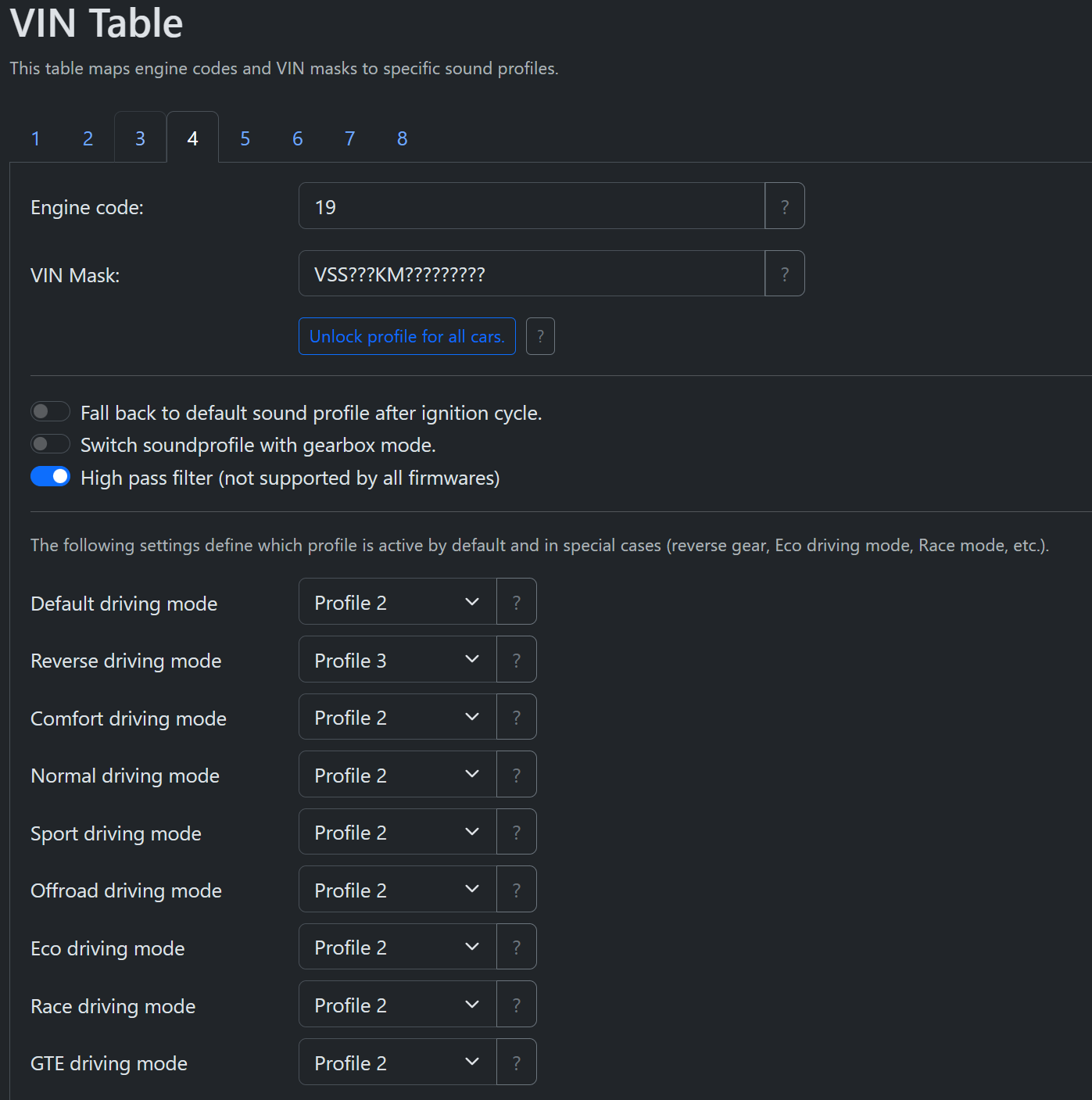

A table with a VIN mask, that determines if this firmware has settings specific for your car, and wihich sound profile is attached to which driving mode:

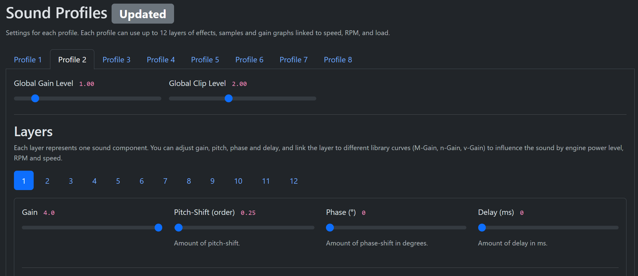

The sound profiles (there can be up to 8 to choose from):
Each profile can consist of up to 16 layers, that each have their own sound sample (the "shape" of the sound) effects and speed, RPM and engine power behavior curves.

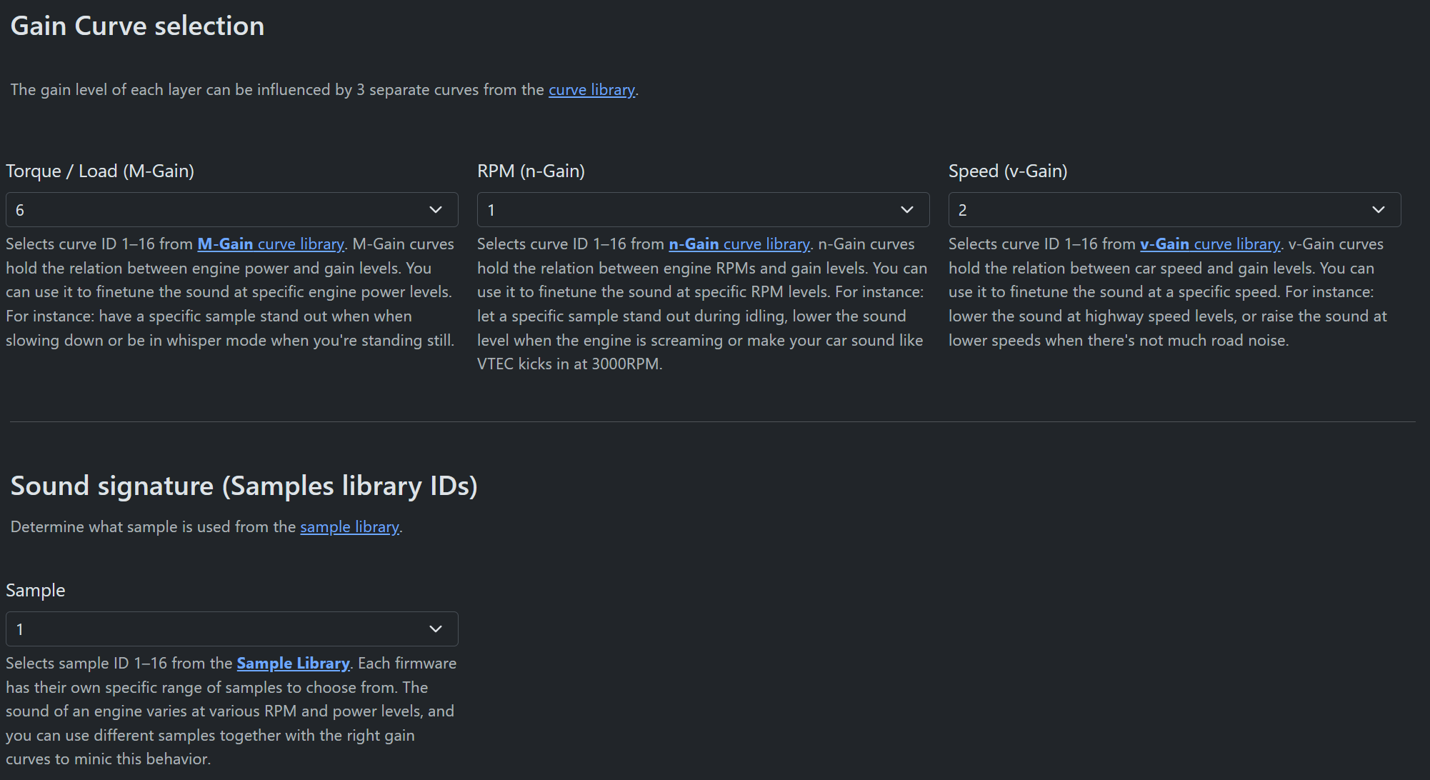

The behvior curves and samples can be chosen for each layer of each profile:

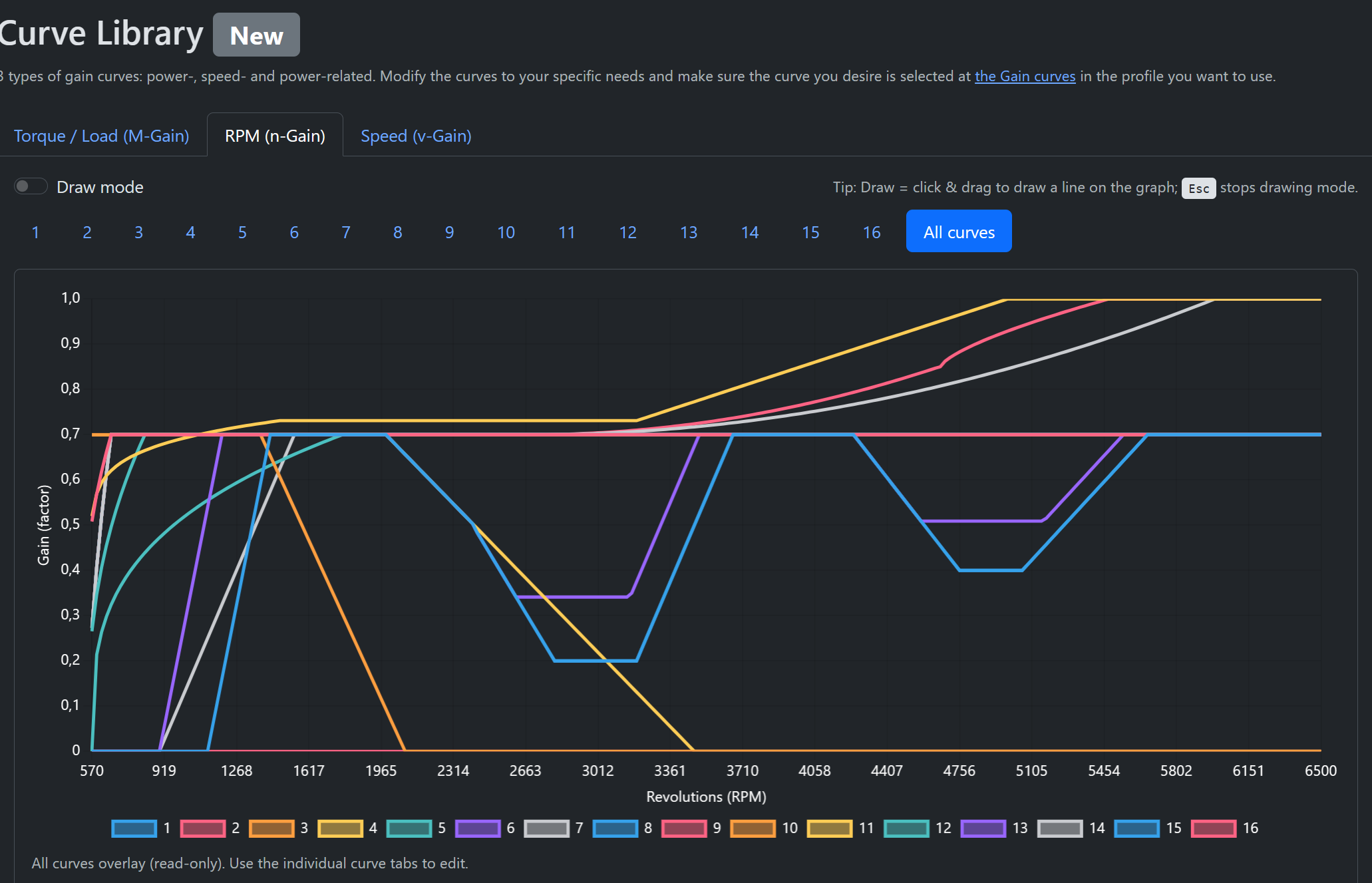

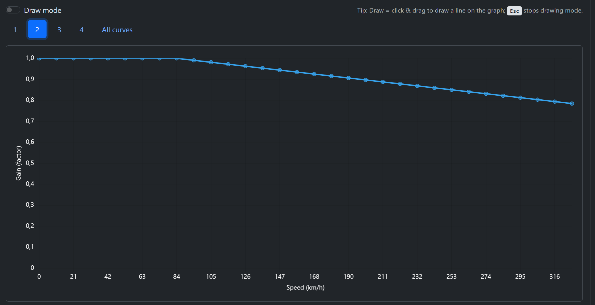

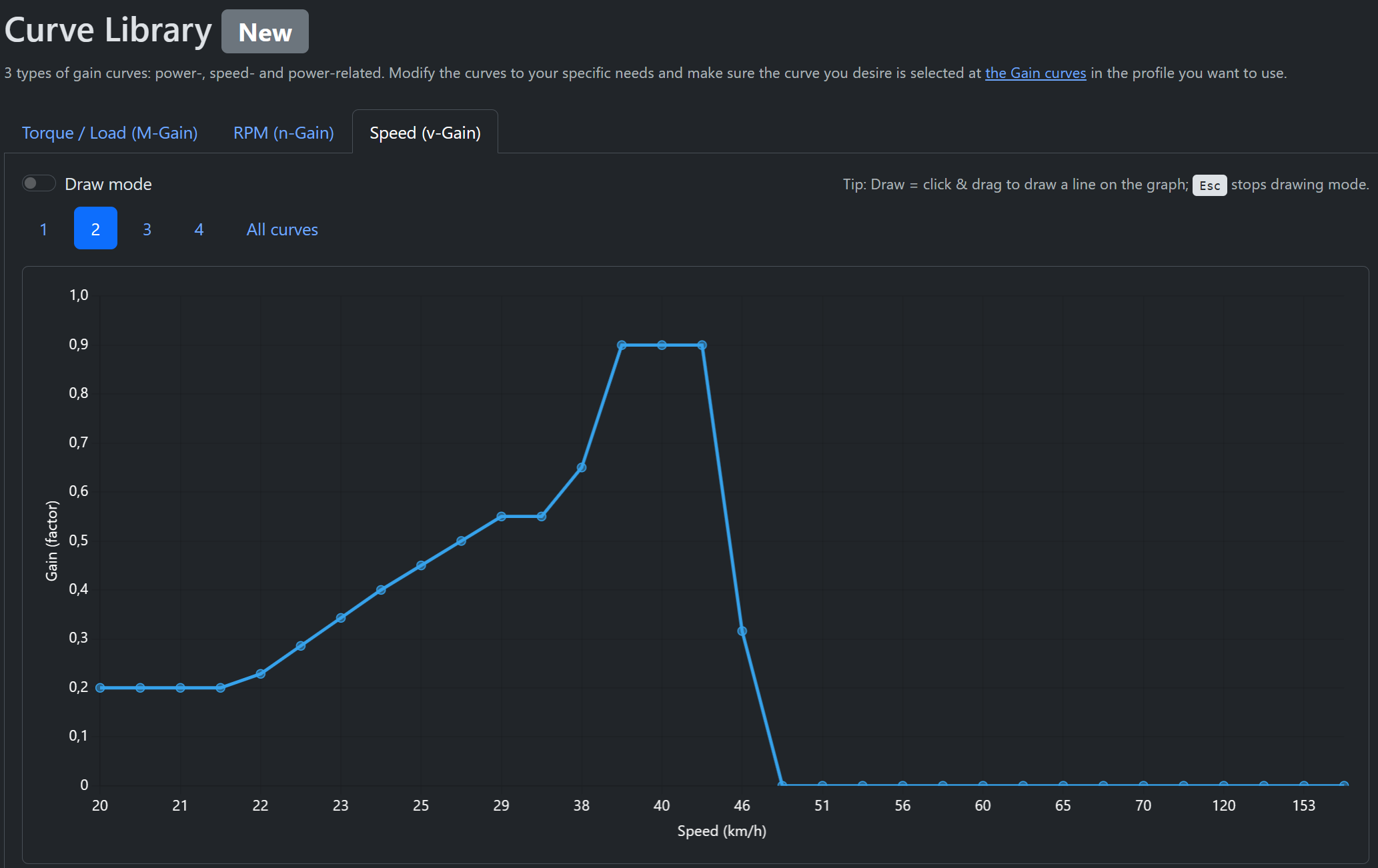

And then the curves themselves can be viewed... and modified. In the screenshot you see the speed behvior: the sound will become louwder as the speed rises, and beomes completely silent after 50km/h.
This is how it's set up in our cars, but...... in an Audi TT-RS itt's completly different, lowering the noise level a bit when
And things become really funky when looking at RPM graphs for other Audis:

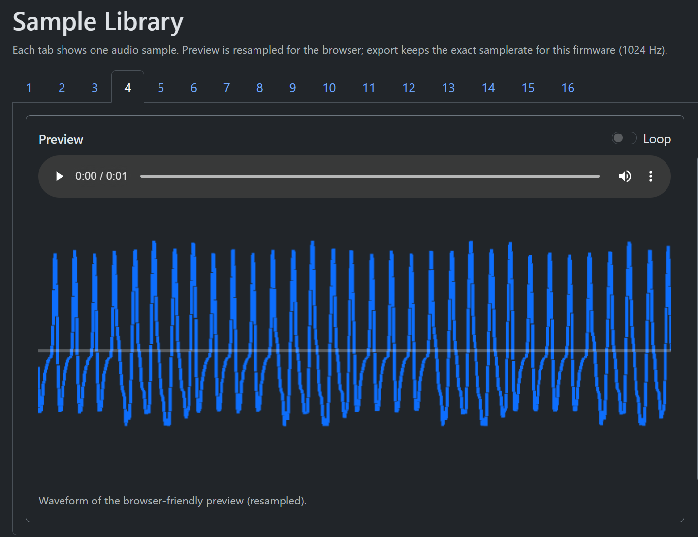

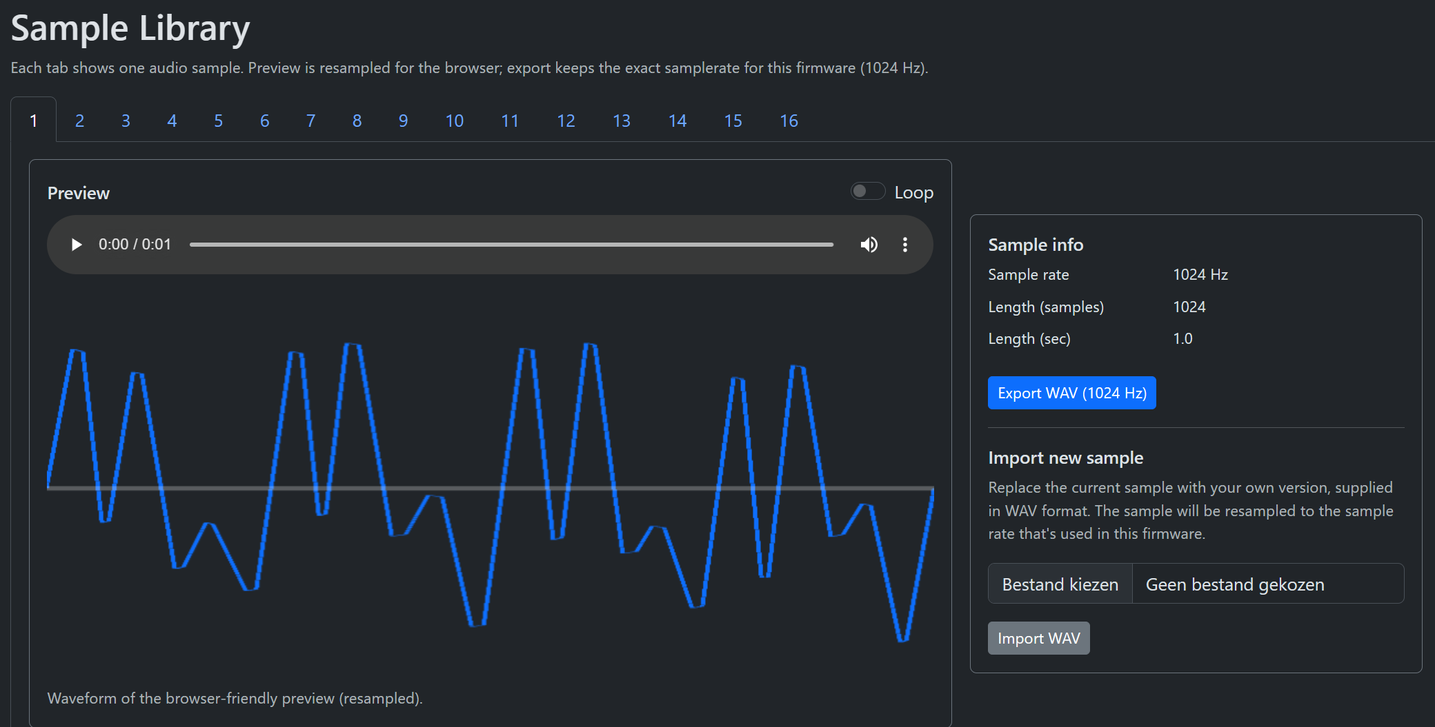

And last but not least: the shape of the sound itself, the sound samples. Each firmware holds a set of samples, which determine the exact sound definition, and whether or not the sound is just a fine rumble, a rattling exhaust, or to act as a masking for road noise:
Formentor firmware has 1 additional sound sample, and it appears to be unused:
