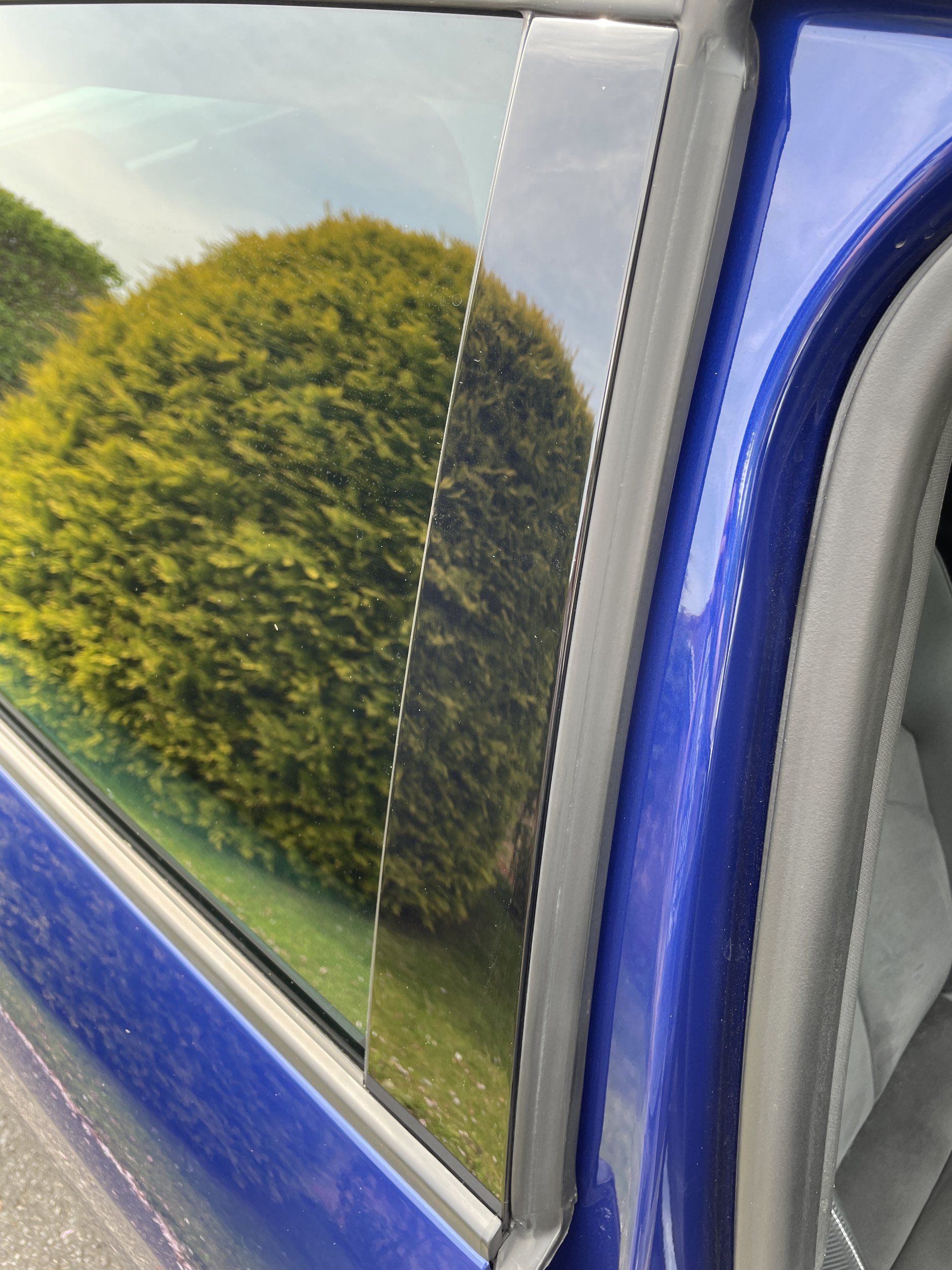

I had the seals on the leading edge of the rear door (window/gloss black section) replaced under warranty for this. The seal on the rear door rubs against the front door when driving.
This strip, that goes all the way up?
Yes, but concentrate on the gloss black section at the top. The bottom part of the door is rigid, but flexes where the window section is.
Any specific section I should lube?
The front face of the seal that I sent in the photo - this is in contact with the front door when both doors are closed. You could also try removing this section of the seal and giving a liberal coat of rubber grease / gummi pflege.
After you have lubricated the seal, you can push the top of the front door frame to hear if the squeaking is still present.

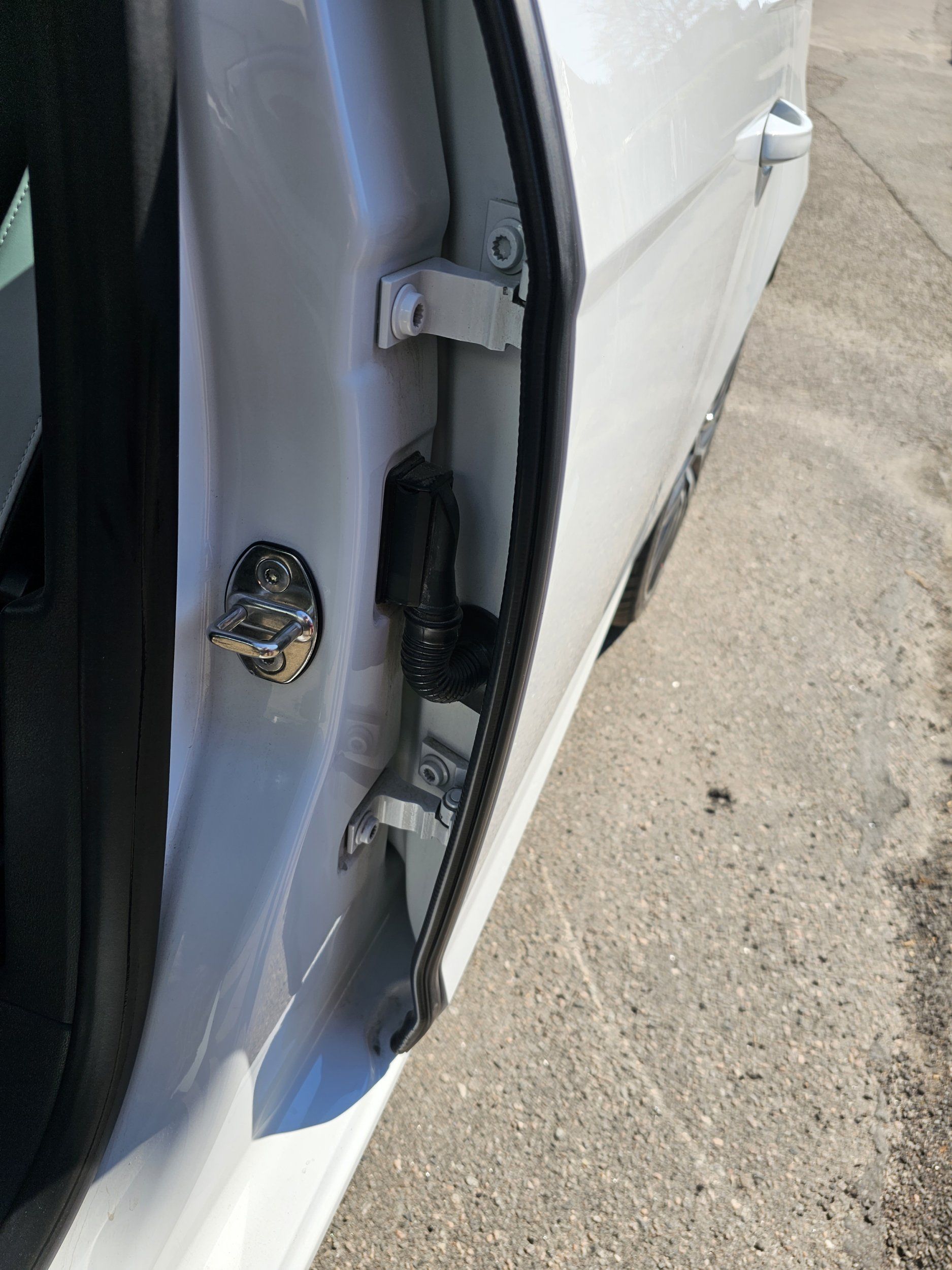

I removed the seal in the picture and greased it up. The sound is still there. The strange thing is that I can't replicate it.
Interestingly the squeaking is now gone. The car was parked outside in the rain over night, so either the water temporarily fixed it or the lube have fixed it over time. Either way that should indicate that the squeaking occurs from somewhere outside that is exposed to water.
Reactions: black_sheep
Update:
The squeaking is now solved. It was not the seals, it was the locking mechanism on the inside of the door that hooks on the metal bar. I cleaned it and lubed it up with PTFE spray and it's now completely gone.
