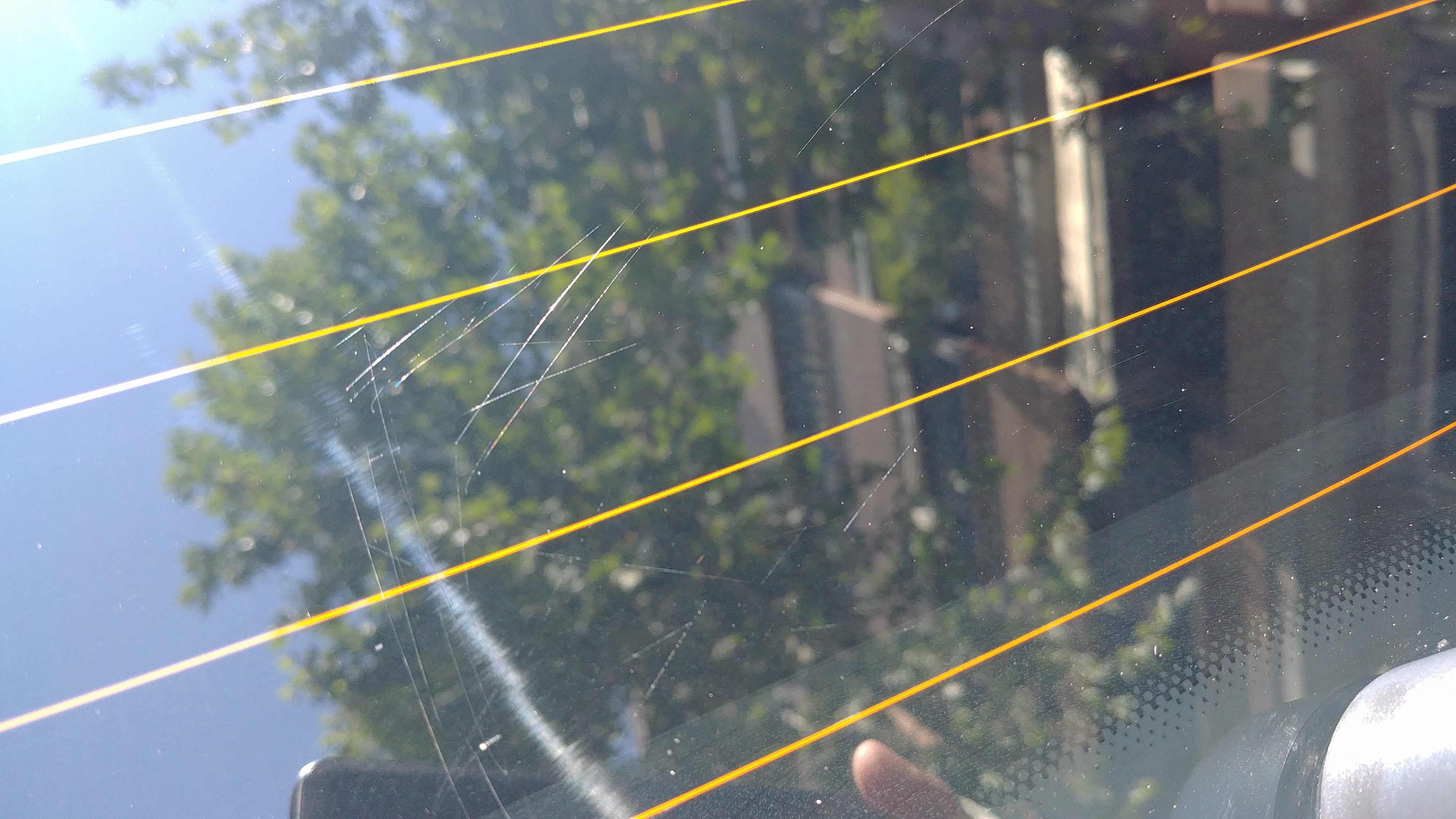

I had my windows tinted and the tinting guy left blade marks on the rear window. Arguing with the shop wasn't going to help. Does anyone know if there is any way to get rid of those scratches ? it looks really annoying..its bunch of mark together. probably the place where he kept the film to cut the corners

I am thinking of using the glass repair kit from GP-WIZ, anyone has used it here?

Surley its their fault so they should pay for repair/replacement glass? businesses should have insurance for this kind of thing.

If the scratches aren't too deep some fine cutting polish may remove them or at least make them less noticeable, I had a few on the front glass and in fact worked hard at them using...... toothpaste, result after a few goes.
