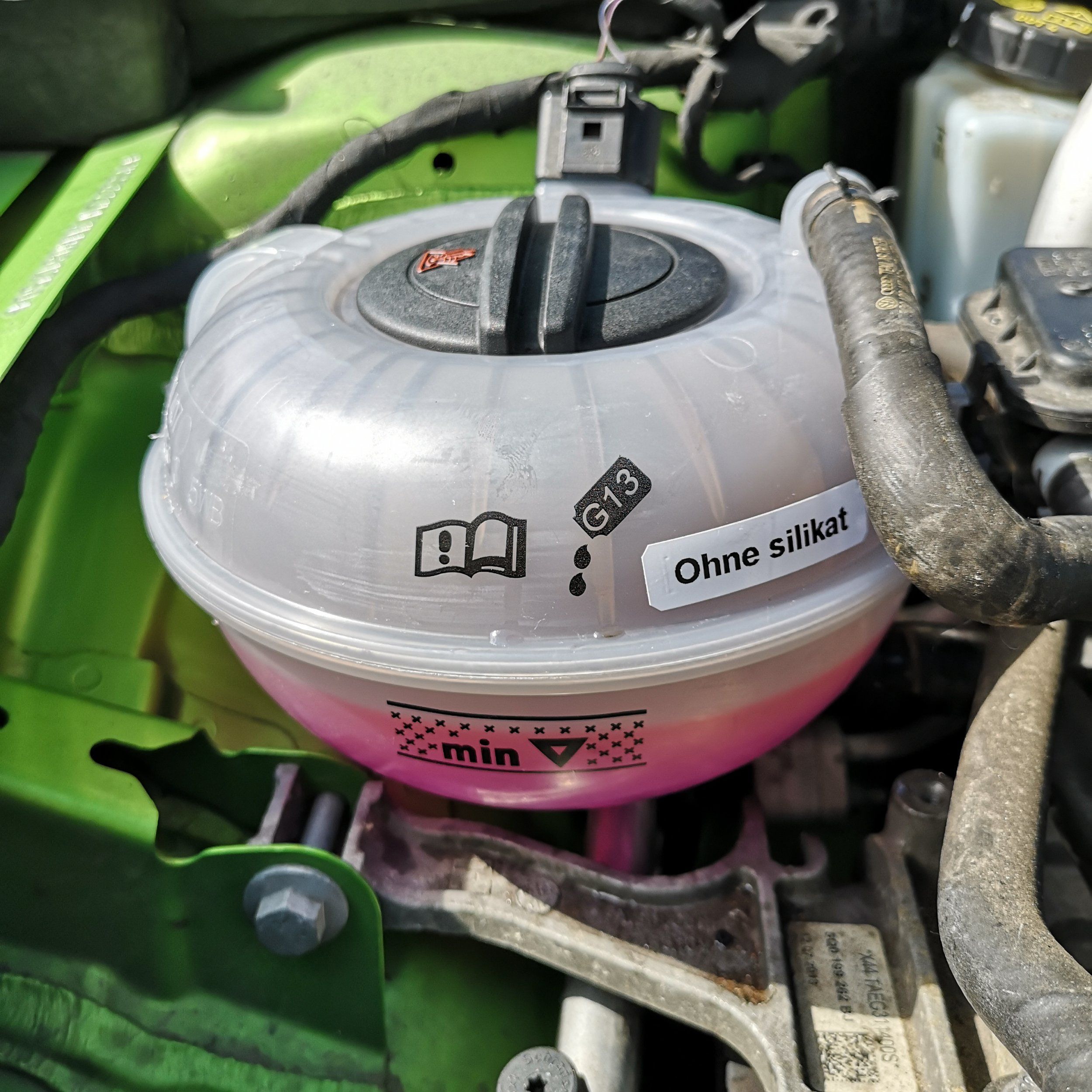

Replaced my expansion tank yesterday, very easy to do. Topped back off with 50/50 G13 and deionised water and no silicate bag to worry about. Out of interest, I've read people say they just fish it out and throw it away but this definitely wasn't possible on my tank. It had a sort of double walled construction with the bag inbetween the walls. You could see the bag if you held the tank up to the sun but it was definitely 'built-in' :unsure:.
Oh, and I added the 'without silicate' dymo sticker for a bit of a laugh ?.
