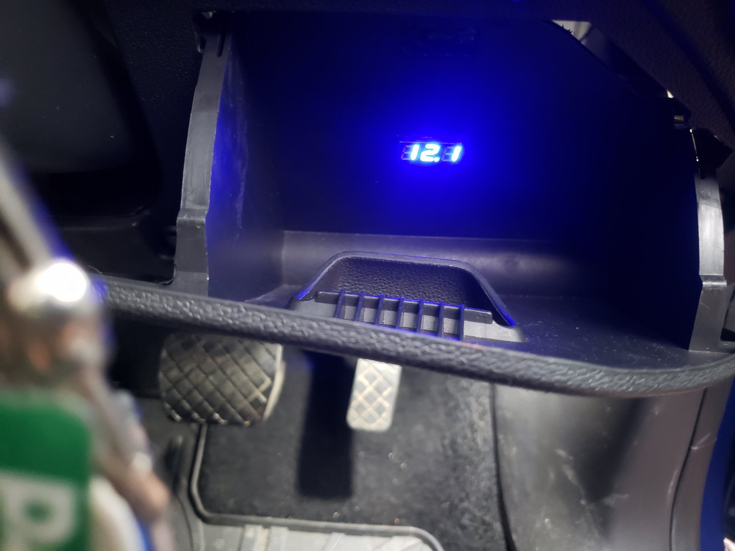

I got up the next morning to go to work and my car won’t start and I get the message on the mfd 12v battery low. i take an alternate mode of transport to work. When I return home I jump start the car. I check the voltages with a multimeter and it reads 14.5 volts suggesting to me the alternator is ok. Checked against a neighbours car while that was running and theirs read 14.2v. I’ve checked my cctv and it appears no lights were left on to drain the battery. i didnt have time to mess around charging so have put a new battery in and the car has been fine since.
