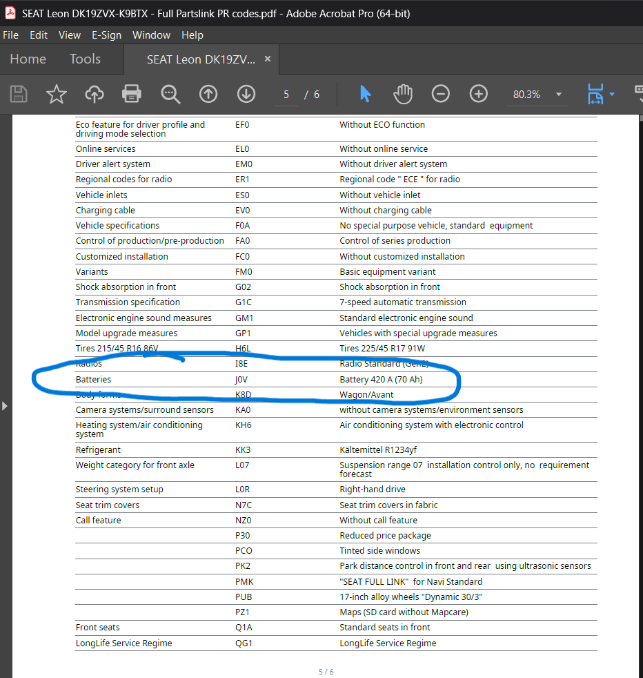

Yes, that is my point - the OP has a 2.0 TDI - but has fitted an EFB.
The full option map shows a build code of J0V for the battery, and ETKA shows EFB 420A/70AH for the build code J0V on my car. Screenshots attached.
That's the exact battery that was originally in the car that I replaced.
The only change has been the uprated capacity of the replacement.
The genuine battery cover for your car: 5Q0915411E
Protective battery casing with cover
PR:J0V+TJ1, TR1,TS1+7L6

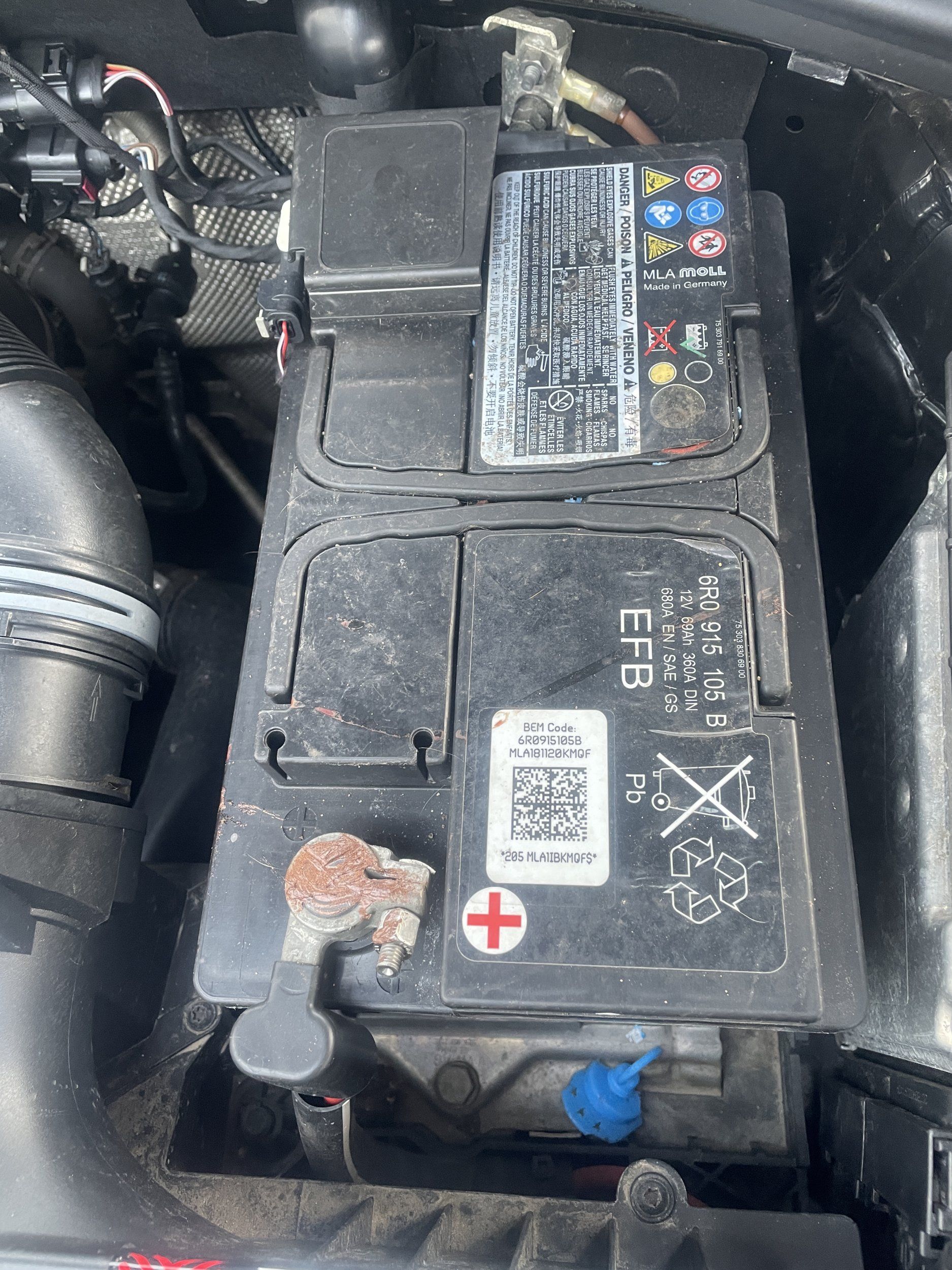

Quick update - I have again had the battery tested today as the car was difficult to start first thing on the cold mornings recently, and lo and behold it came back as having a cell down........Euro Car Parts were brilliant about it, and said it needed a warranty replacement.
I have taken the opportunity to upgrade the EFB battery that was on to a Bosch 70AH 760CCA AGM battery, and all has been recoded to reflect the change.
I also picked up a genuine thermal battery jacket, so that's gone on with the new battery too. Hopefully this is the last of the problems.
Thanks for all the replies and help, much appreciated

It's a big battery on that - from your photo and a bit of research it's the same physical size as the one on the 2.0TDI, 278mm length, 175mm width, 190mm height.
Correct thermal jacket is 5Q0 915 411 E, which retails at £35.55 + vat, £42.66 inc vat
Brilliant thank you mate, i wonder why mine is missing seeing as the battery looks original?
Dunno, mine "looked" original when I got the car, but the jacket was missing. I strongly suspect that as an ex-lease car, the battery was swapped out for a knackered one before it was returned, and the jacket was simply not replaced
Same size battery as the Banner EFB on my 2016 MY 1.4ACT.
