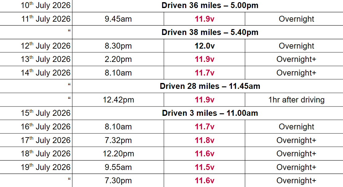

Can anyone shed any light on my battery problem my Formentor battery doesn`t appear to be holding a charge very well, its two and a half years old even after a 90 mile trip followed 2 days later by another 20 mile trip and then 2 days later it was down to 11.5 volts the alternator output is OK @ 14.3 volts but unless I drive the car everyday a decent mileage I have to keep putting the battery on charge, now its going in to the Cupra dealer to have it checked as the battery is guaranteed for 3 years but I suspect they will tell me its still serviceable (wear and tear) altough I have just had a warning about low voltage along with reports that the rear traffic alert was not available,. I put it on charge and then it was all OK.

Well so much for hopeless Cupra dealers help yet again, after nearly 2 weeks to get the battery checked as it is under warranty I took my Formentor in today and after an hour as I waited they informed me that they need to put the battery on charge for 2 - 4 hrs but they didn`t have a charger available to do it to see if the battery is charging so a Cupra dealer with all their "Technicians" and equipment they couldn`t do a load test to assess the state of the battery when I have done it myself to confirm the battery is faulty!
