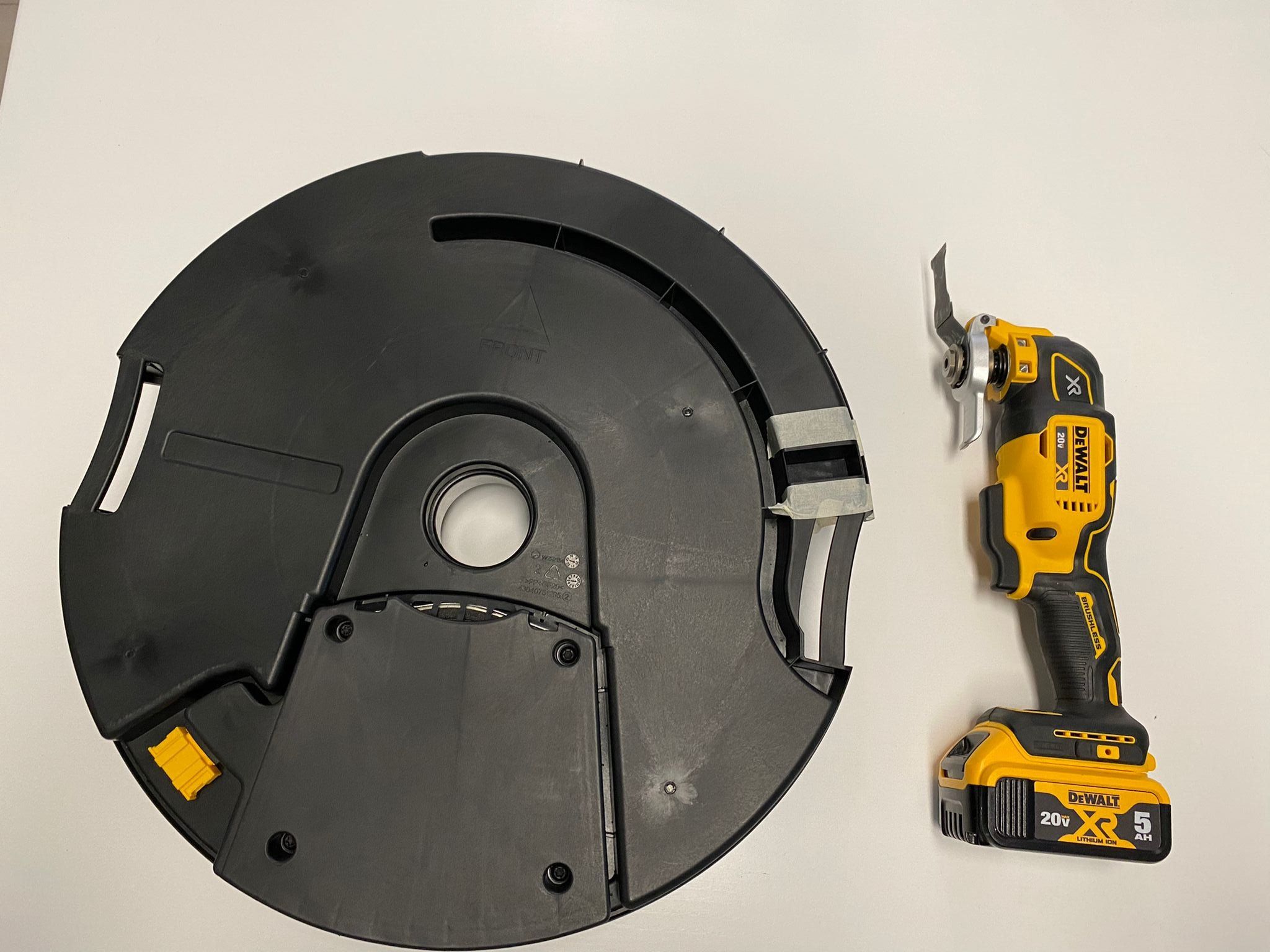

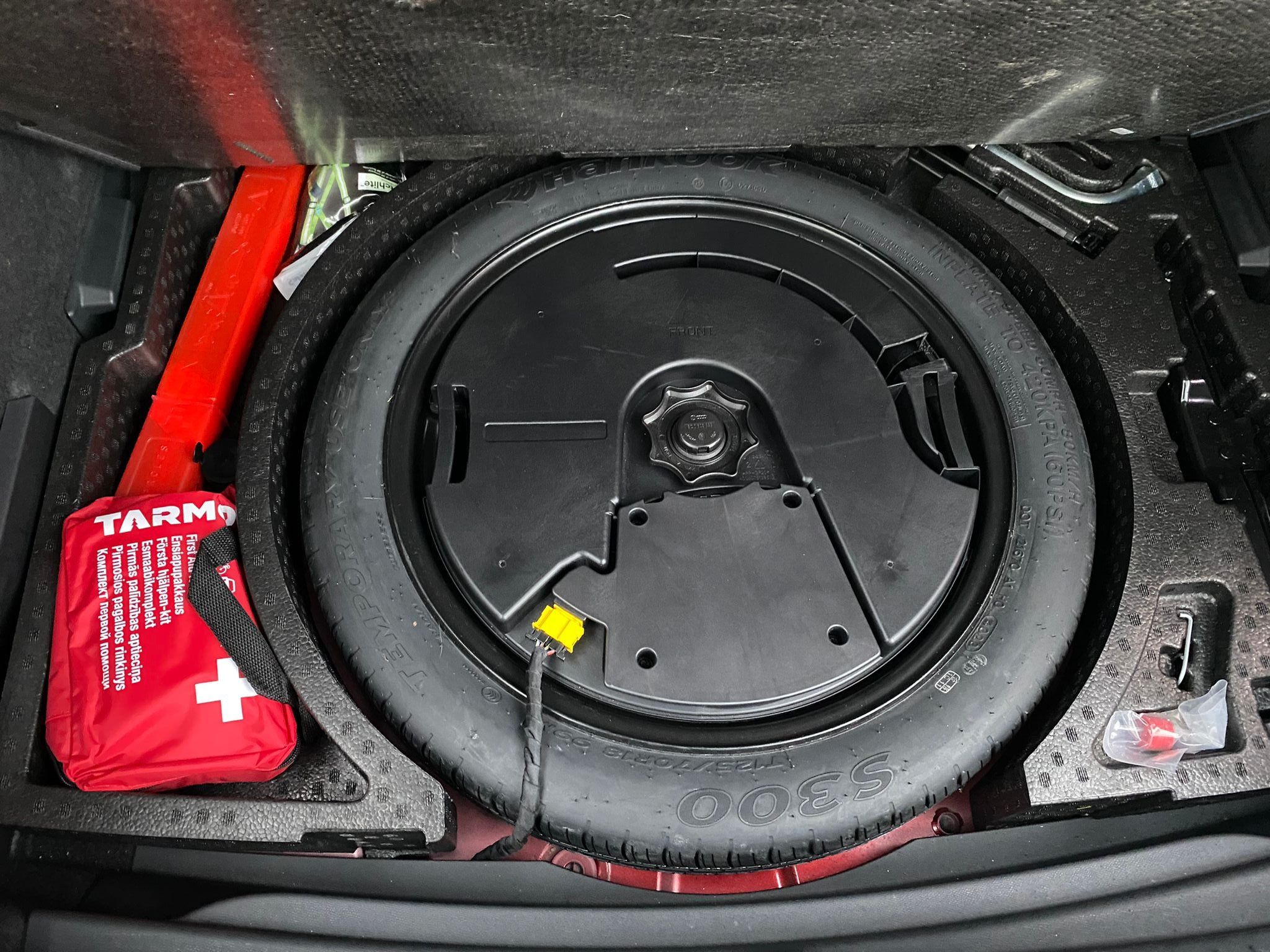

Basically, the spare wheell subwoofer is in an "compression" box, which has a closed bass reflex channel. Apparently in some VAG cars with more advanced systems, the bass reflex channel is open, and the subwoofer is 20-30% louder than the enclosed version.

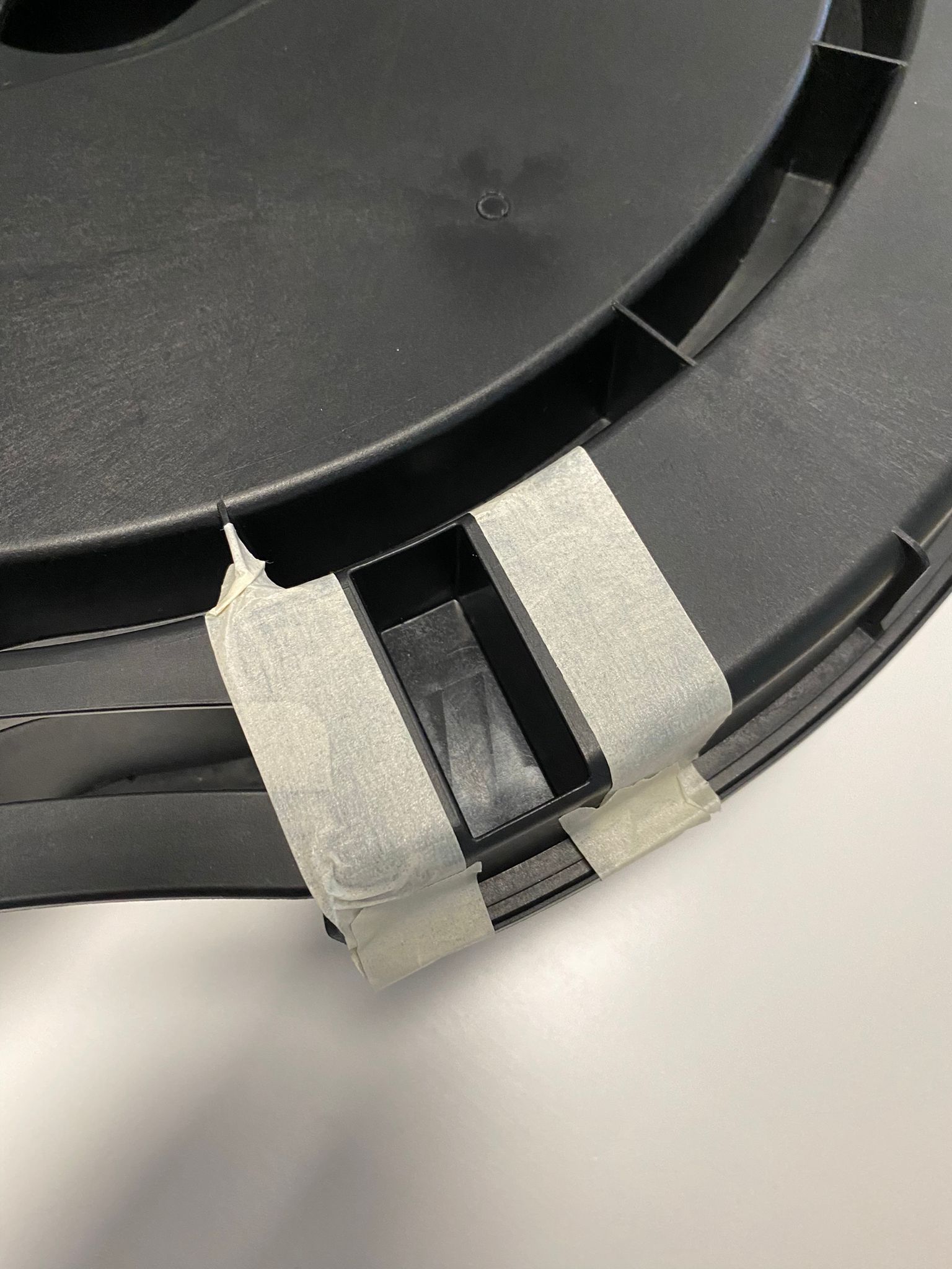

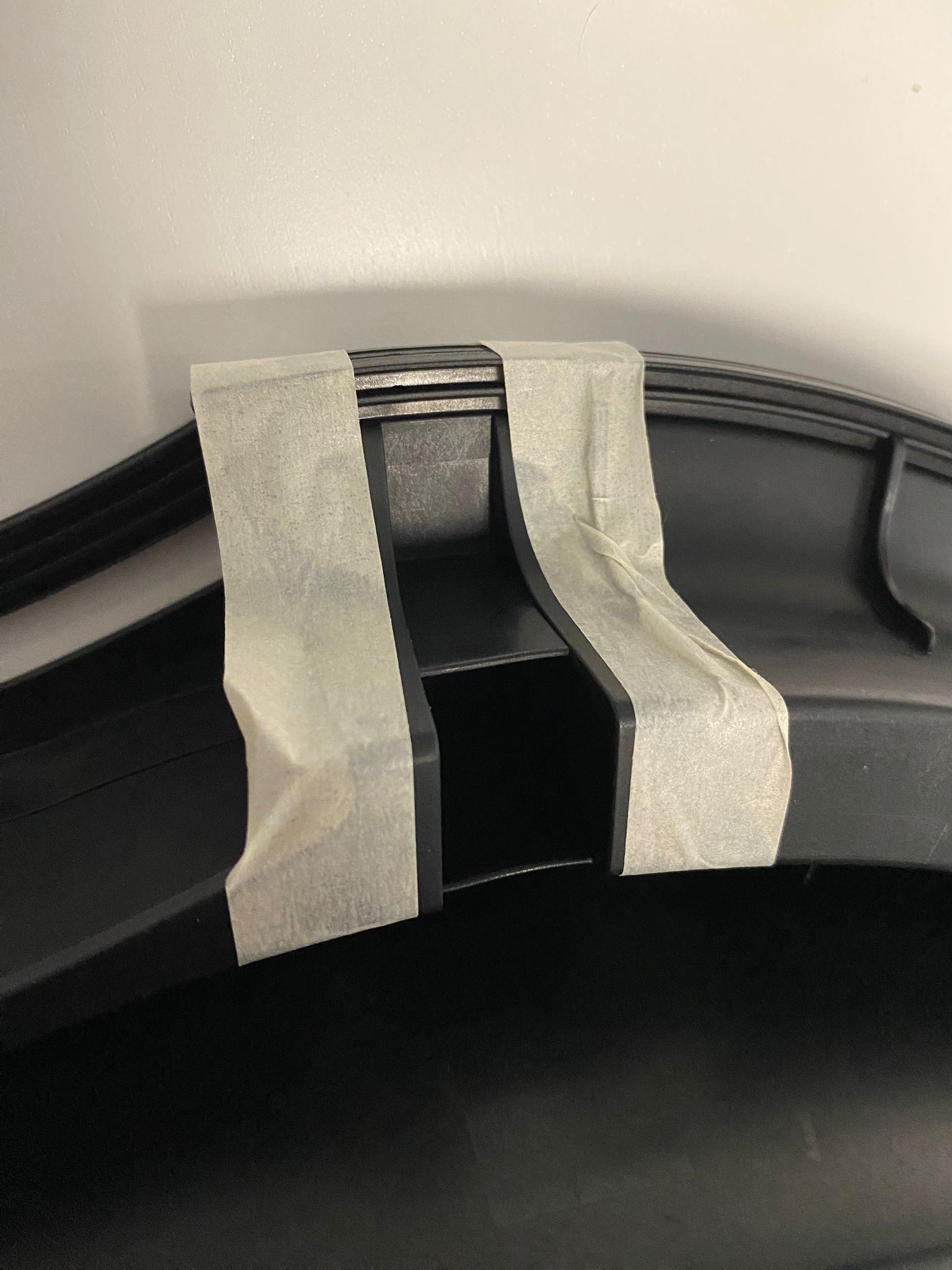

In the video, they are modifying the original enclousure, and cutting away the plastic which is closing the end of the bass reflex port. After that is done, it seems that the difference is noticable, and the comments in the video confirm it as well.

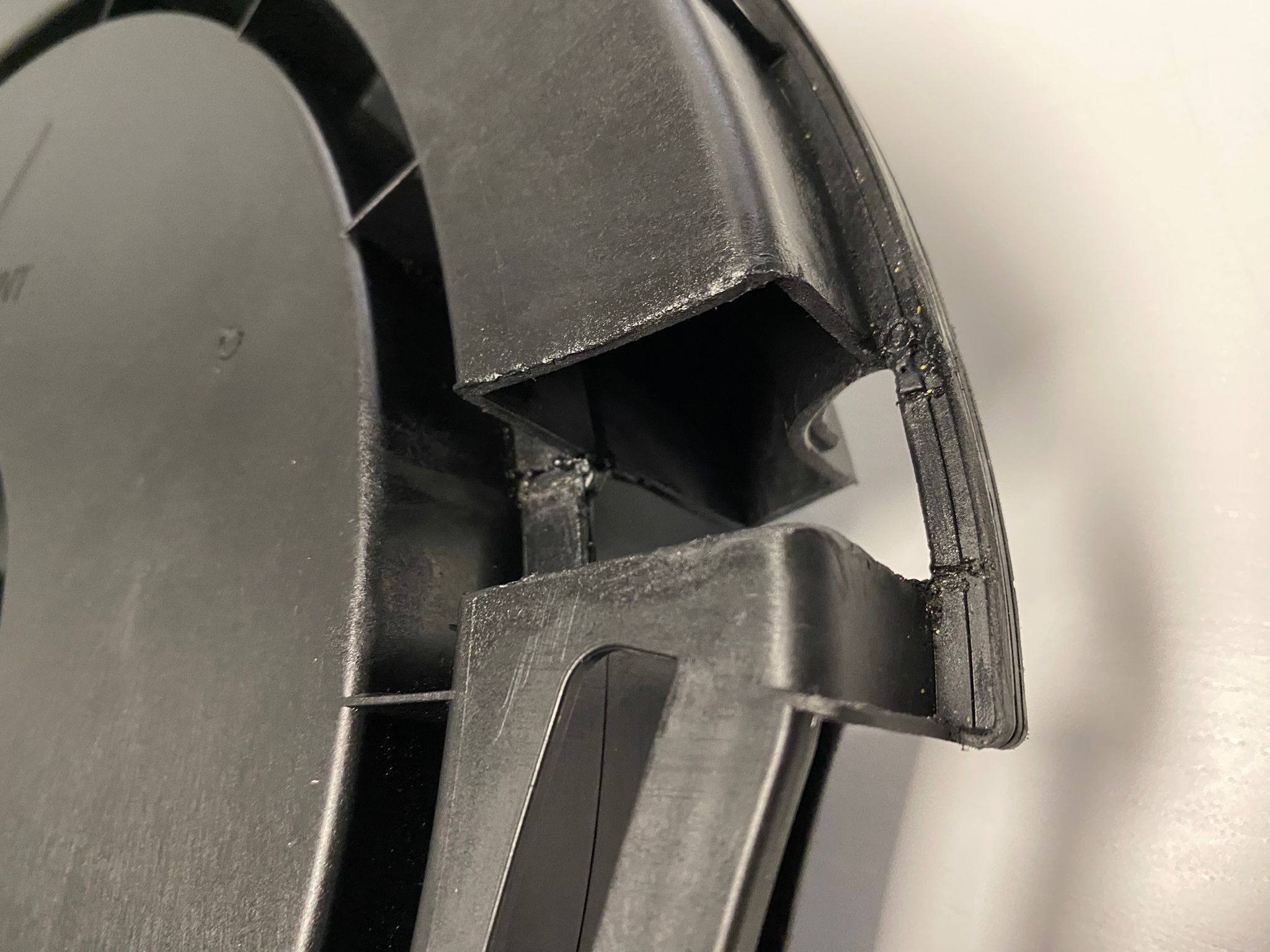

Operation successful.

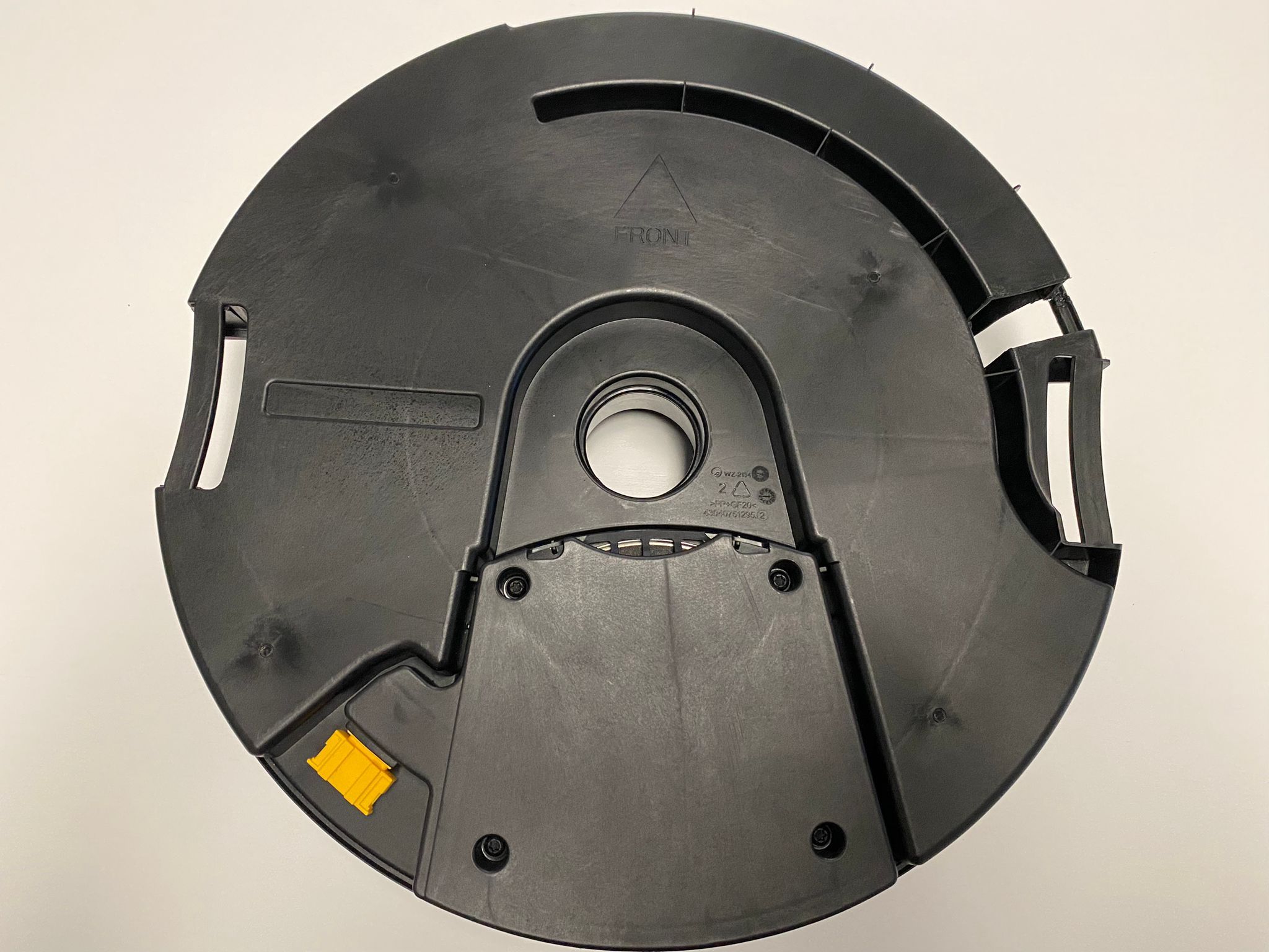

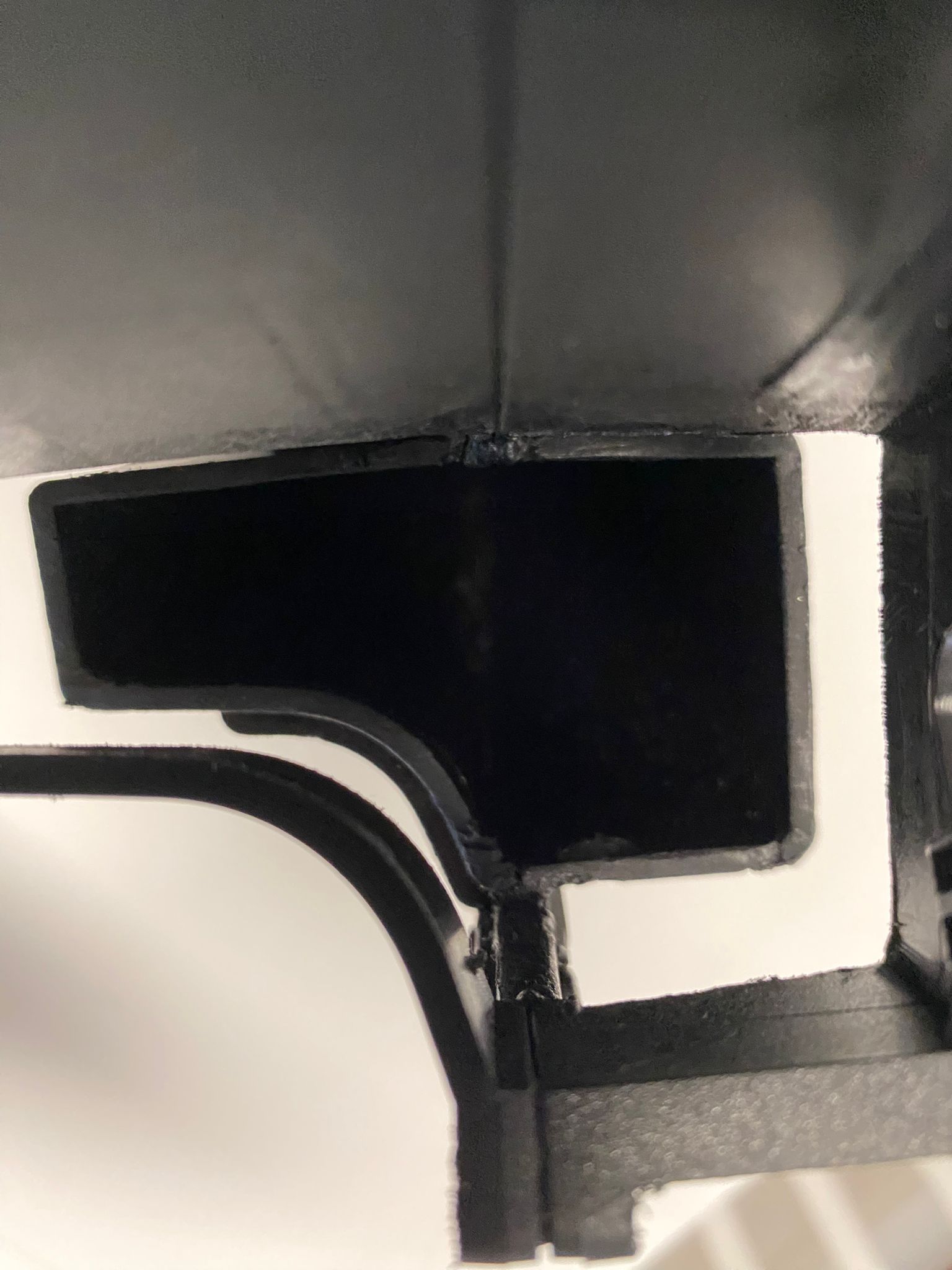

I followed the instructions on the video and opened up the "Port". It is not the nicest looking modification, but it works.
Compared to the enclosed version, this plays quite lower, and a bit louder. Definitely worth the 30 minutes of cutting / breaking / sanding / melting.
I think the next step will be to replace the subwoofer speaker itself, as the quality of the original one is quite poor.
