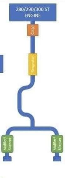

i have a cupra 280 st 2015 which i believe is non-gpf. Im starting mods on the car and wanted to get a better understanding on what the best exhaust system upgrade is.
I want the sound to be a head turner but at the same time less or no drone preferably.
do i go for non-res with back box deletes or keep the back boxes or the res or which one haha?
also, do i go custom or scorpion/milltek etc
attached is what the exhaust looks like
I’d keep the back boxes n do a res delete. I’ve done that on my 280 hatch, and the sound is perfect. I think it’d be too loud without the back boxes. I’d go custom too, unless you can find somewhere that has a pipe made up already.
