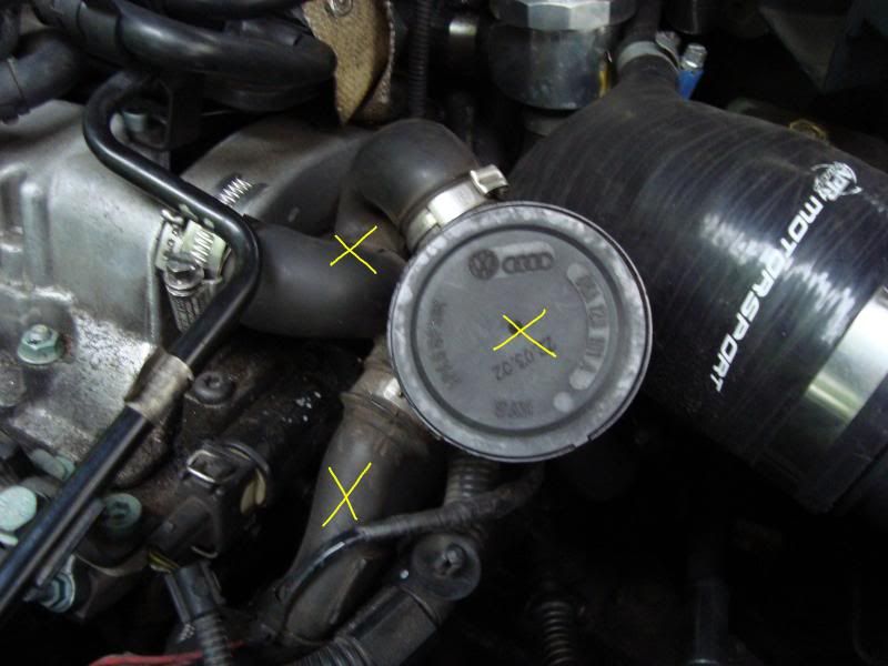

Checked but it looks ok. Did'not know this was a seperate error, because VAGCOM counts it as 1 with the 16487 error.
