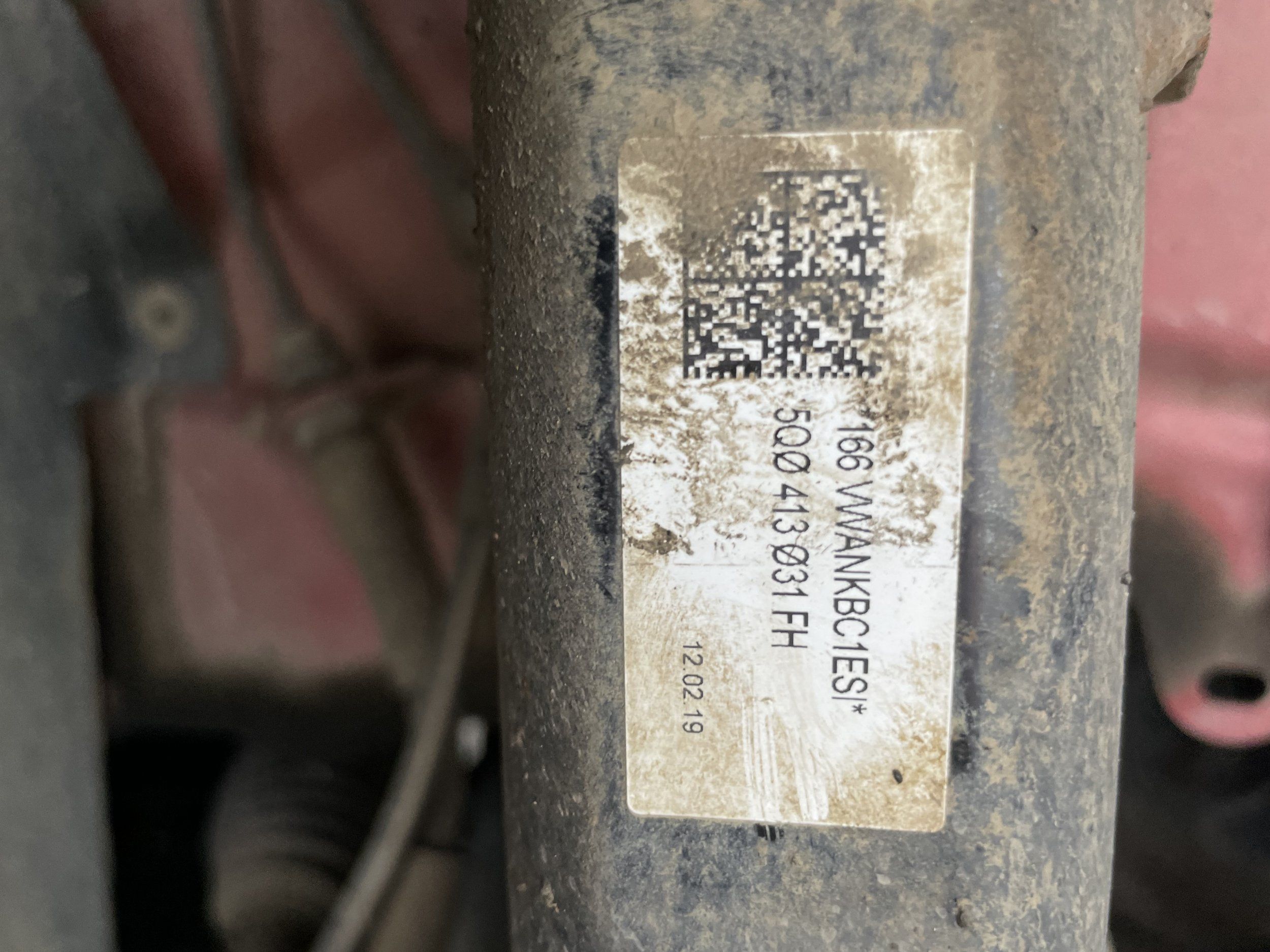

thanks for the information on the body diameter, I will get you the picture from the shock absorbers part number

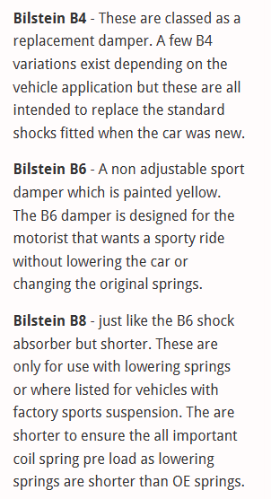

This is how Bilstein describe them:
Bilstein doesn't recognise that OE number but Monroe and Sachs both link that number to a 55mm damper.

The Bilstein B4s are a great 'improved quality' shock over OE spec ones, that will give you the same ride / handling feel but just 'better'; although let's face it any new shock should feel better and tighter than your current 6 years old xx,000 miles OE ones.
The B6s are a step up and will give a sportier feel with tighter body control / better handling etc. They're ideal if you want to upgrade to a 'Cupra'.
I ran B6s on a Skoda Yeti for many years that helped make it into a vRS. ?
