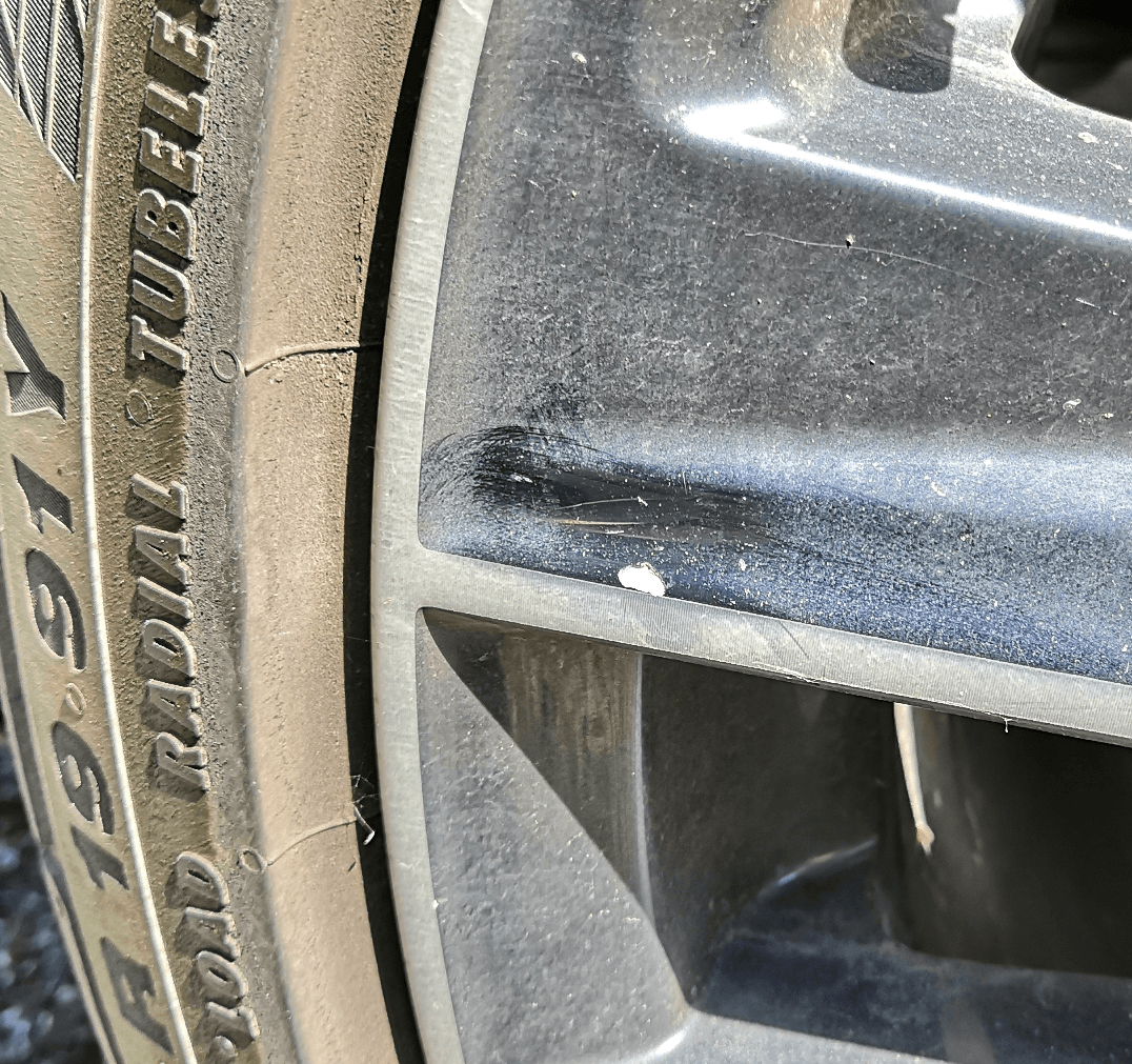

I have annoyingly chipped the black part of my Cupra wheels, a fairly small ~4mm chip roughly circular. Before I order some generic black touch up paint (such as this) just wondering if anyone knows a specific paint code or product that matches this colour well?

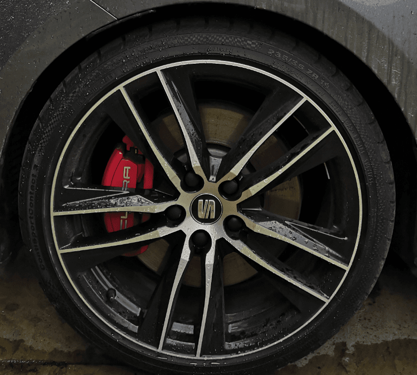

An older picture not showing the damage, but it is these wheels:

Edit: Pic of the damage (excuse the dirt)

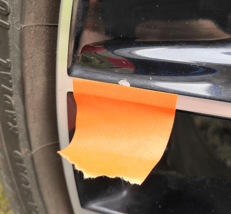

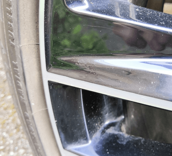

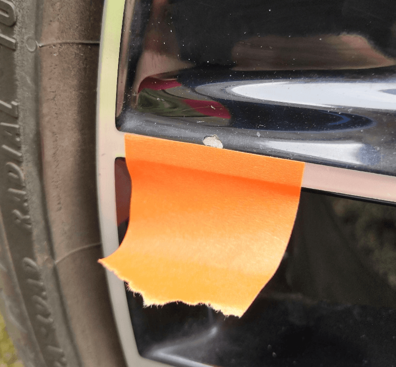

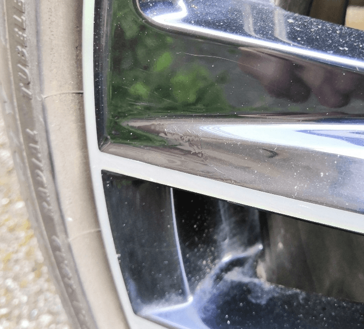

Ended up just buying generic black touch up paint as suggested. I put some tape over the silver part, put a few layers of paint on the chipped part until it was thick enough. At that point it was kind of raised higher than the surrounding paint so I did a tiny bit of sanding to make it more flush. This made the area a little dull but after that I put some clear lacquer over it (which I was going to do anyway) and that cleared it up. Made a bit of a mess with the lacquer but overall it came out OK.

Decent job to be honest, not noticeable at all now. if you stand 1 feet away.
