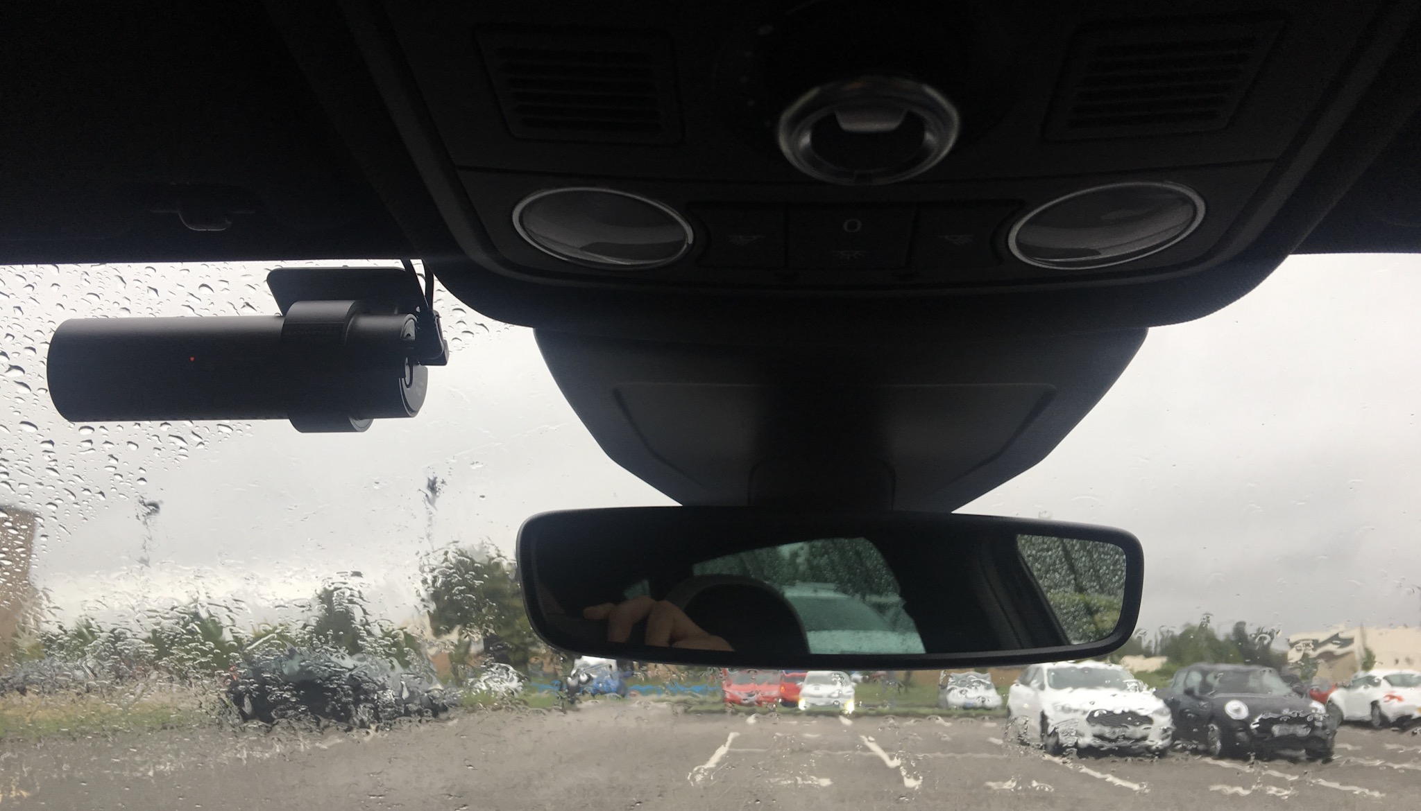

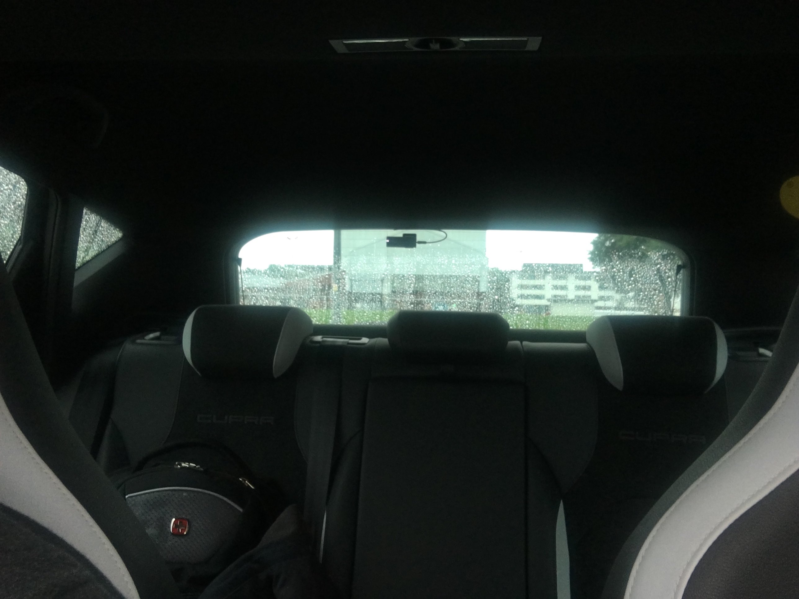

They put the rear camera about 10cm down from the top of the glass, central, right in my eyeline which was distracting. I moved it up and to the side when I got home, but still in the swept area. They didn’t route the cable through the hatch grommets but for £50 I wouldn’t expect them to. The field of view takes in several heating elements which can’t really be avoided - they are not too distracting.
The front camera is hard to position because the large sensor housing pretty much prevents the camera going behind the mirror without being quite obtrusive. That’s not the fault of the camera, but a smaller unit would have been easier to site. We settled for high on the passenger side as the best bet, though it fouls the sun visor slightly (because of the camera depth) and the field of view isn’t as good as it would have been centrally mounted. I may move it.
