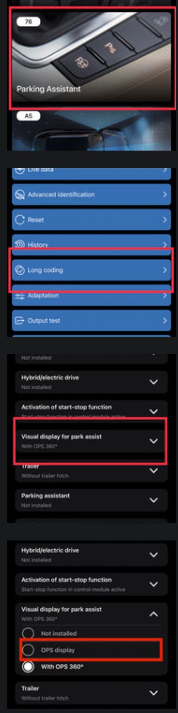

For OPS on display, you may just need to enable this via the 'Parking Assistant' Control Unit, under 'Adaptations' or 'Long Coding' and then search for 'Park Pilot' or 'Park Assist' as attached
Good luck

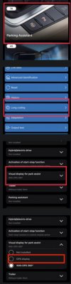

Took a while but got the obd 11 device with pro VAG plan. Had a play around today and successfully managed to change the mirrors to fold automatically on locking the car and changed the central small infotainment screen to have the carbon background - which looks pretty cool :)
Found the settings for adjusting the dimming of the dash but when I try to change them it says function not available… Will try again tomorrow and perhaps look through the OBD forum but if anyone has any tips I’d be all ears! :)
