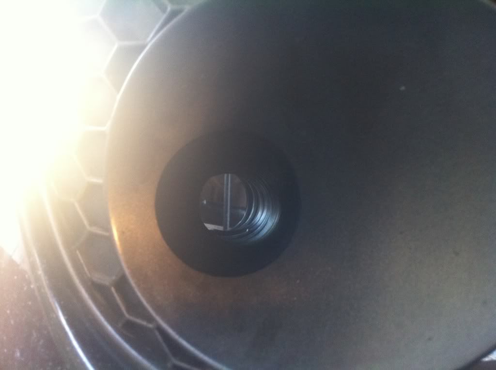

This is very frustrating, can't seem to find a decent post on any brake cooling duct modifications carried out to our MK1's.
I will begin working on doing a brake cooling duct for my car and if all goes well I'll probably put together a decent guide.

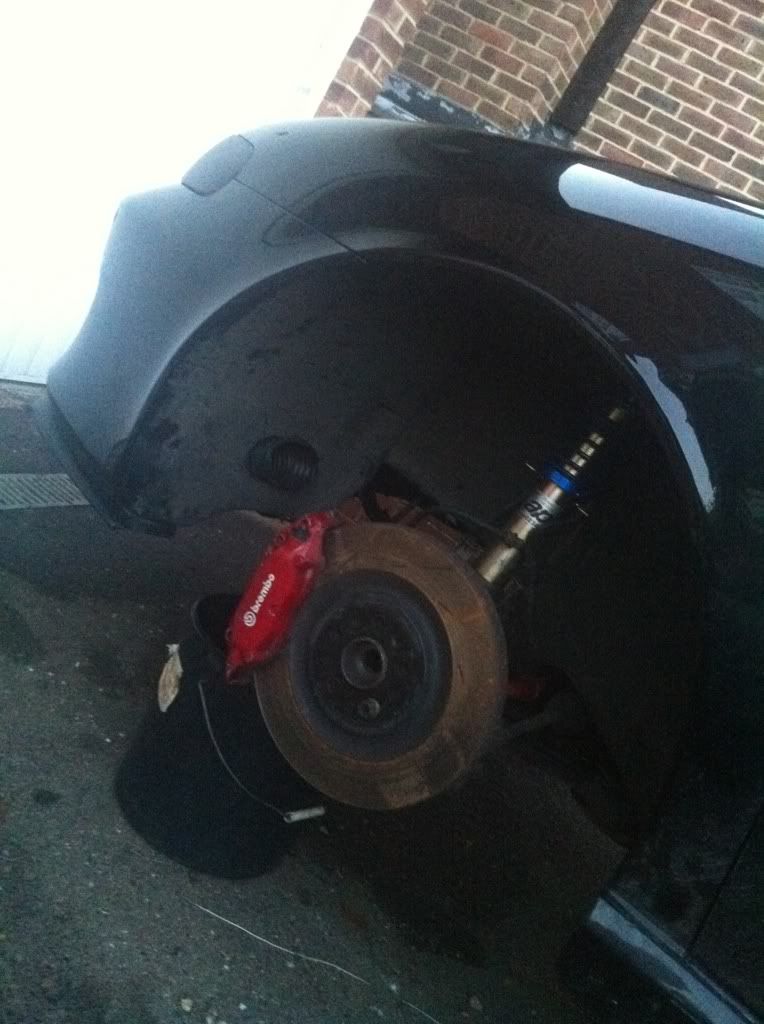

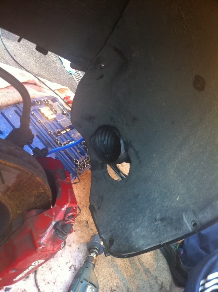

If you look at the mk1 Audi S3 it has slits in the front part of the wheel arch lining. Do the same thing.
I have simple air vents fitted in the lining - right behing the fogs. Sort of what MurderedLCR has but bigger.
