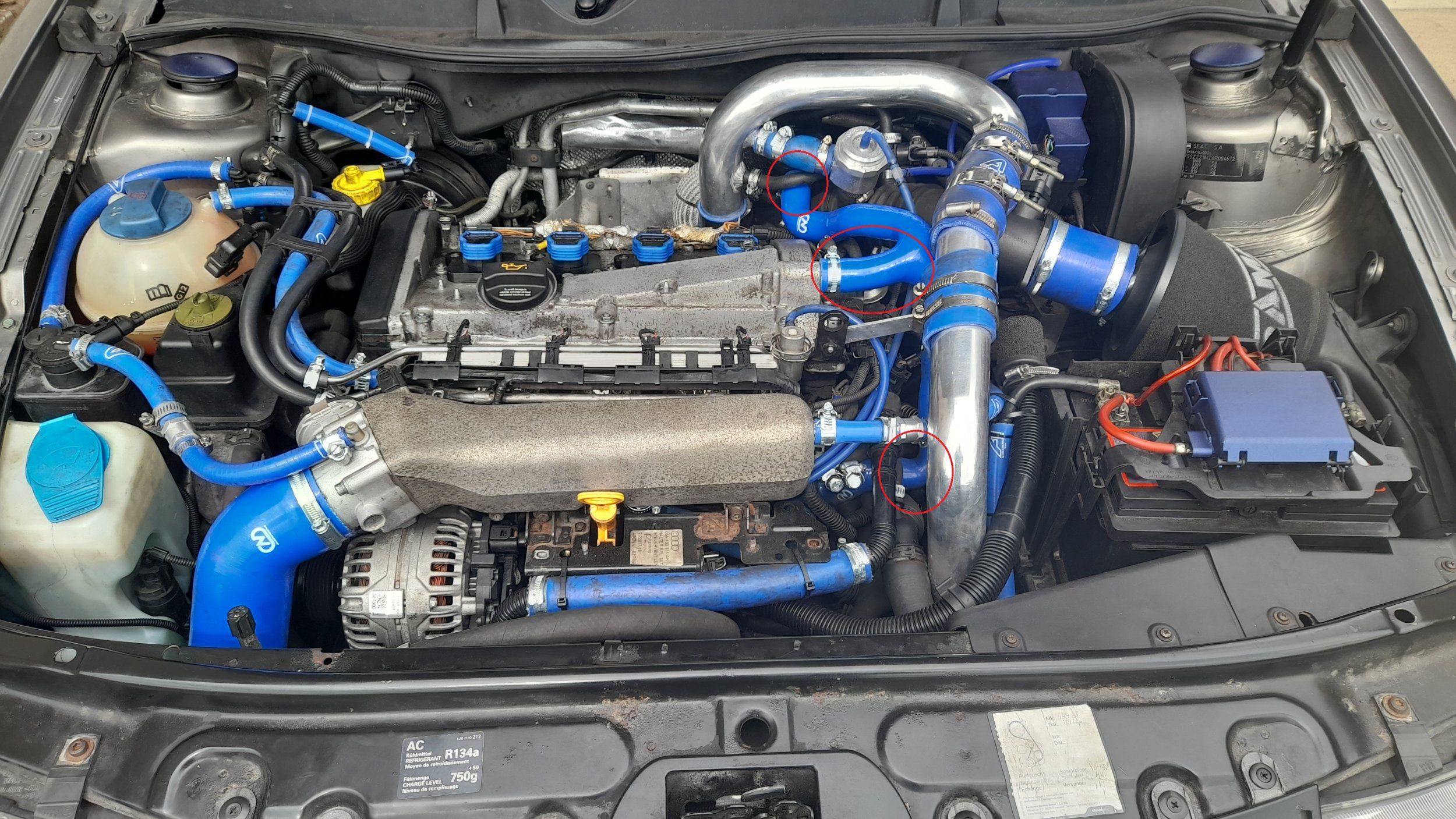

hi guys,
Just added the Y hose for the PCV system but it seems massive, do people trim these up or do they fit better
if using the CM turbo inlet hose? I noticed this with the hose that comes from the check valve too and it was a
struggle to fit because of it, but now with the Y fitted to it as well it all seems quite tight and just looks a bit
oversized.
also added the intercooler to throttlebody hose and it fits fine.
although it looks close with the charge pipe its actually behind that. this picture should be more clear, you can see the top where it connects to the pancake and then to the rocker cover, they seem like they could be cut down a bit, and also when its connected to the pcv hose that comes off the check valve it seems to have kinked it slightly with trying to get them to fit together.
i'll need to whip it all off and have a look see what i can do, i hoped not to have to cut them but i might have to.
I had couple silicon hoses from them all where too short. And apparently they should fit 1.8 BAM.
I have a BAM but did a relative's AUQ pipes a few weeks ago. It's a bit like trying to get a baby through a birth canal, but managed to get it all in without any trimming. Not to say it wouldn't sit better with some cutting.
