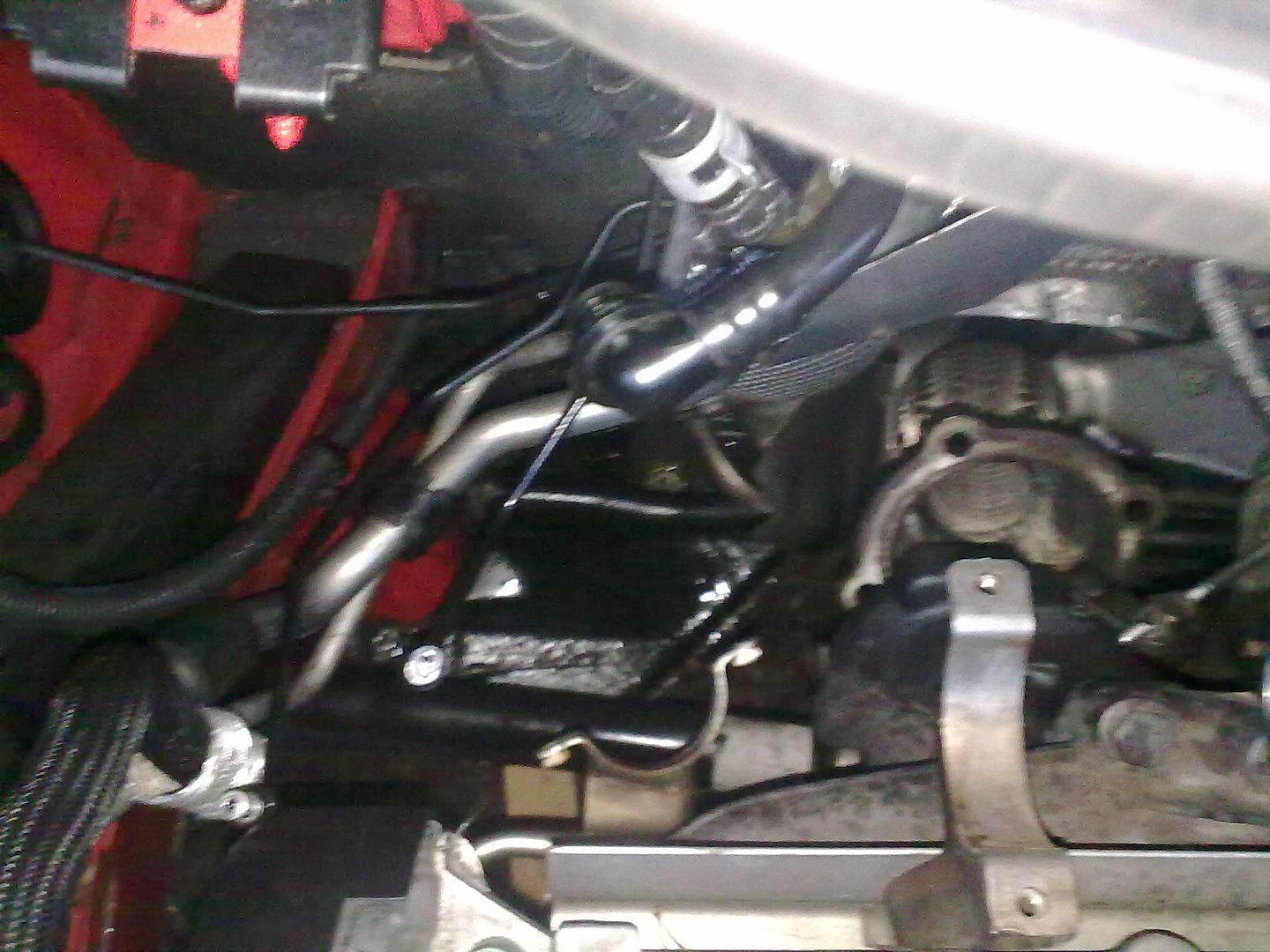

this is on a 1.8t, and it meant disconnecting the engine from the car and dropping it 8-9 inches just to squease it out,
