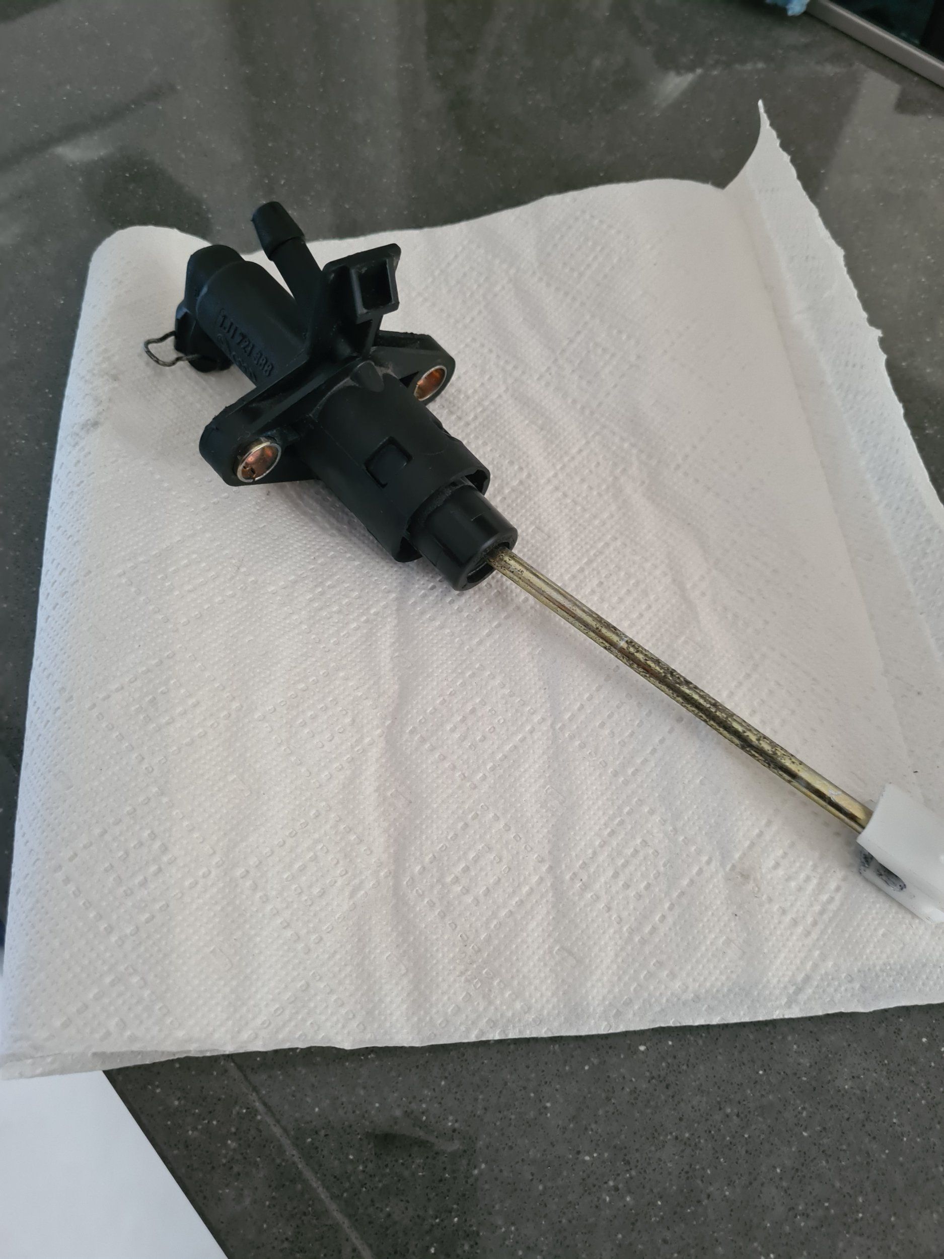

Well i got the master cylinder out, i did notice that it sometimes become stuck on the bottom end when pushing it in now? Or is that because there's no fluid/pressure in it? It was kind of annoying to get it out because of the white clip and the hose from the reservoir to the master because vw decided to use a crimp clamp...
Im trying to put everything back and mostly i had to wait for that white clip that broke where the spring is in.. but can anyone tell me what is wrong now?
It won't even go back up??
See video below
The clip of the master cylinder is completely in, the spring is in, and the master cylinder rod is the same length as the OEM.. all the hoses are back in too (only the top nut for the whole clutch pedal assy is left out for now but that has no impact on this, right?)

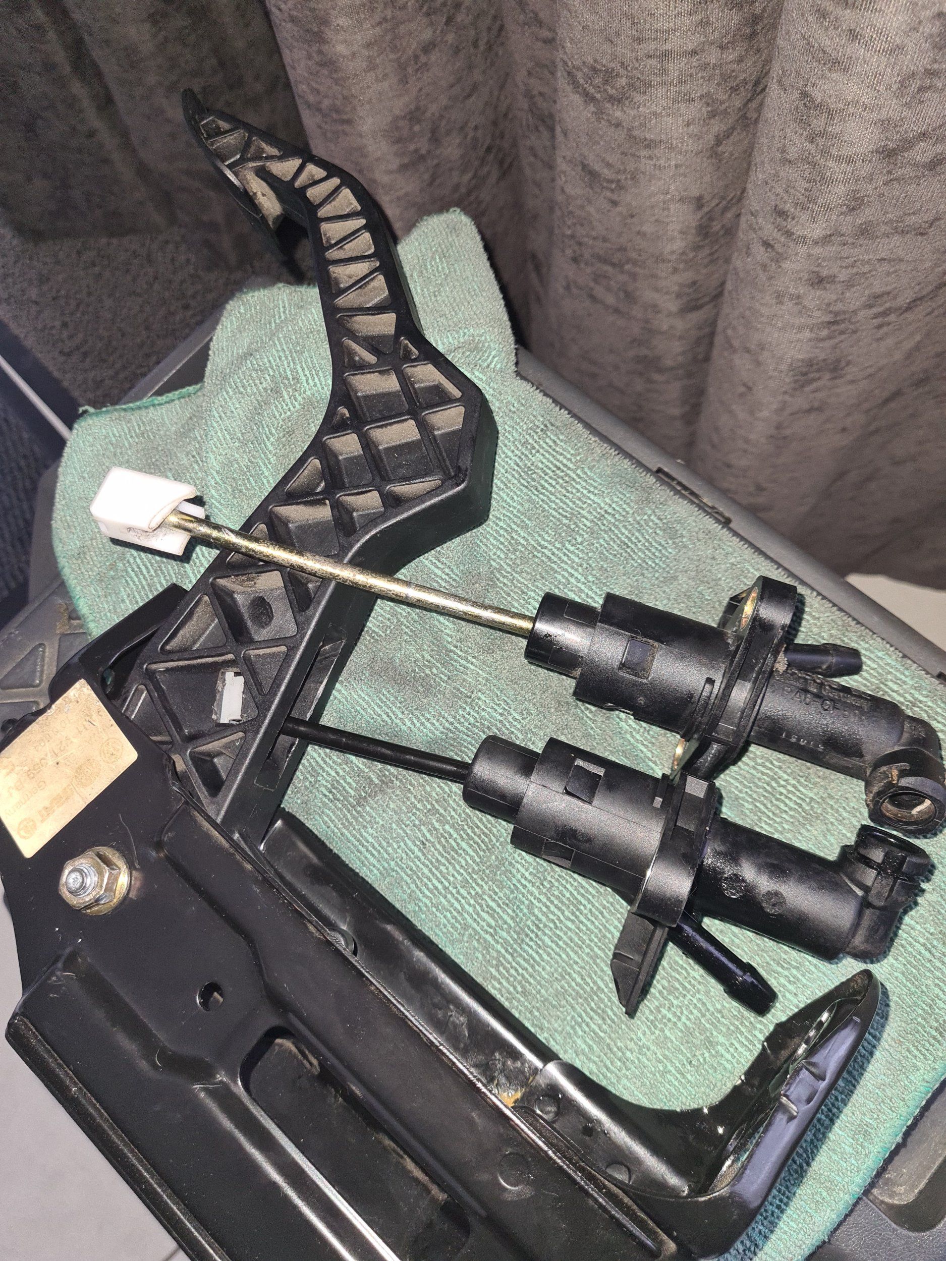

Well, here by i found the issue.
THE SACHS MASTER CYLINDER IS INCORRECT.. ROD TOO SHORT.
Top one, oem one

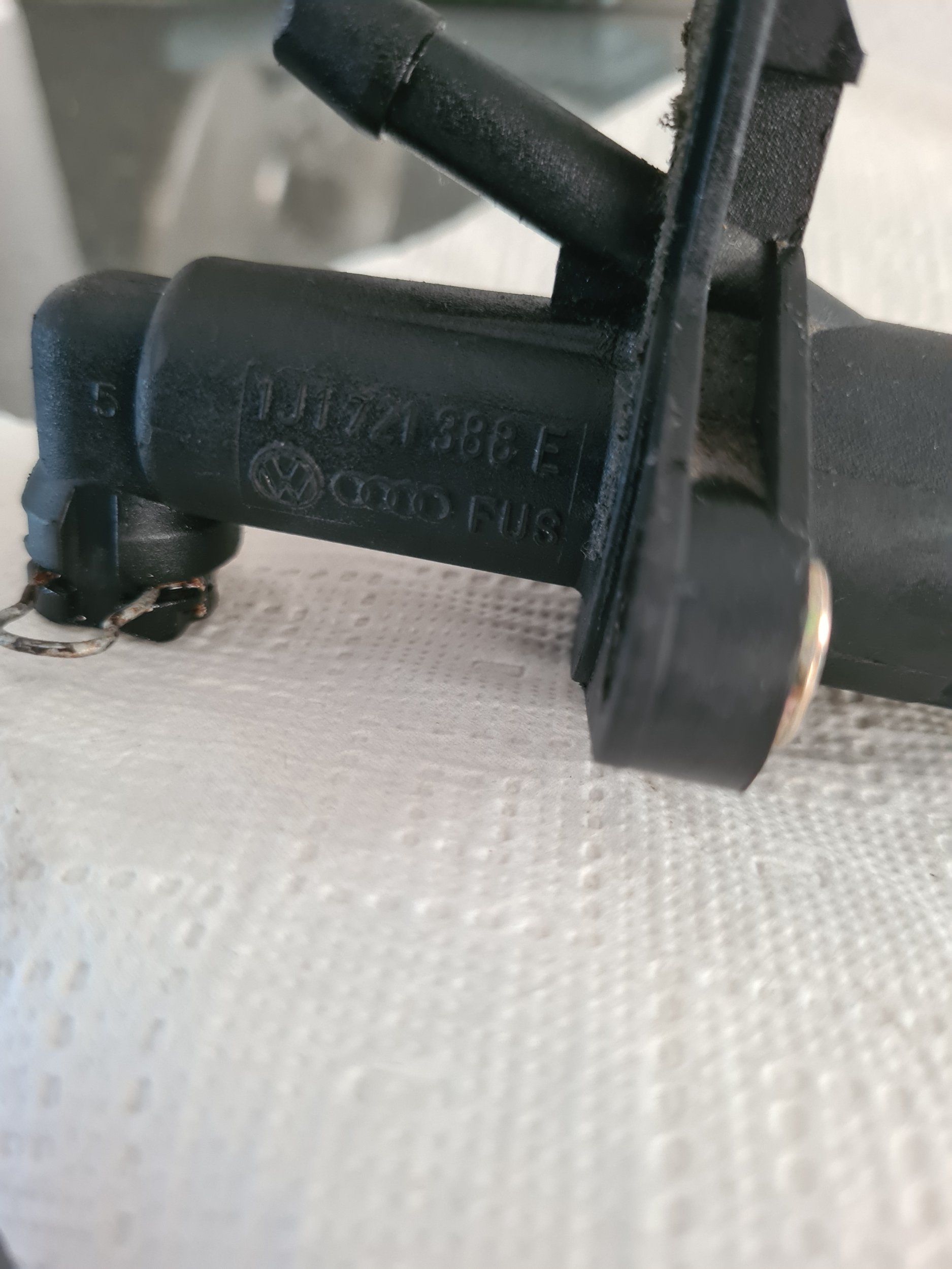

Bottom one, sachs one, same OEM number.
6284 654 007 Sachs is incorrect for 1.8T, but do your measurements first!!!
(Oem was 12cm, the ...007 from sachs is 9.5cm)
Update: i just seen there's also a ....004, im going to kick myself if that was the problem 😩
Hopefully that one will be correct and then i can finally see if it was the master cylinder to begin with
