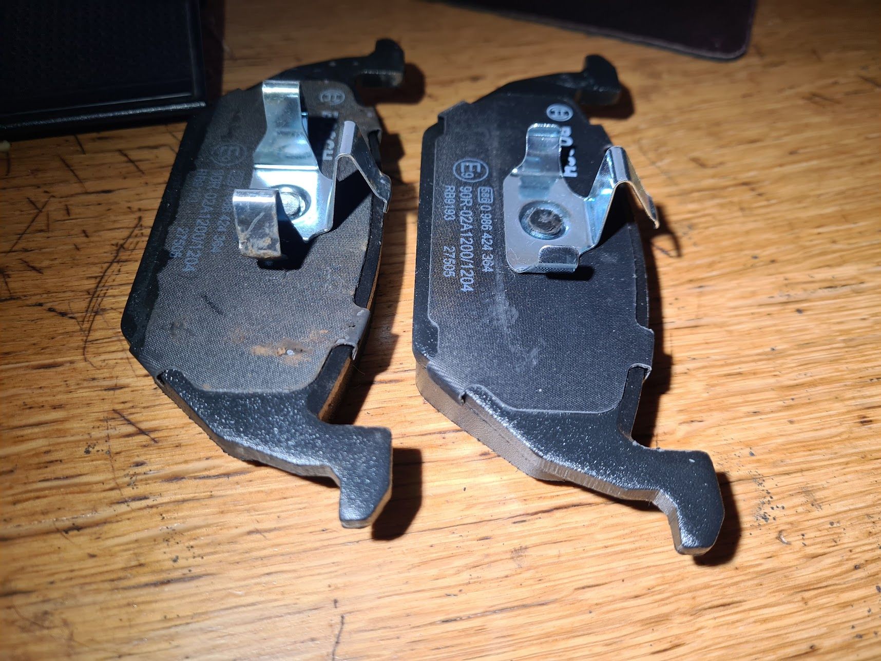

The caliper is FSIII. Rotor 256 mm. I bought Bosch 0 986 424 364 (https://www.autodoc.co.uk/bosch/1161695).

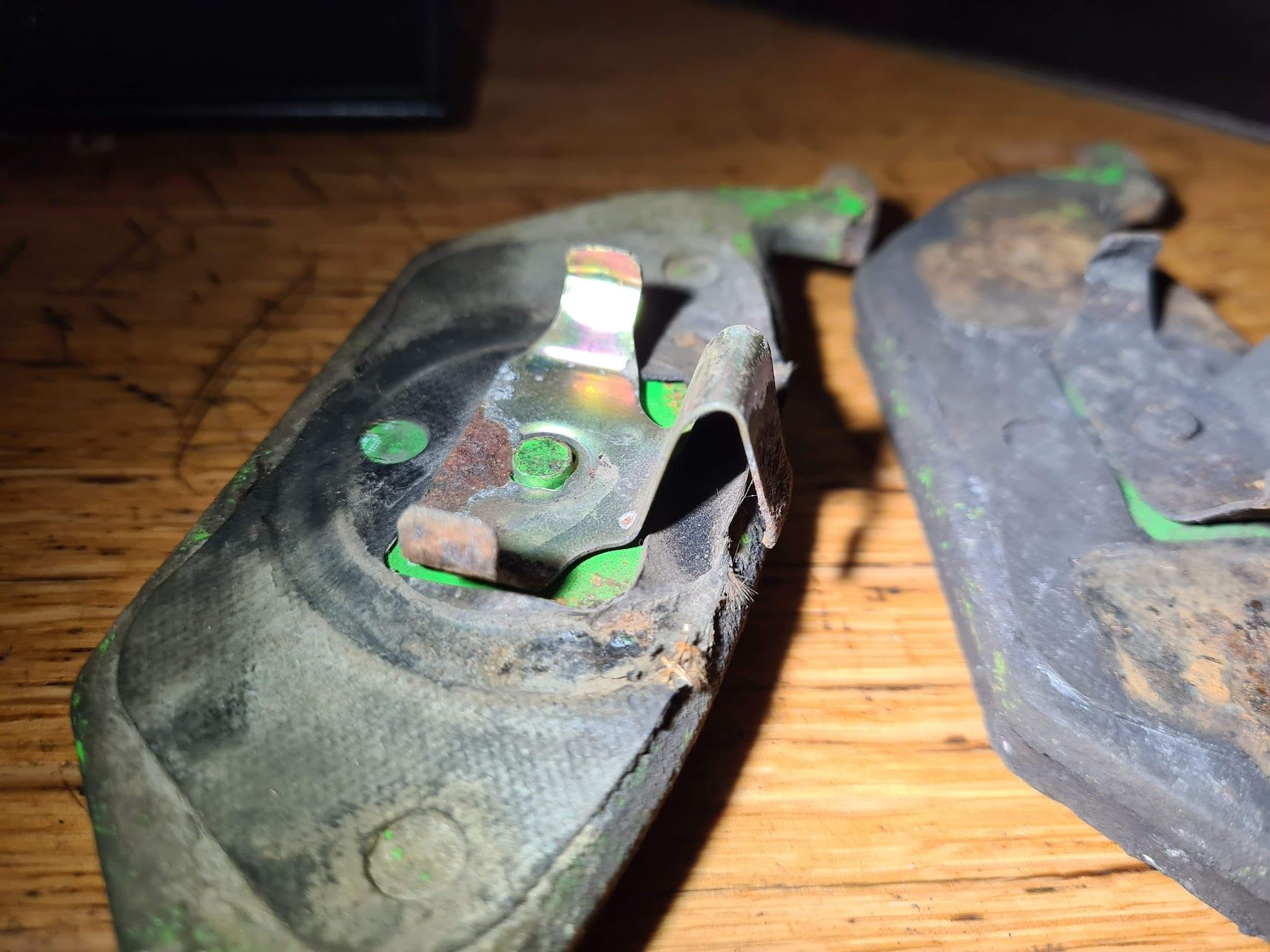

But on the car the piston side pad was not with the "large" clip but a clip very similar if not exactly as the outer pad.

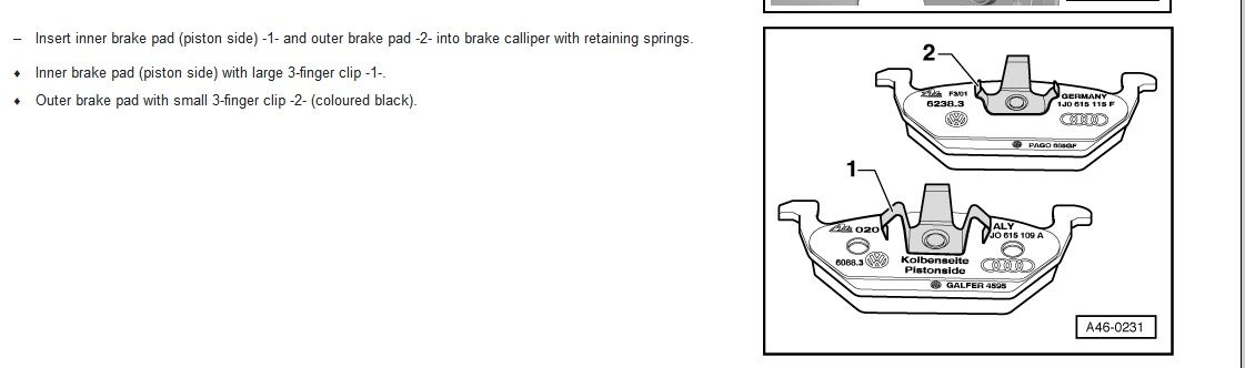

Elsawin says there are 3 types of pads, FSIII, FN3 and AP Racing. As you can see the caliper is FSIII and for that one there should be the pads I bought with one large clip:

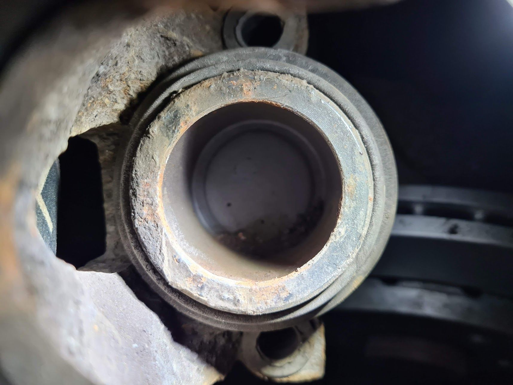

First I thought I ordered the wrong ones but I couldnt then find any set without the large clips. Looking closer the piston side seem to have some unusal wear and also the piston was worn down/corroded towards the front of the car (dont know if that standard for this brake system).
So can it be that the wrong pad was mounted on the piston side or is there some part number that have those pads without large clip? When I suspected something may be wrong I tried mounting the old pad back in the piston and it had horrible fit, very wobbly. Putting in the new pad with large clip the fit was good. The rotor on the inside was also very much more worn than the outside. Didnt think of the fit when I removed the pads in the first place.

Heres the pads I bought.

You are correct, ie these brakes are the FS111 version, the other two options are bigger and much bigger and have different pads.
I wonder if the brakes on the other side of that car also has two identical pads - but type 1s as the side that you have shown the pictures of have two type 2s.

I'd think that any "damage" that you are seeing on the pistons is just due to corrosion.
