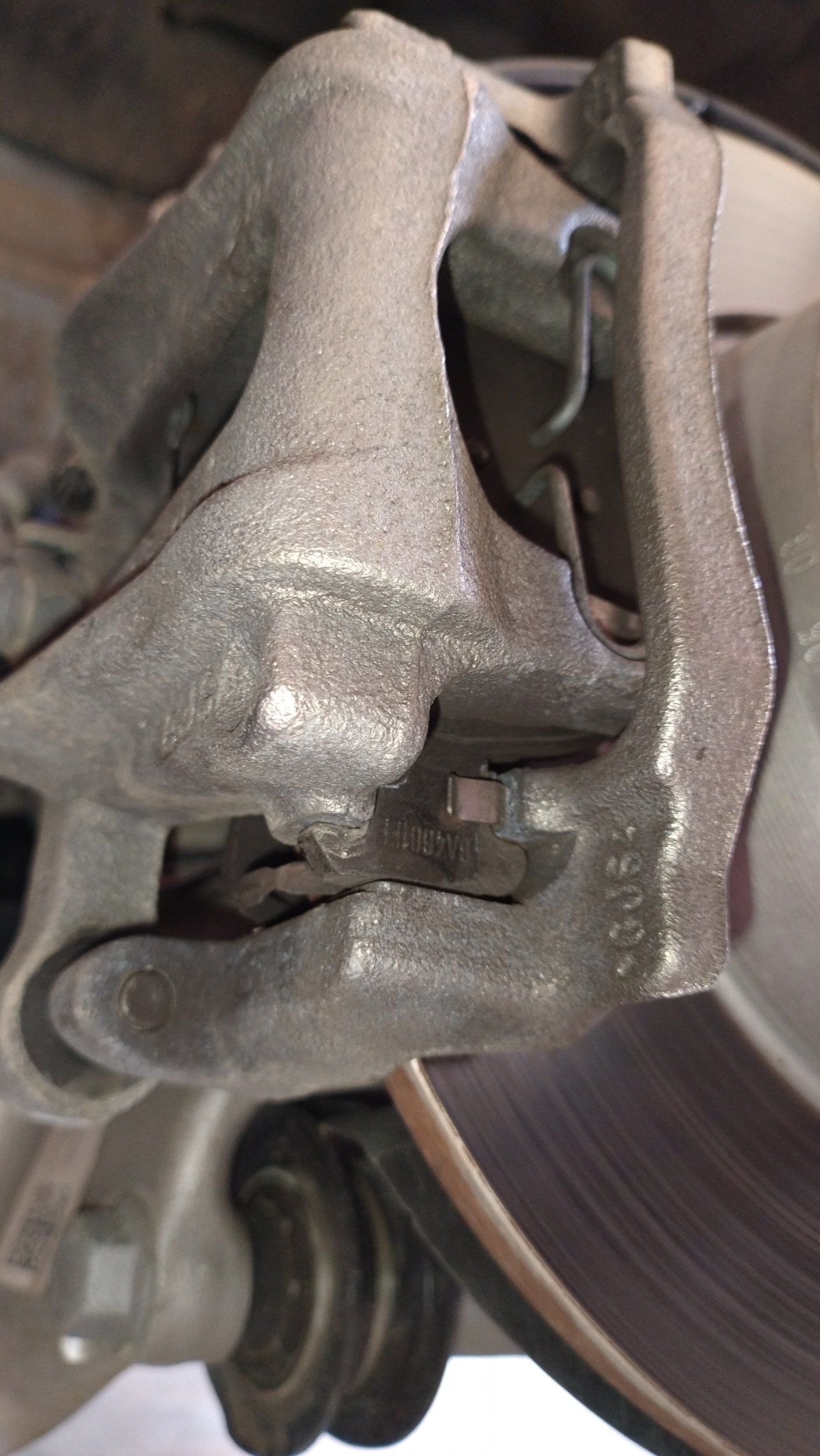

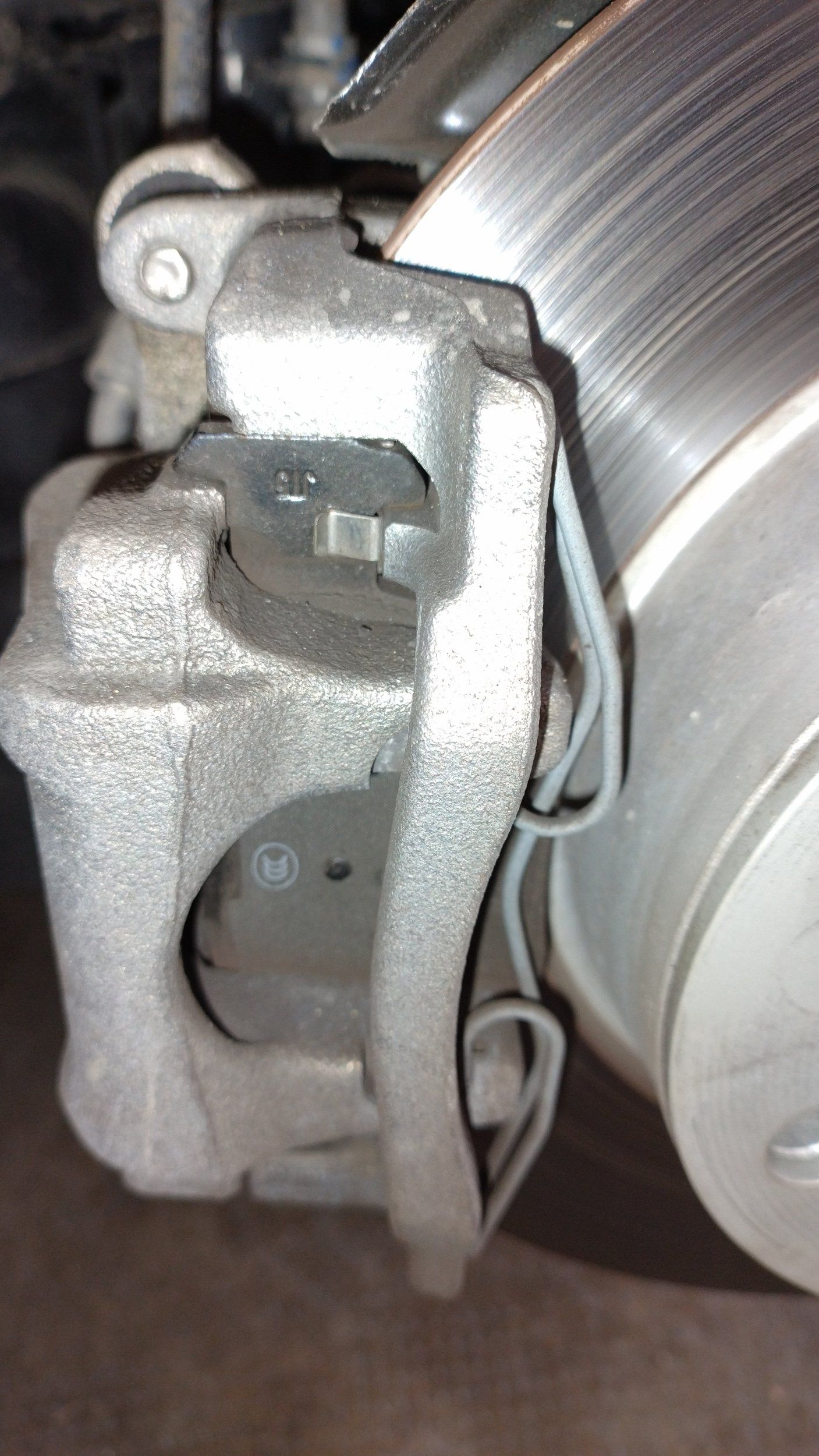

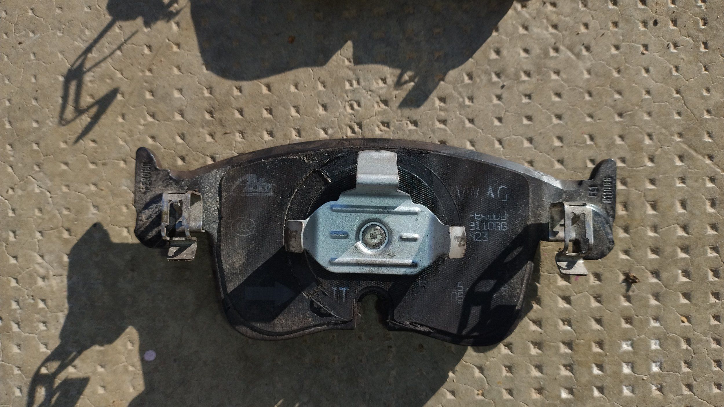

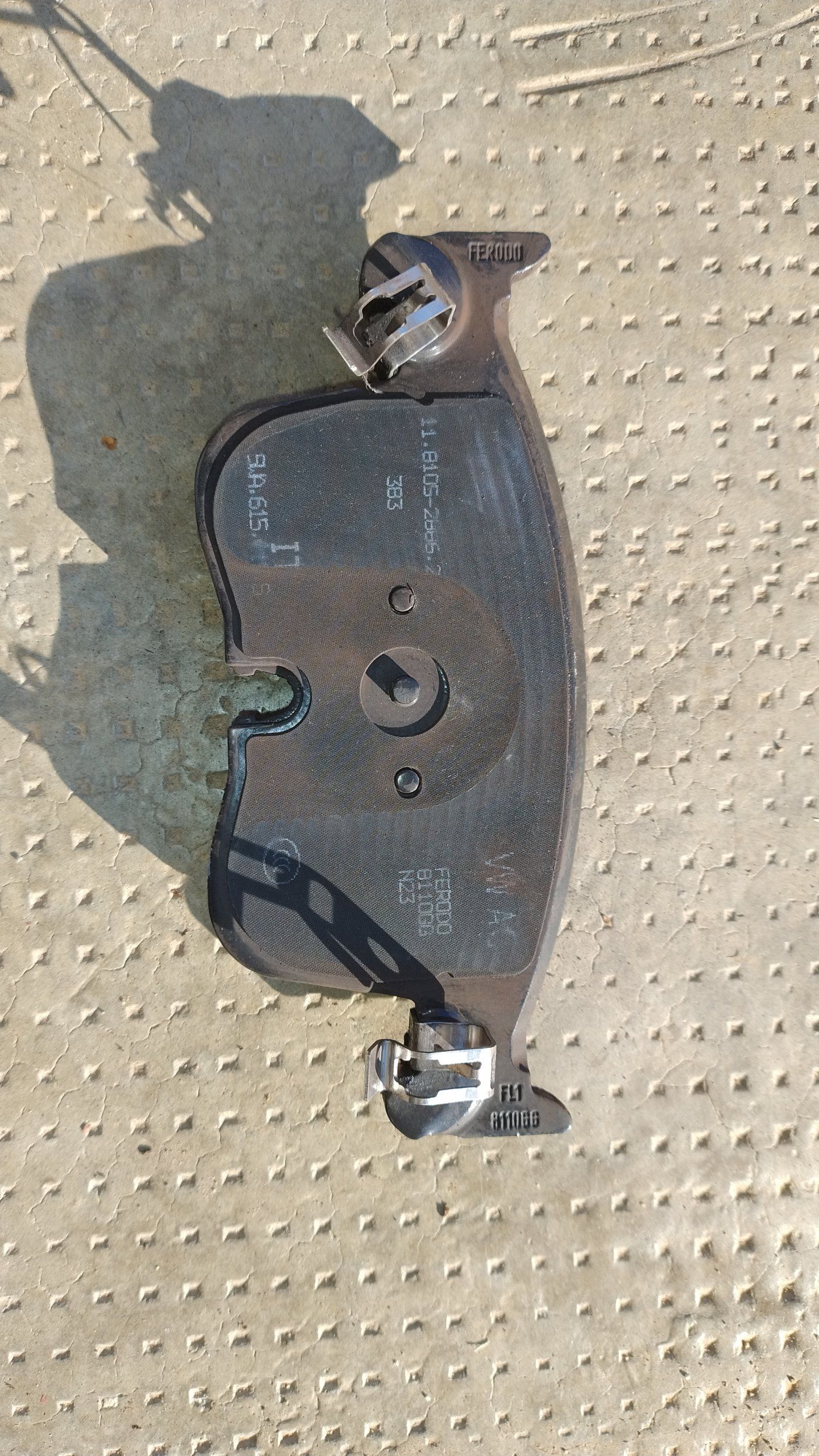

Can someone help me? I can't find the brake pads (anterior) for my car. On auto-doc they don't come out by inserting the model. Is there a complete online catalog of the codes for each Formentor spare part like there is for BMW?
I am attaching pictures of the brake pads, a link...somewhere must buy them...anything is welcome.

This OE number 5WA698151T is very new - and I can't see any aftermarket version yet.
5WA698151N is very similar with different shim and no wear indicator which may work for you? There are aftermarket versions available.

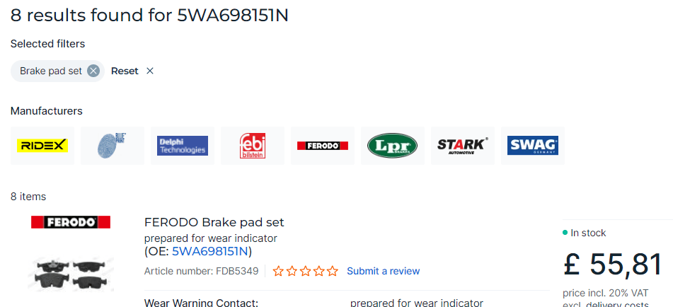

8 aftermarket suppliers in autodoc link to that OE number!

THANK YOU! I only put 5WA698151N without "OEN" :banghead2

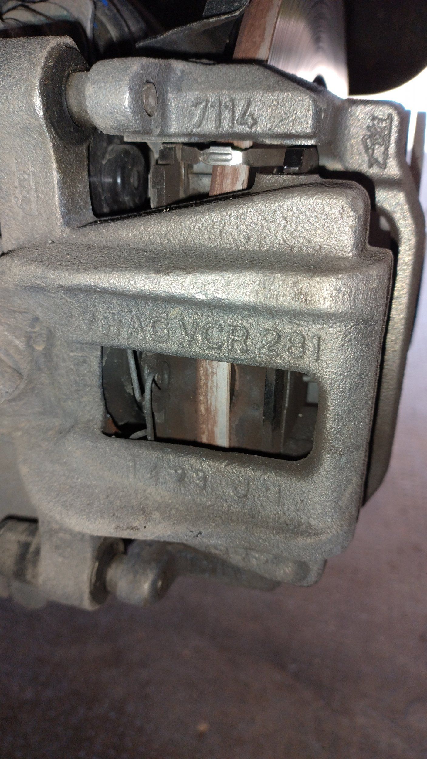

Just share a photo of the pad/caliper through your wheel and I might be able to identify.

looks like:
Rear pads: 5WA698451G
drag reduction springs: 5WA698269B
caliper spring: 5WA615269
272x10 Rear discs: 5Q0615601D
Your rear brakes are hardly worn -
