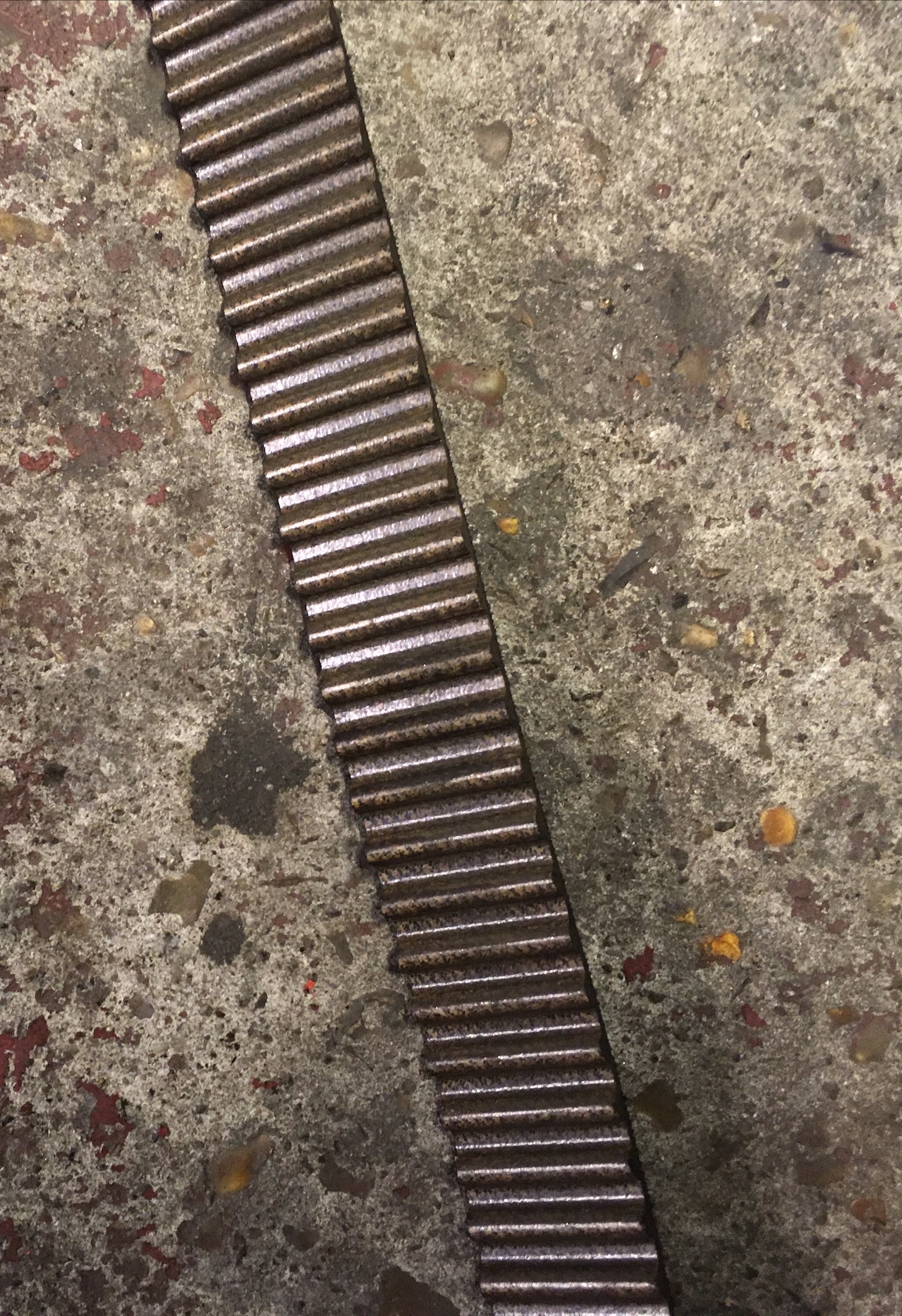

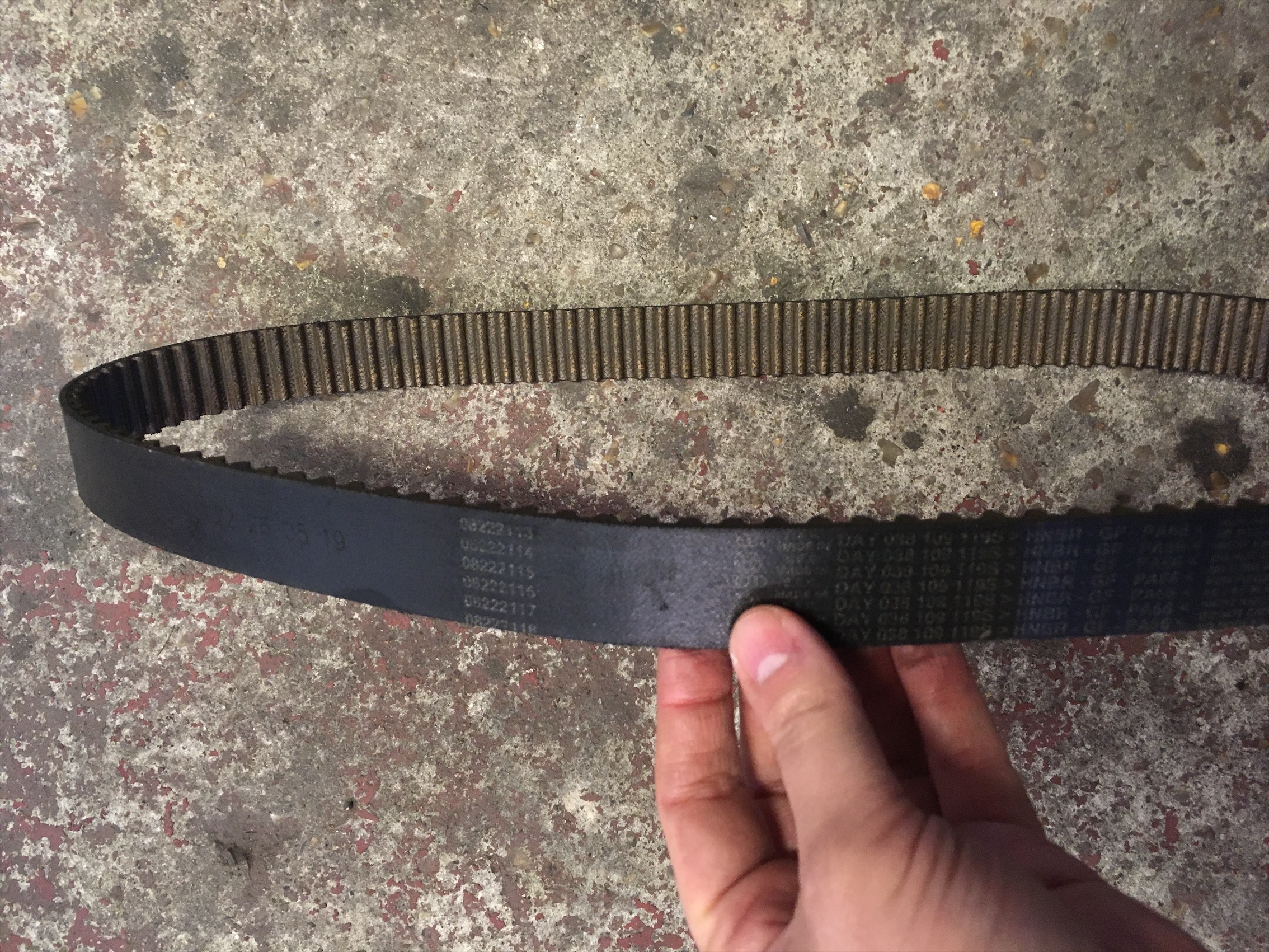

Cambelt duration on my wife's R56 Mini is 10 years 140k miles! I changed it at 90k 6 years old. Waterpump was leaking and causing damage to the belt so I would never go by manufacturer, it doesn't take much to remove the cover and look at the condition of things
