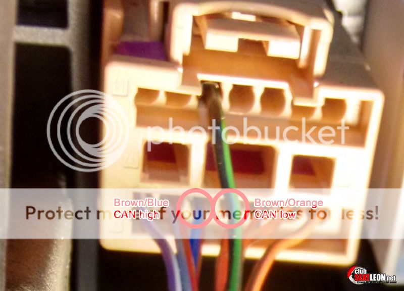

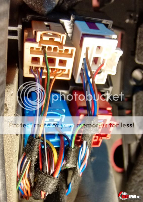

Hello, was just wondering how could anyone access the Body Control Module under the steering wheel to solder wires to the pins of the CAN gateway? As the wires are in a very tight place and very short, so is there another way to connect to CAN HI and CAN LO ?
Not sure, because the instructions for the OPS only states the pin number 7 and 17 on the Body Control Module under the steering wheel.. but I may try connecting it to the OBD diagnostic pins and see how it goes..
