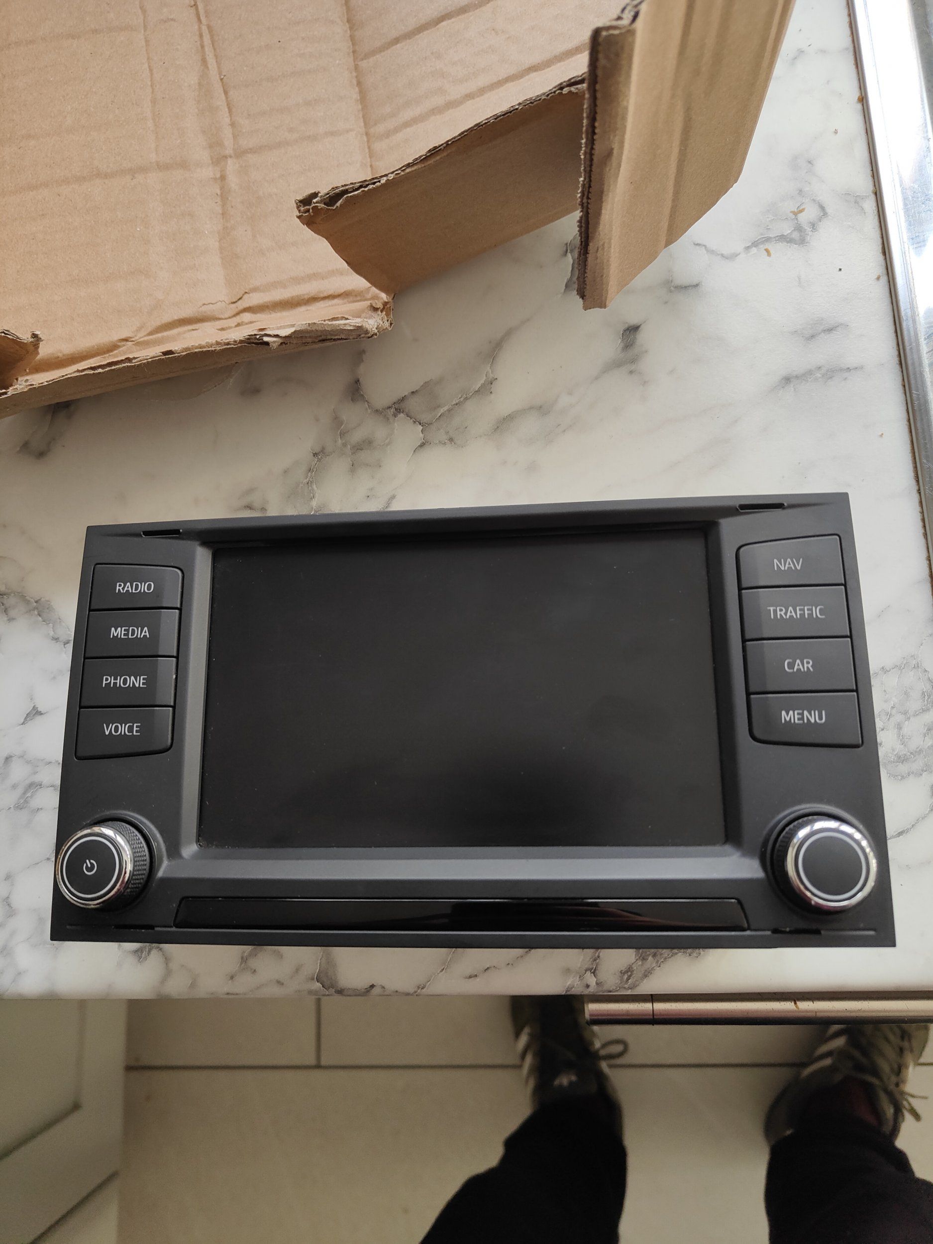

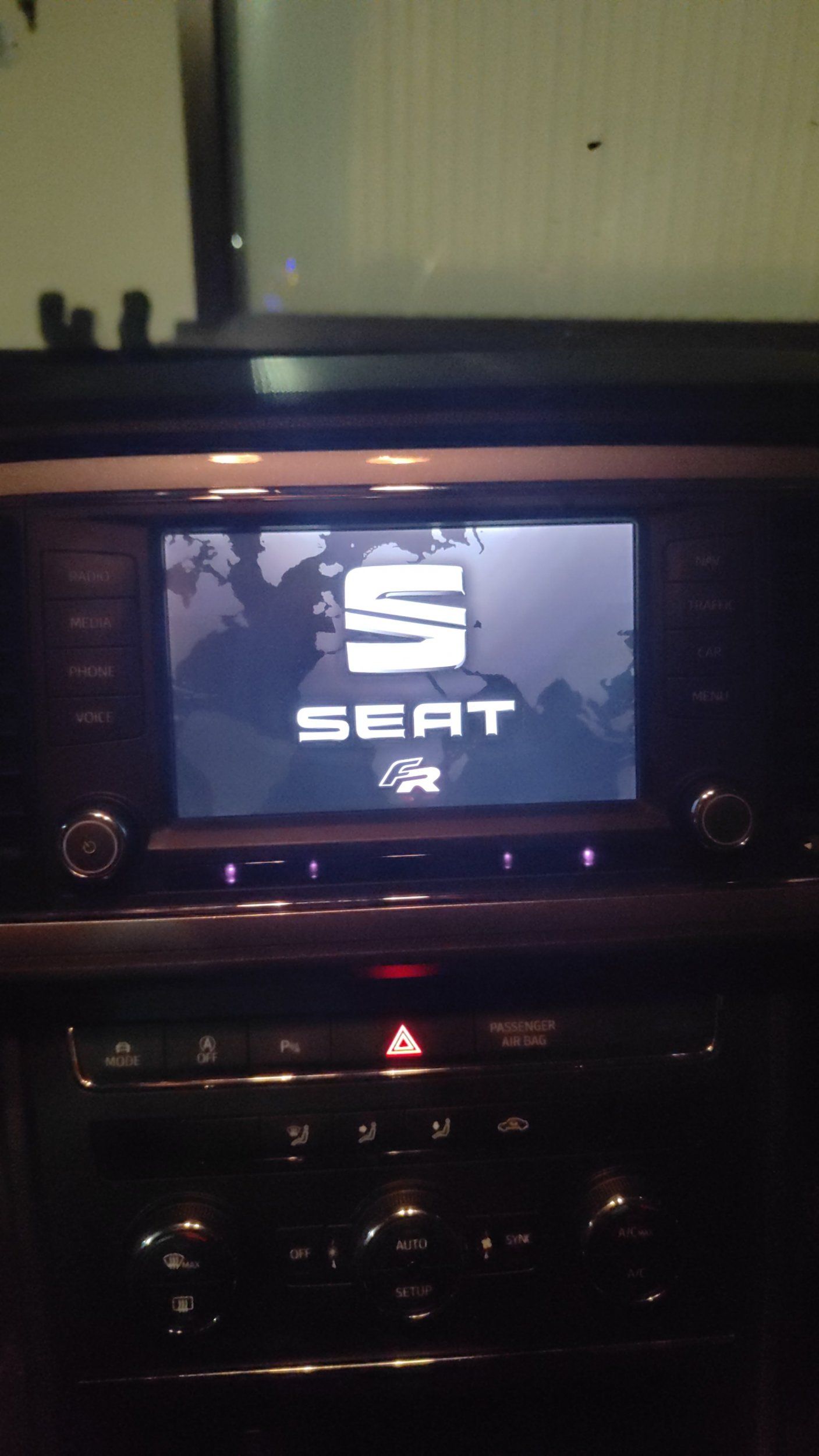

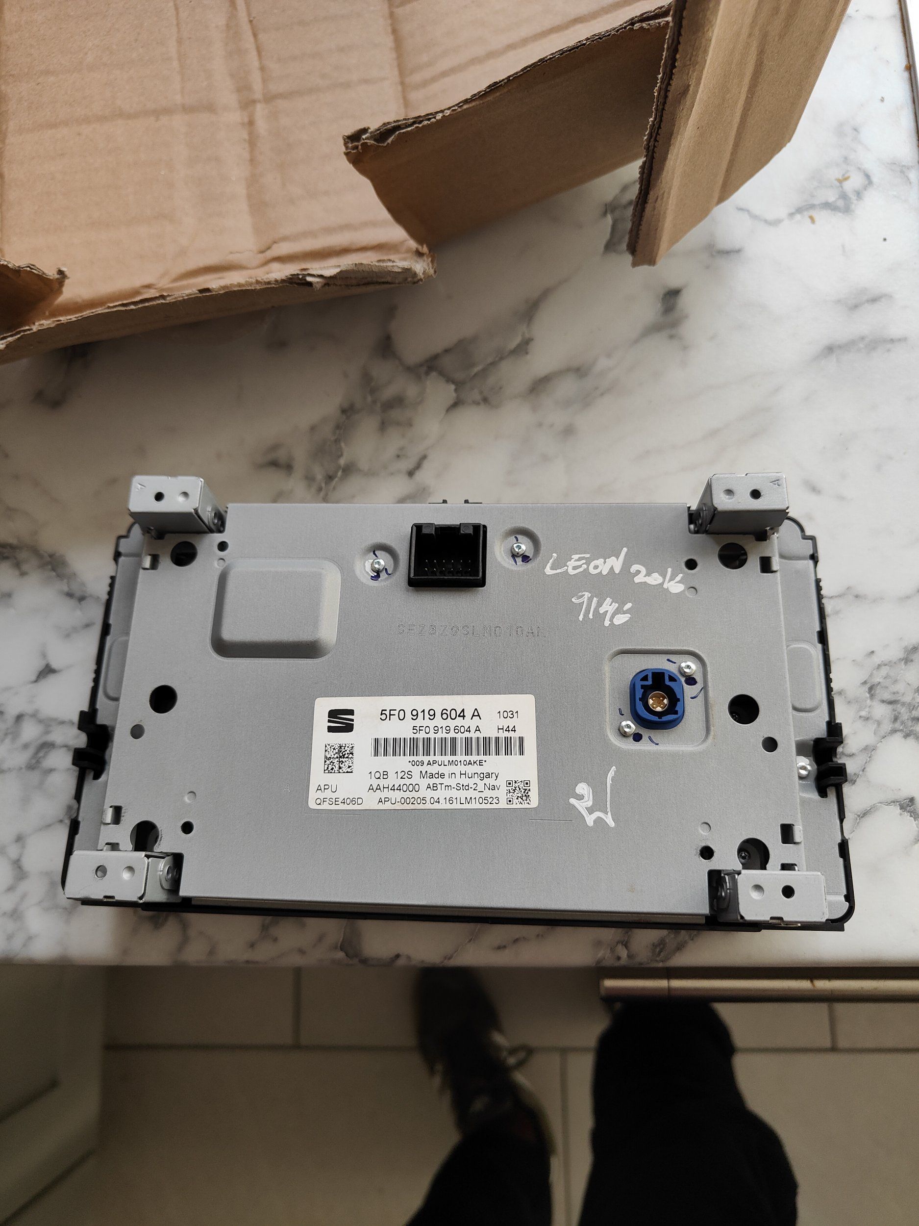

Ok that is fair enough I ended up getting a replacement one the same model as the one that is frozen and when I put it in to my surprise it done the same thing froze I'm not really sure what to do now does the radio need changing is thats what effecting the screen I've no clue thanks

Have you tried a soft reset? Press the power button until the system reboots. Also has anyone tried coding recently? I had similar problem when I tried to code in a different look to the screen and it froze.

I've taking it to seat the quoted me £1800 full replacement I'm going to buy another radio unit of eBay hopefully that solves the problem as it's clearly not the screen. Thanks

How is your unit freezing up? Does it boot up at all?
Do you have a SatNav SD card installed? Have you tried ejecting the card and seeing if the unit then boots up? We had a similar problem, where it would boot up for about 15s before the screen would freeze. But we worked out that, if the Nav card was ejected, the unit would remain "usable" (we've got other issues going on though with the screen!).

On your rebooting system freezing we had an incident playing media. The jpeg embedded image in the flac file... Will be the same for mp3 was above 512×512. Caused the infotainment system to crash. I posted that up.
The solution was to remove all the embedded jpeg files. It got me worried when it happened. Was it the navigation SD card... thought it was. The 5f unit breaking down... No. Lousy image in the music file being played. Basically the program was taking a wander out of memory and crashing. Lousy program design.
