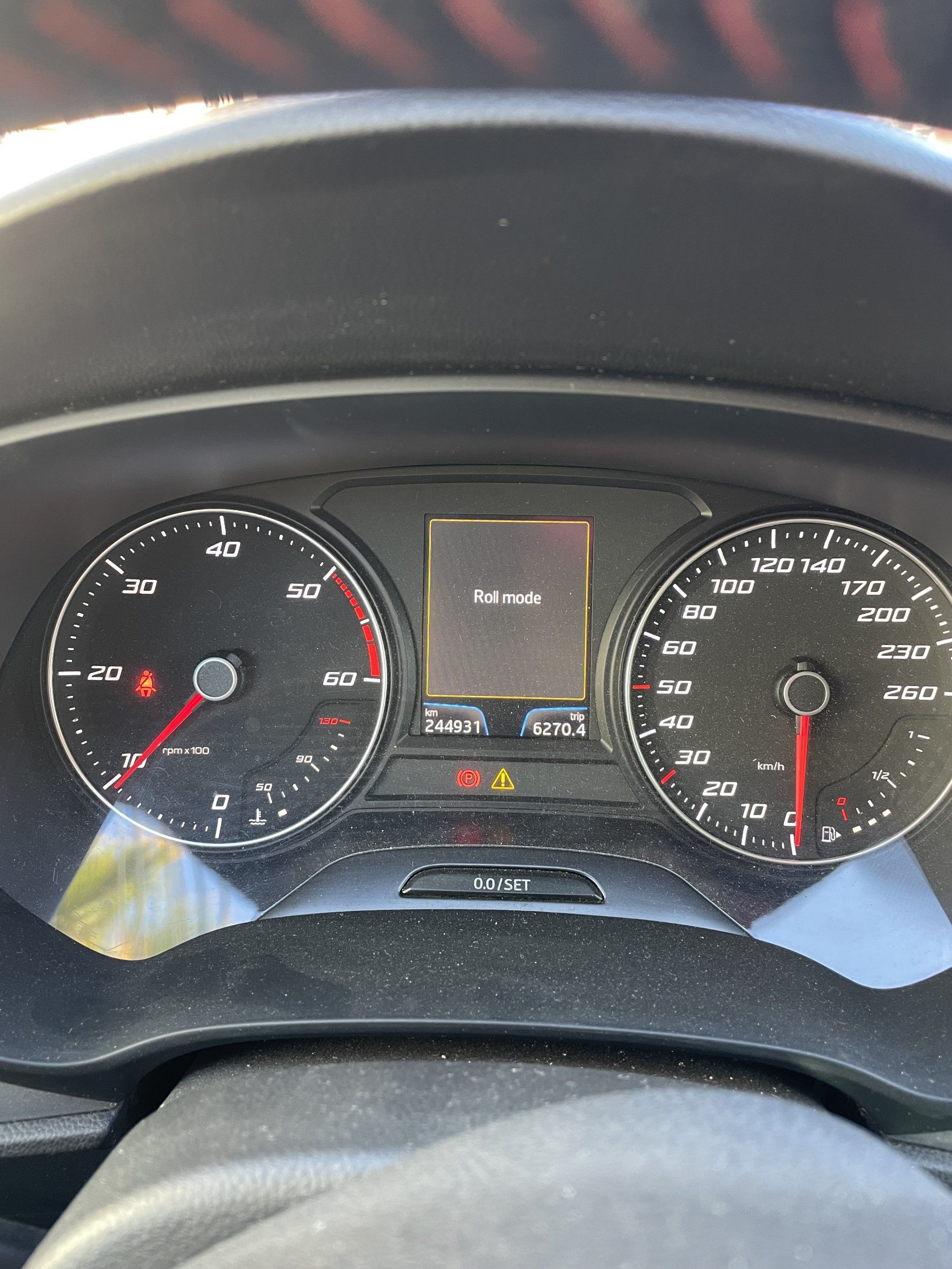

I assume facelift model? have you been to the brake test station recently?
otherwise with a diagnostic tool: STG 03 then basic setting then deactivate roller test bench mode.
that would come to mind
Reactions: TheSwede
Noup. It appears after using vcds for disabling the start stop system.
Enabled back but this warning is still there
