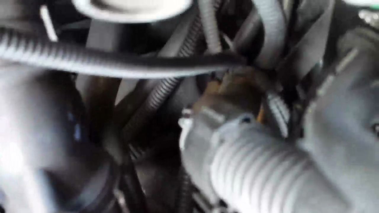

Dont make the mistake I made though of thinking the sensor is the one at the front, next to throttle body as seen in pic -
Its actually behind the TB out of view, that's the one you want
Cheers chap . I'll have a look tomorrow . World stops when top gear is on ;-)
