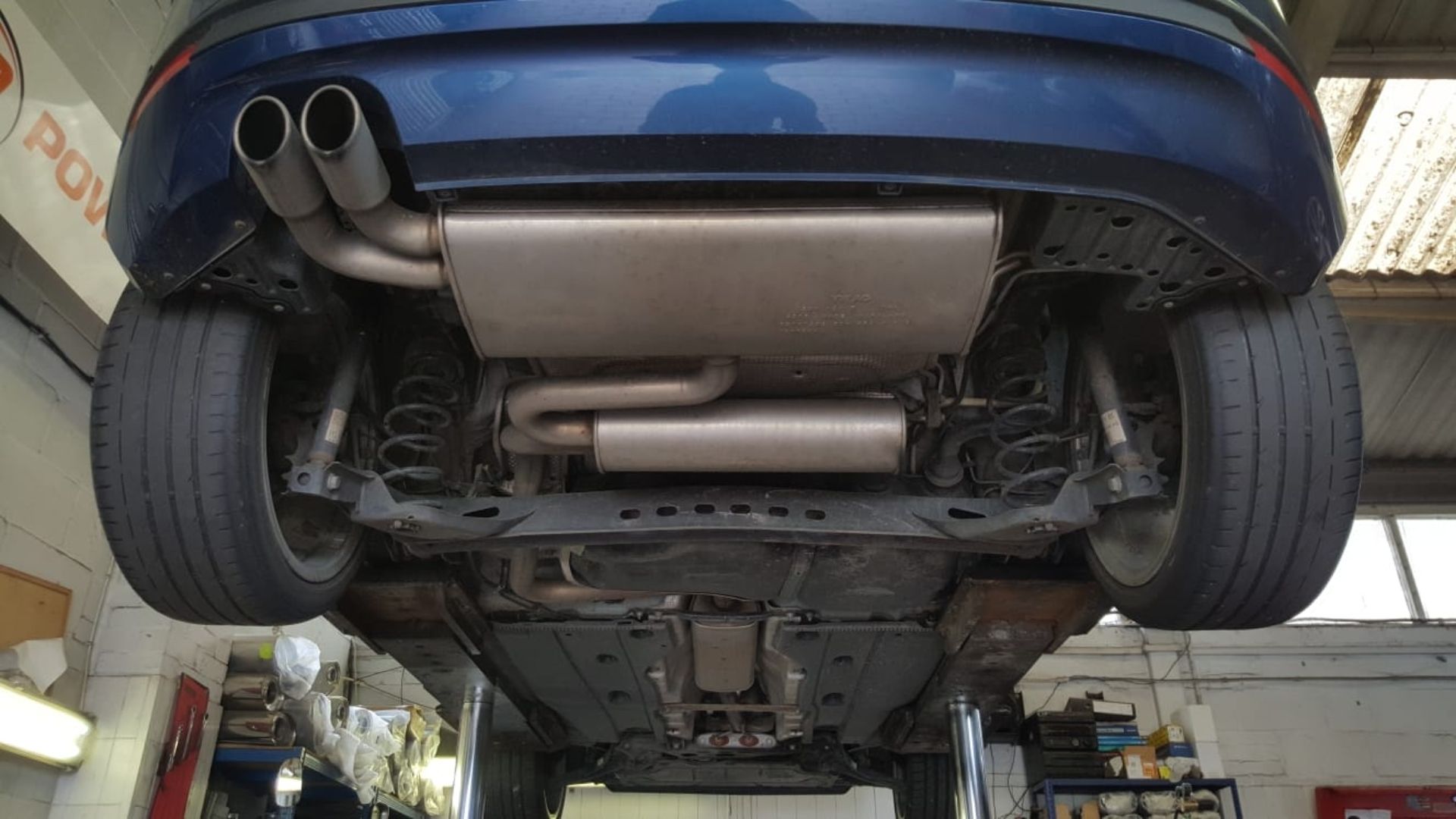

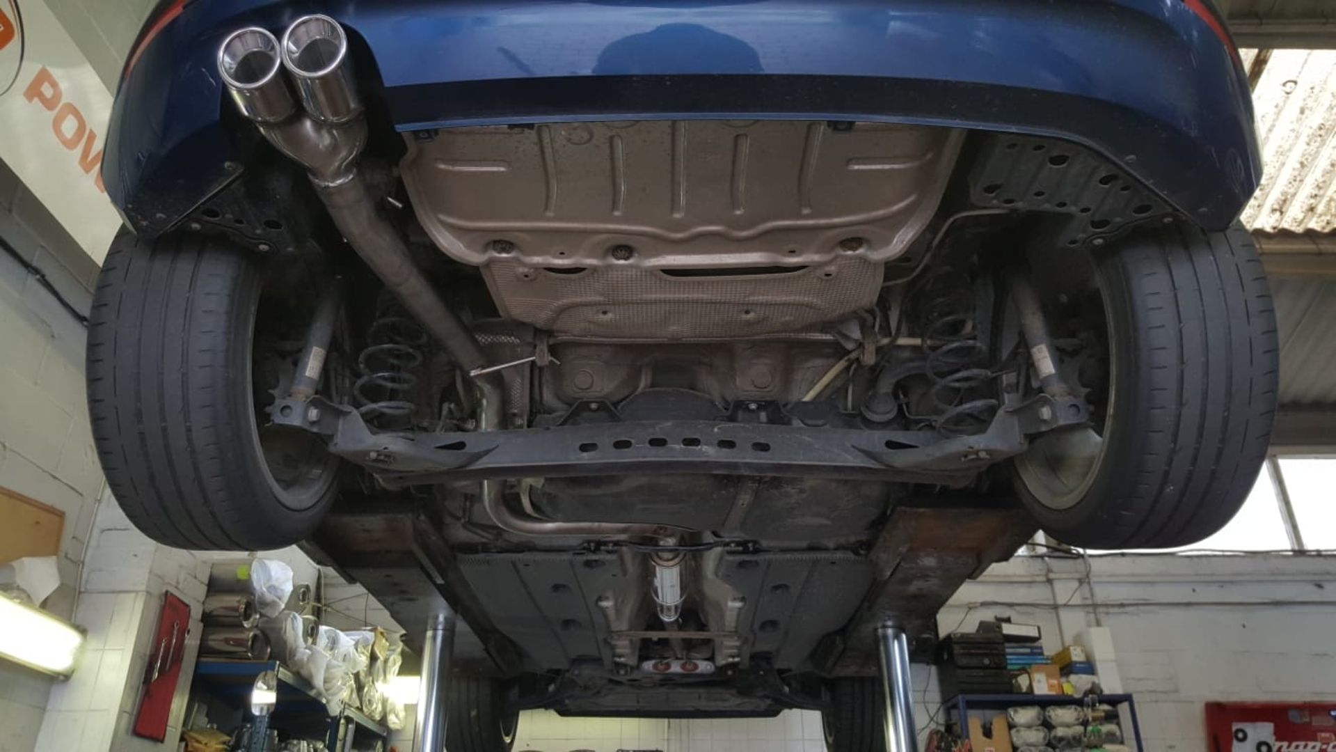

Hi guys,
Had a custom cat-back done on my Leon on Monday (see images below).
From the outside the car sounds great and not too loud, but from the inside it's horrendously noisy to the point where l change gears at 2,000rpm just to keep it down.
I'm taking it back for the garage to remedy (they have been awesome I would just like to say), but l was wondering if it has anything to do with the box being in the middle rather than at the back?
Would a bigger box at the back (with no box in the middle) make it quieter inside?
Also, cruising at 80mph on the motorway it settles down to just sounding like a continuous loud wet fart inside the car (hopefully it doesn't sound like it from the outside).
Any help would be much appreciated.

You don't have a box (muffler) on the new exhaust system you have a resonator, the resonator will not make it quieter it just takes away the horrible droning at tick over and motorway speeds. You need to add a box (muffler) at the back and that will help with the noise level. Keep the resonator as well.

It dont need the resonator it just is supposed to help with the droning. Ignorance forgiven lol
If you look inside a resonator they aren't really restrictive.
You could have just 1 muffler at the back.
What made you go for that exhaust system.

This is what youve got. You have a cat back straight through exhaust with a resonator in the middle. You need a backbox to make the car sound nice and not to loud. The resonator is in the middle this is what help with drone at motorway speeds and idle.
Normal pre-fab cat back exhausts you buy are resonated or non-resonated.
Resonated generally don't sound much louder than stock at normal rpm but just gives a different tone, but when you go WOT it will sound loud.
Non-res will stay louder all the time.
But like said above they both have backbox/mufflers right behind the tips, its strange they didn't put one in unless you requested not to have it.

So what I'm thinking now is that I'm going to get the mid box removed and fit a small back box to reduce the noise as the fitter said that a box at the back would make it incredibly quiet with the res in... what are people's thoughts?

Yes. Why didn't you go that way to begin with? You have no silencer (back box) at the moment, no wonder it's loud, might as well of just taken the exhaust off at the manifold and ran without one :ROFLMAO:

I dont know what fitter your using but a muffler at the back will not make it incredibly quiet, it will make it quieter but not incredibly quiet, unless you use a giant muffler lol.
Also the resonator in the middle doesn't make it quiet it is there to stop the drone not the noise of the exhaust.
You should keep the resonator when you take it off just incase you want to put it back.

How reputable is this guy? He seems to be able to make exhausts but what he is telling you is strange. Exhausts come with a muffler whether it is resonated or not.
If you don't mind motorway or constant speed drone and you want a louder noise all the time, take the resonator out. Otherwise leave it in.
Look at Scorpion/Remus/Cobra they all have mufflers.
