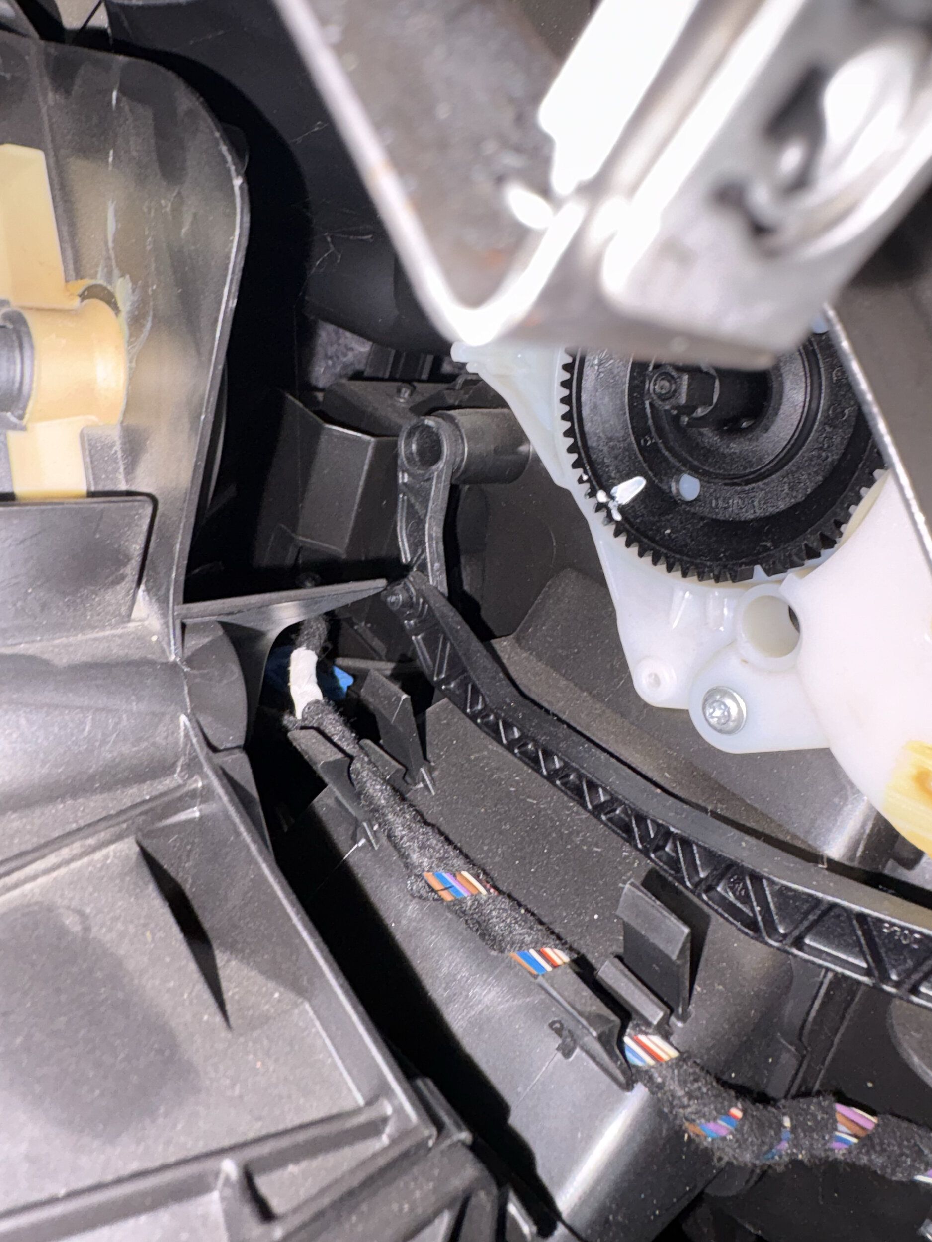

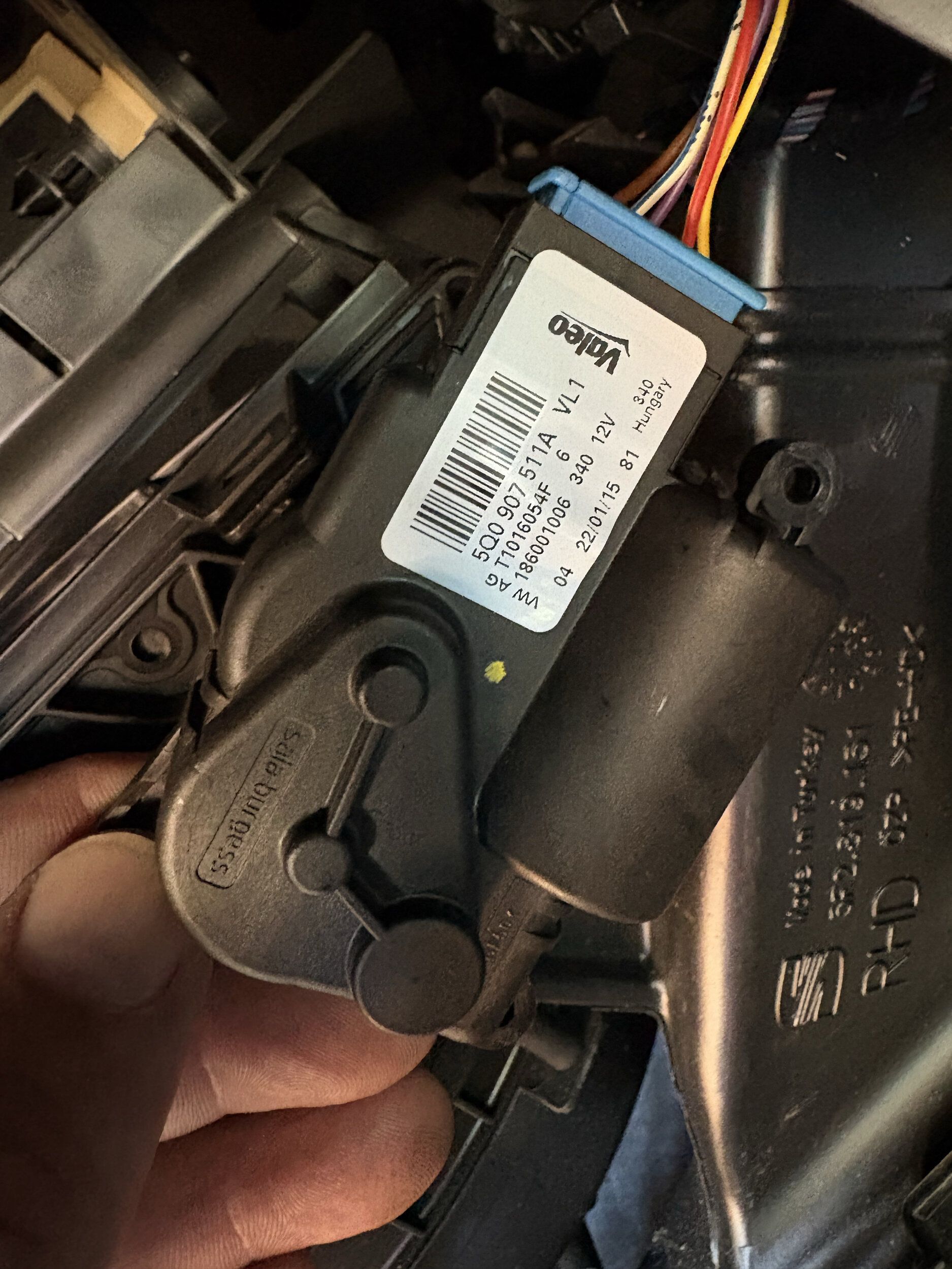

I’ve now managed to resolve this. Found a video on YouTube which was simple enough. You need to remove the whole glovebox where the attached photo is located with 2 screws and the blue wiring plug. I have removed this and can operate the vents manually by hand. When I operate the vents using the dash switches, this small motor doesn’t move. I opened it and it appears that a small cog has snapped off hence why it’s not working so I need to replace the small actuator motor
Reactions: SuperV8
Absolute nightmare fitting the new switch and nightmare getting the glovebox back in BUT all sorted now and back to getting air through my central vents
