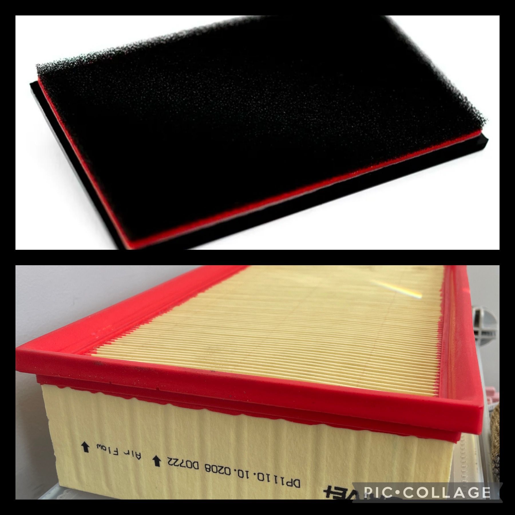

Look at the corners of that open-cell foam. You can see daylight through it! That's going to stop big bits of debris and nothing else. No way I'd put that in my car.

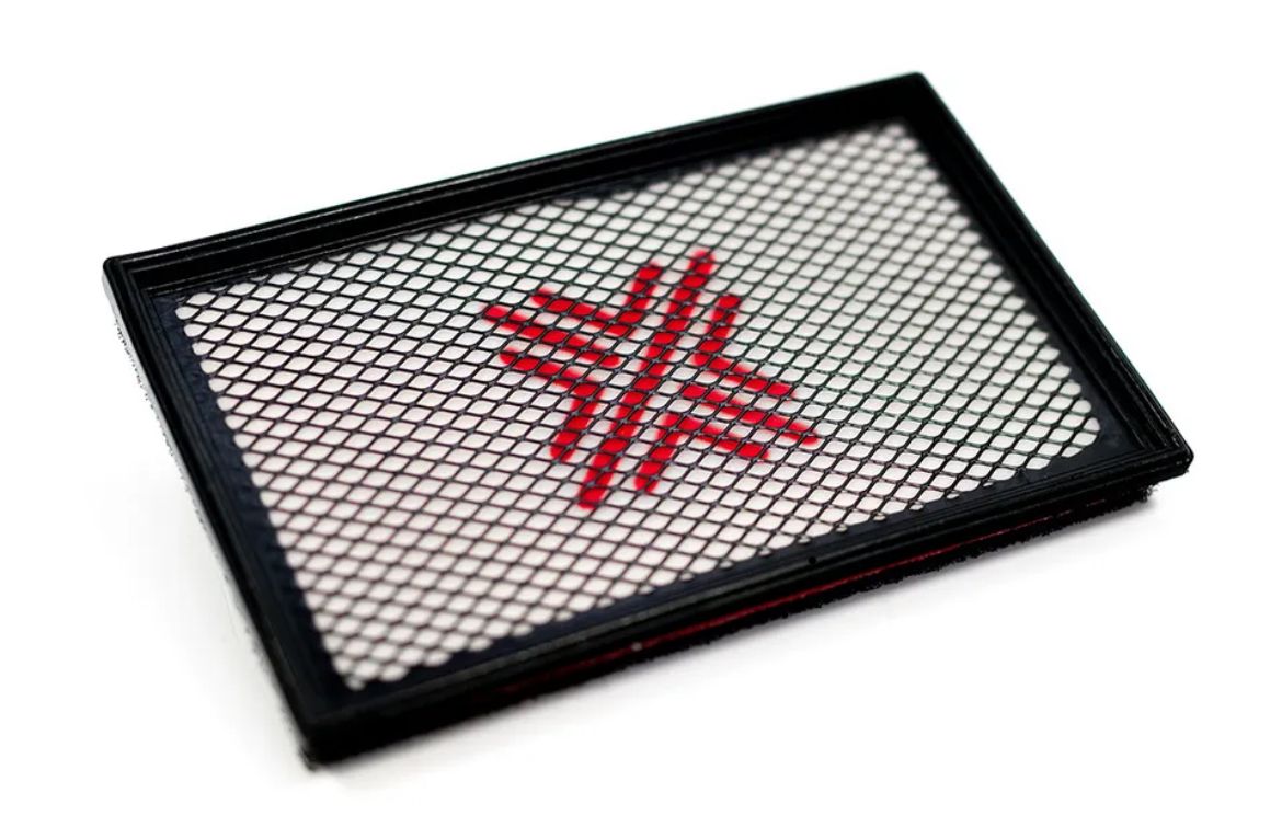

This is the top with the seal, the other pic was underneath
That still looks much worse than a stock filter. The Stock one is pleated and this is just a flat panel so the stock filter has a massively larger surface area. That's how you get a good volume of air through it but still have good filtration. The only way a flat filter like that could possibly achieve even similar airflow would be much poorer filtration. Looks like a complete waste of time to me.
