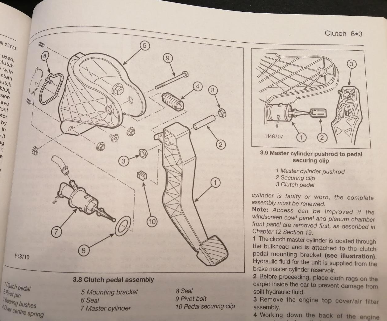

Hi all,
I got a new clutch kit and flywheel installed last week and the biting point at top of the pedal, anyone knows why this would be happening.

I believe mine is adjustable I'd need to find the pushrod but I have no clue where that is if anyone can shed some light on it.
Any help?
