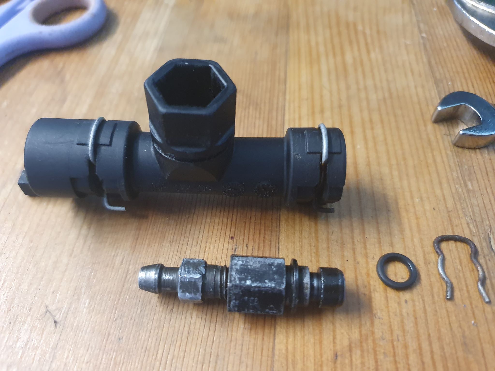

May have found the problem. Will update later. I pulled the Bleed valve assembly out of the T-Piece and found a small nick on the inner edge of the o-ring that seals the Bleed valve. This may also explain why it lets air in but not fluid out, as it's such a small nick in a rubber o-ring.
Keeping fingers crossed for you mate. Sounds like a right nightmare.
