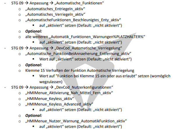

Wanted it for longer time but never tryed it but now i got it working from normale kessy to advanced kessy. Also menu option to put it on or off.

Do you need to log in first? Or be in DEV mode? I got an error trying to adapt the 09 unit. Tried login code 31347 that didn't work :( - EDIT have to be in EOL mode in OBD11
Managed to code some of it, but the locking when walking away is not working. Haven't found any of these optional values in my unit SW 0159 - probably an update is needed

On the Formentor it has always worked, but on the 2020 Seat Leon, when I approach the vehicle it unlocks, but when I walk away it doesn’t lock.
I’m using OBDeleven and it’s never given me any issues.
Does anyone know how to fix this?

I have made the same changes to the control unit but advanced kessy doesn't work stable. Some times it opens and closes the car, some time do nothing, mostly it's only closes the car and to open I need to use door handle. Maybe I'm missing something? Any sleep mode on kessy or key on PHEV versions of Formentor?

That can give problems.
Or also 2 Keys in your pocket can give issue
I have found the problem. Car's key is going in sleep mode. If I shake it before coming to the car, everything works fine. Maybe there is some adaptation for keys to make them more sensitive on movement?
