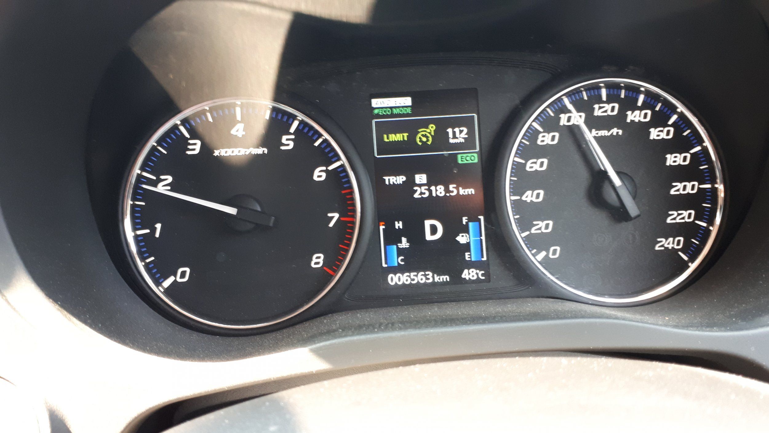

Also got frequent random warnings sometimes even when there is nothing in front of me on rural open road, fortunately emergency braking hasn't thrown on and I changed mine to Late. Locally/motorway can also get a safety distance warning but I try to keep a 'gap' between me and the car in front at least this doesn't light up the dash and beep at you. I had a hired Mitsubishi Outlander in Australia January (before Covid struck) and whilst the collision warning never came on at all the whole rental it did an emergency brake approaching a junction with no warning...must have brown trousered the bloke behind, certainly gave me a shock! Whilst we kept away from the bushfires I opened the window on the motorway and the air was burning my skin...
