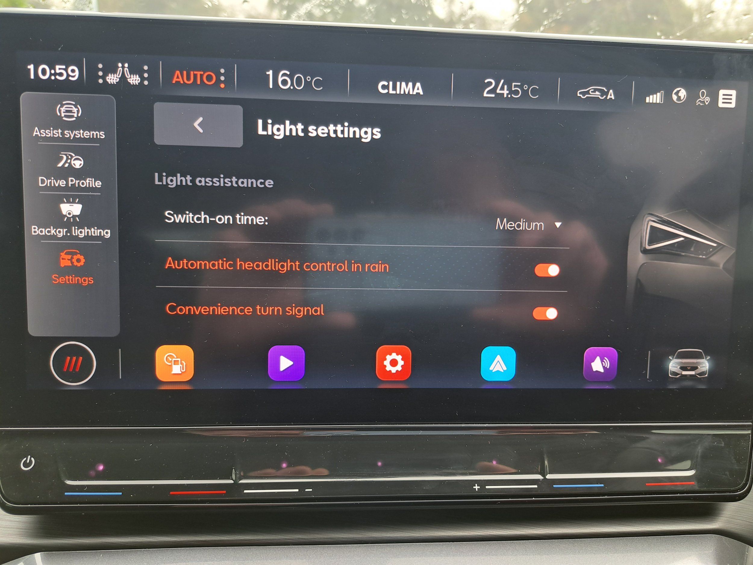

the indicators flash 3 times when comfort indicator is activated.
I don't have an option to change this number.
Can it be set to either 4 or 5 using obdeleven?

Is that for the MK3/3.5 or for the MK4 happy to be proved wrong but last time I looked the MQB Evo platform only supported between 1 and 3 but I have not been following for a while so it may have changed in later software updates.

99% sure you can do it in OBD11
Again I have not been following the coding for the MK4 for a while but I know that VW did turn off the feature (to increase above 3) on the Golf8, Leon4 etc and I have seen its possible with an updated dataset but that is not something OBD11 can do.
Happy to be wrong but that is what I have seen last time I looked.
