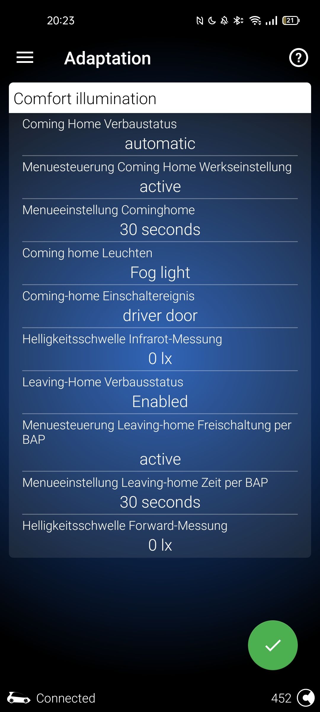

Is the lightswitch in the auto position and it's dark enough for coming/leaving home to work?
Maybe it's the sensitivity, as I was in an underground car park and it didn't work.
I've just gone and put a towel over the sensor and unlocking the car it didn't do anything however after taking this screenshot, I took the keys out and opened the door to see my lights on.
After locking and then unlocking it worked.
Sods law ?
