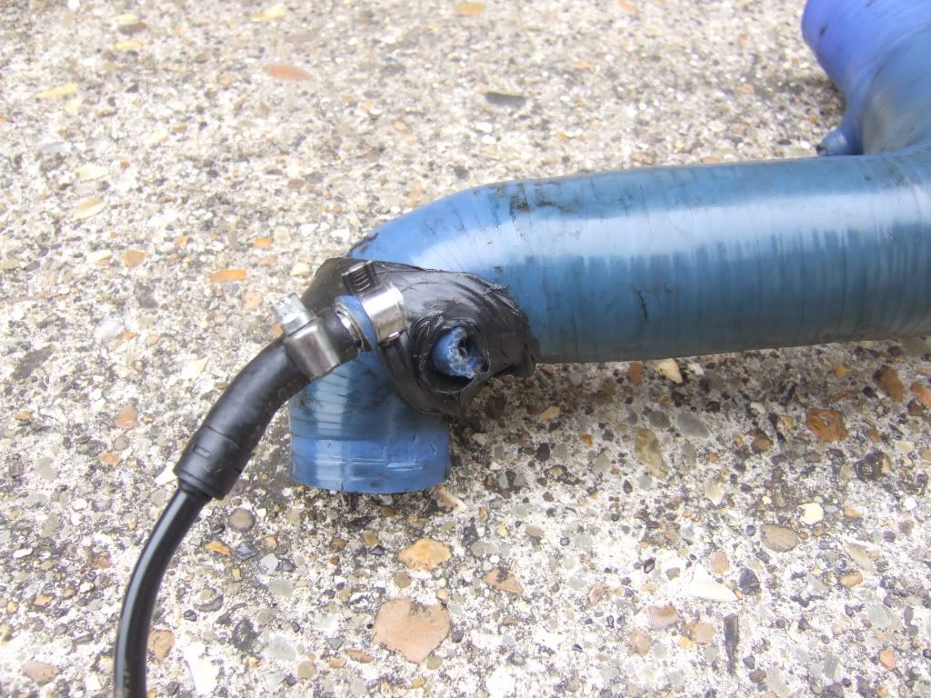

Bloody boost problems ay! Found out my problem in the end haha did you see?
