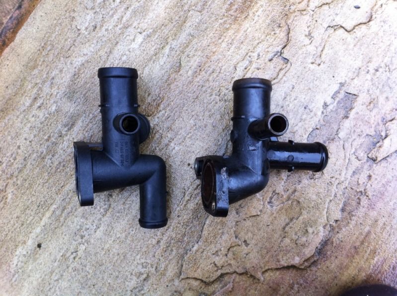

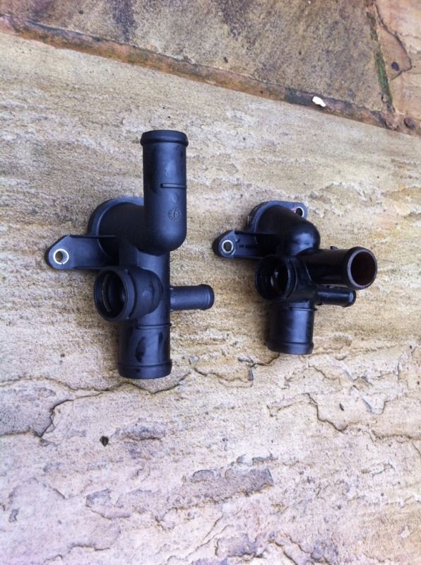

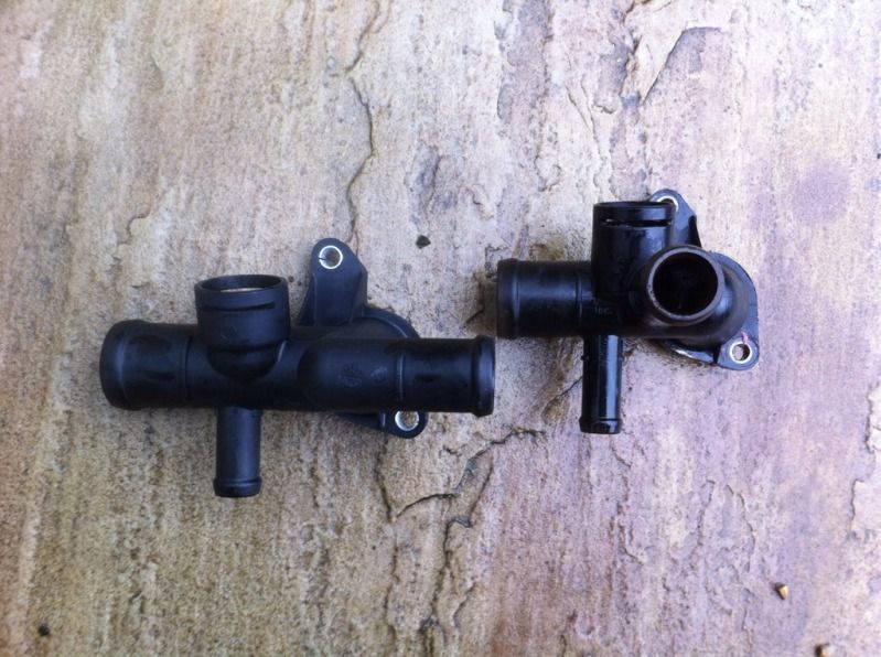

I don't know if you've already fixed yours but I managed to sort mine today. First off the part that's on SEAT's system for the AMK/BAM which is 6A 121 132 AP is definately the wrong part see pics below, the one on the right is the one I removed from my car (that SEAT say doesn't exist) the one on the left is the they said was right for my car. It fits fine but as you can see one of the pipes on the one they recommended comes off in the wrong direction. In the end I managed to make it fit but and I now have no leaks.

Ok, that's alot more info than what I got from my local dealer. Even though I managed to sort mine with the wrong part I still wanna get the correct one and do a proper job.
