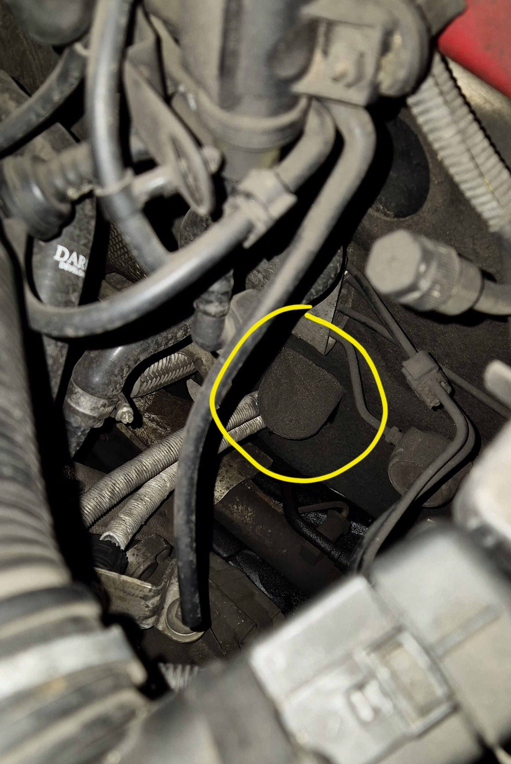

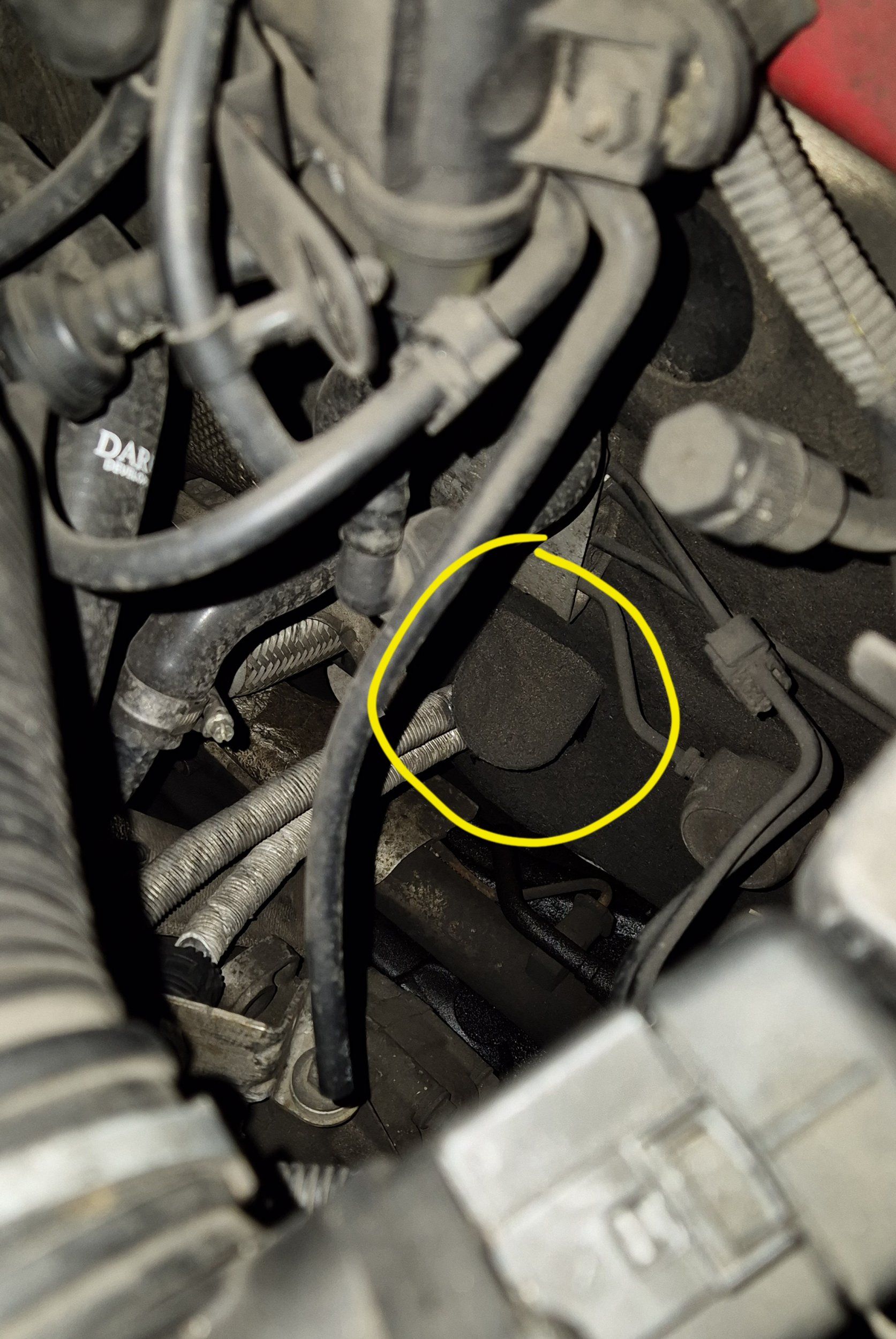

Hey mate, i have a scrap one on my drive i use for parts, took a vid for you, it's the 2 fat hoses with rusty clips. It's almost directly below the passenger side wiper connection.

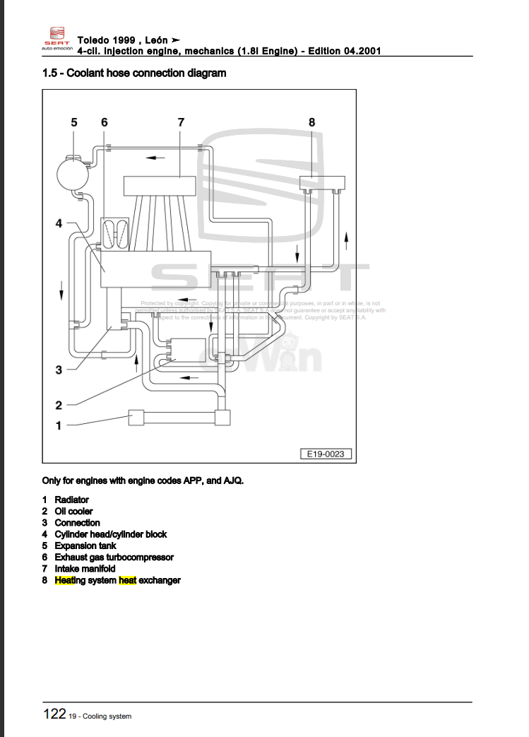

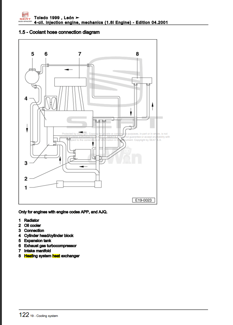

Diagram shows inlet and outlet so you could just bypass if need be.
