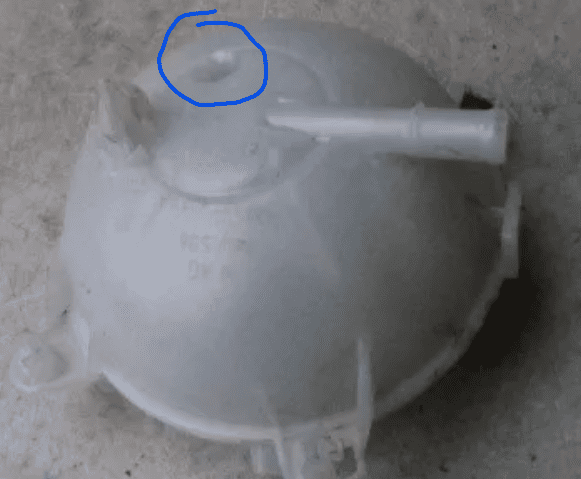

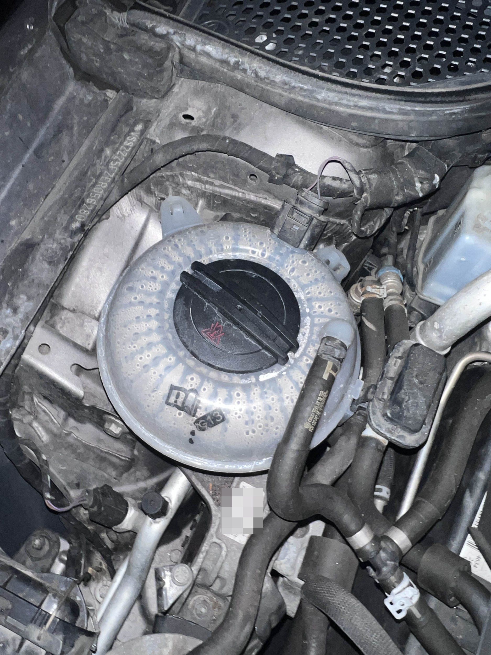

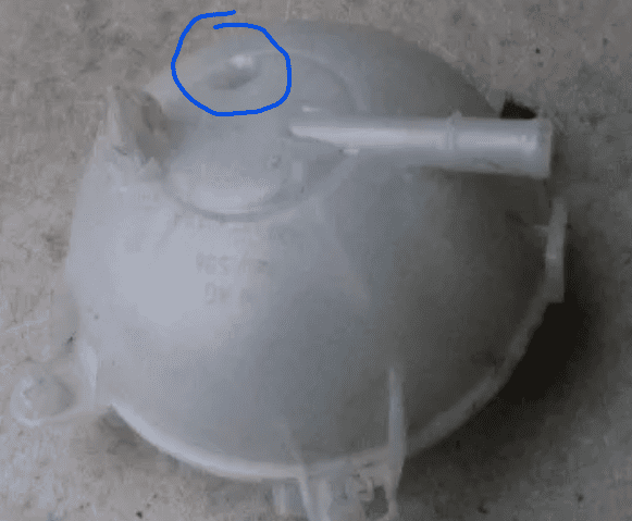

It is a bit hard to spot at first, but the reservoir has a builtin "channel" for overspilling coolant. On the picture below, its the protruding part of the reservoir on the left.
In other words, it dumps the coolant in the engine bay
AP1GczMn-27UrJTB_Z7_nlG6PuDSTGkL53grBCqOv4nC16xPIXRb2KROkccnzic9dj3W_Sr37OWY-iRtbvZfXMZouHhiSUIPM3OEjYHWXVyZLHwp-QAD0BfLqFQ9VesjAM6BYMbBsE1mY4H9XNmYMnddAocfjA=w1920-h1080-s-no

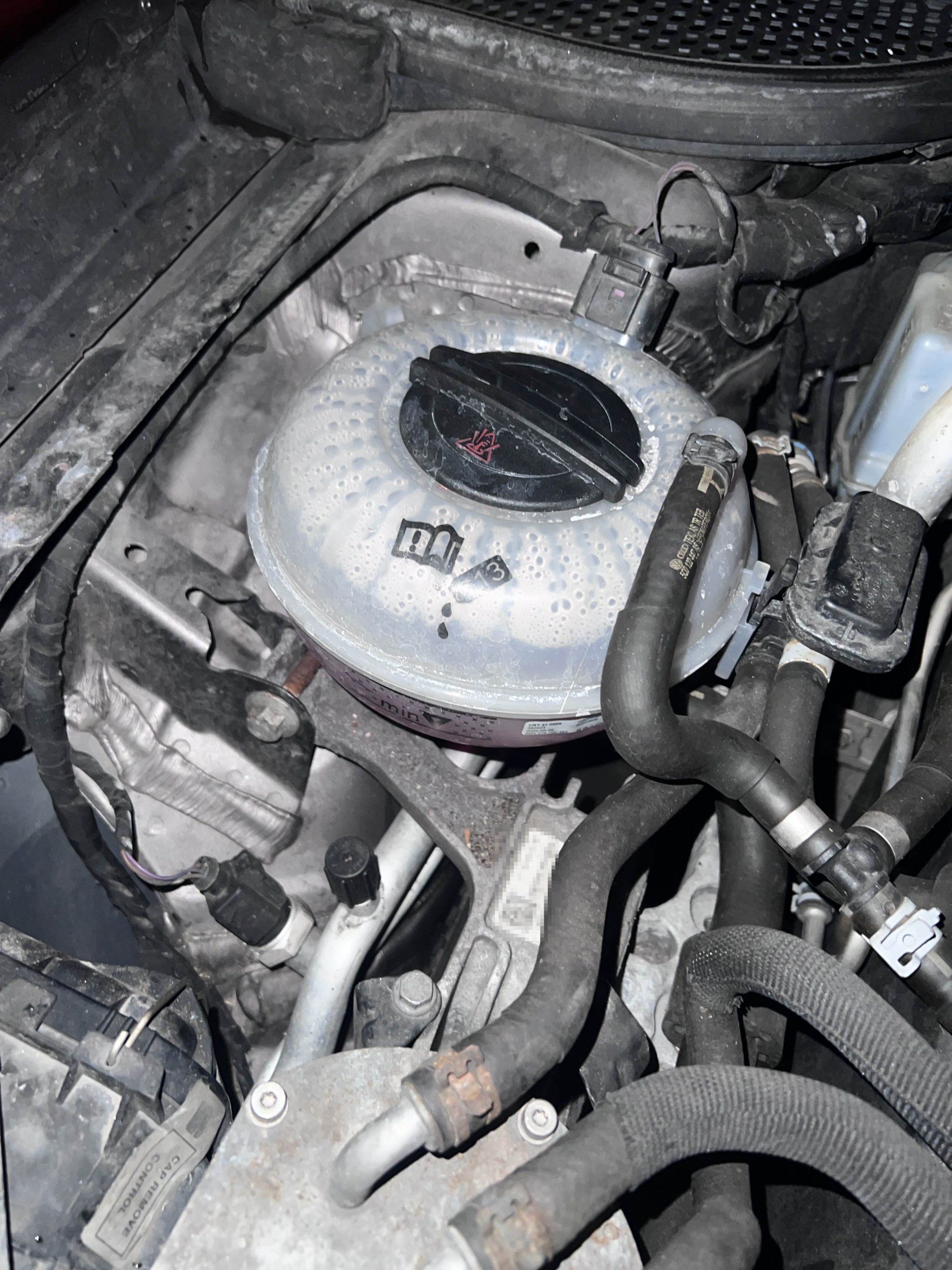

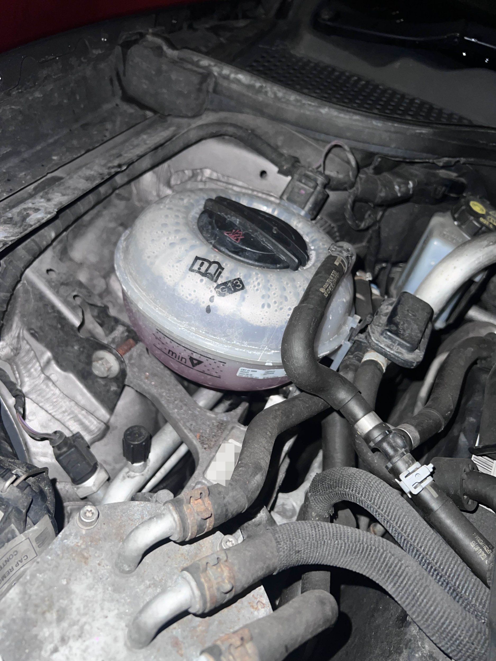

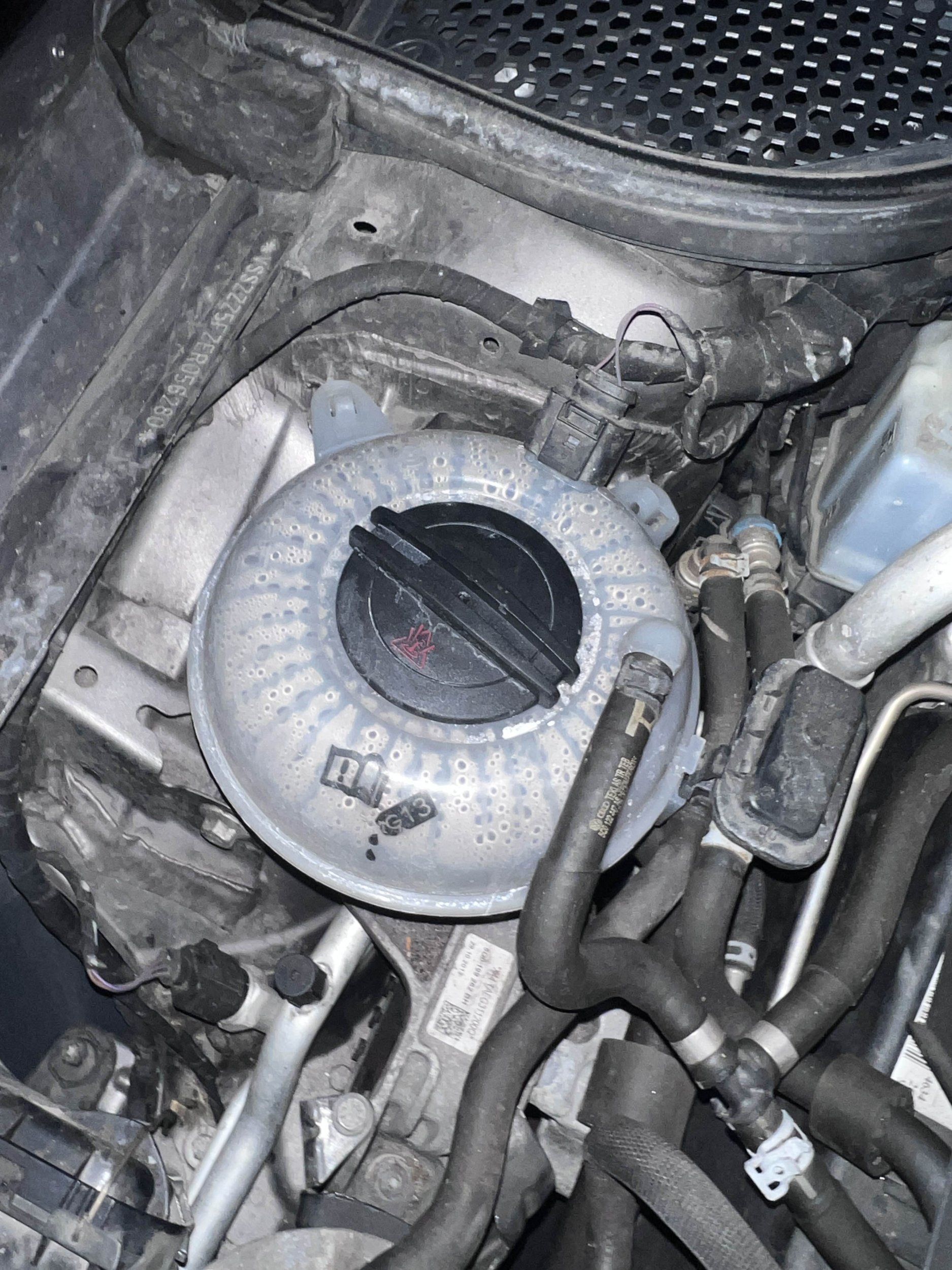

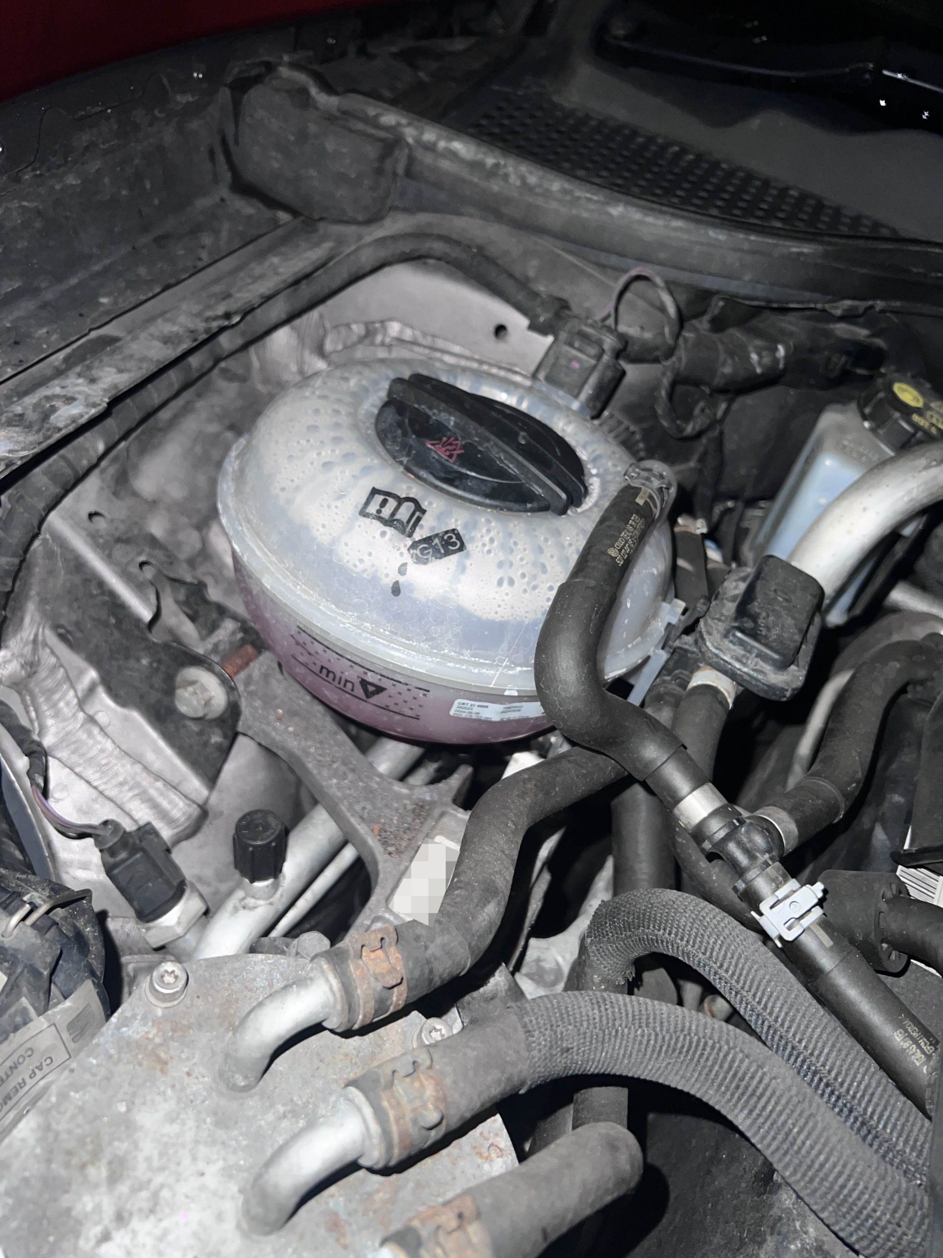

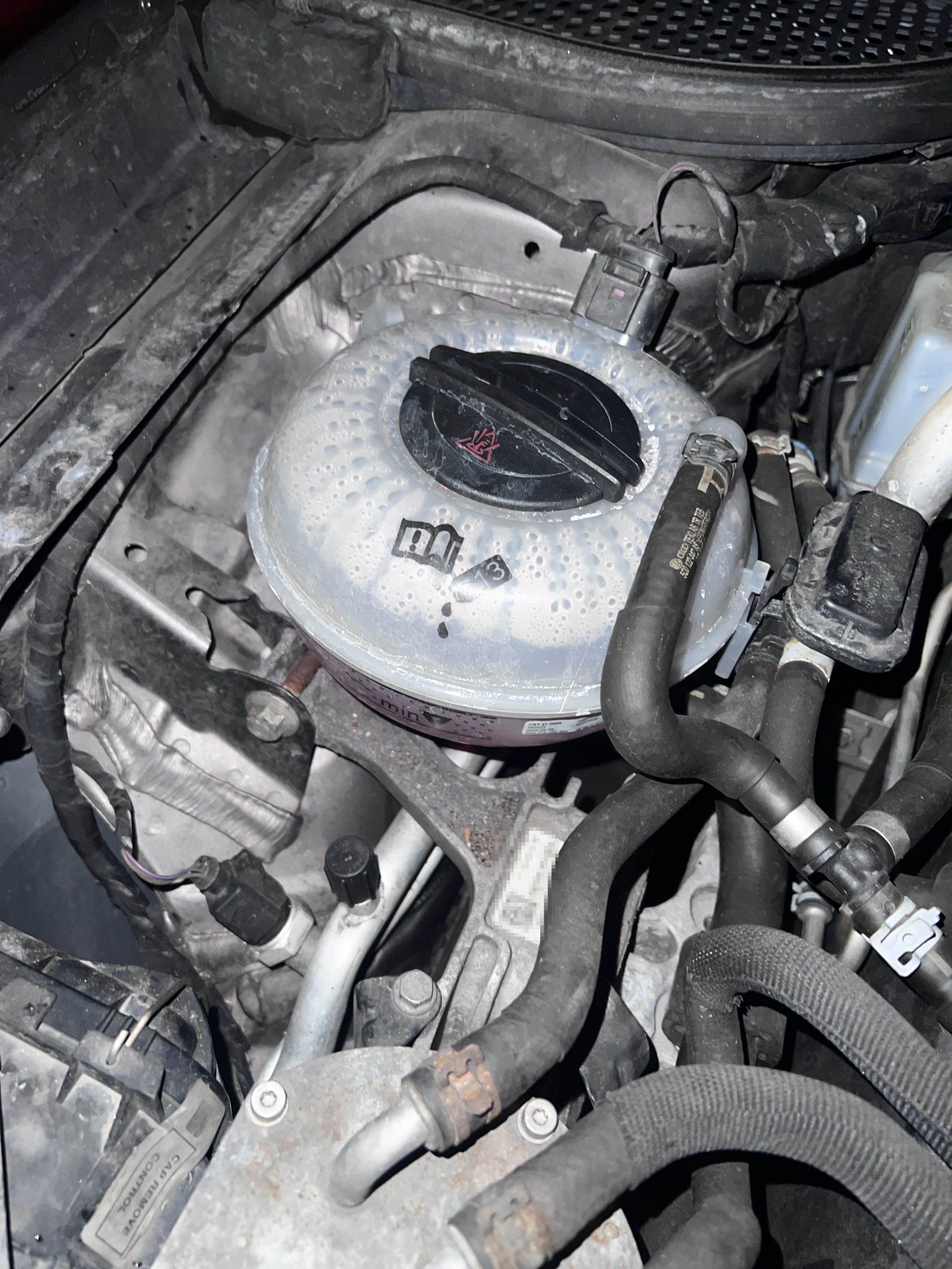

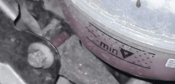

I'm attaching photos of my coolant reservoir (apologies about the lighting). Since it does not look the same; possibly the reservoir has been replaced?
View attachment 52581View attachment 52583View attachment 52584

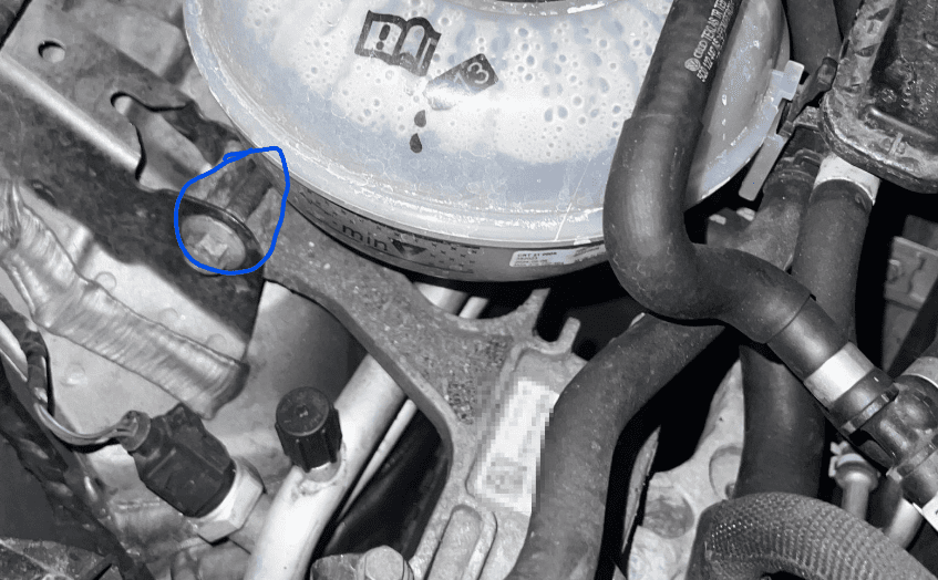

On your version of coolant tank, the overflow is in the centre underneath, so if your coolant goes above the max pressure of your cap - coolant with be expelled through this hole, so you may see coolant under and around your tank.
Your engine mount bolt is looking very rusty - maybe your coolant has been pooling here.

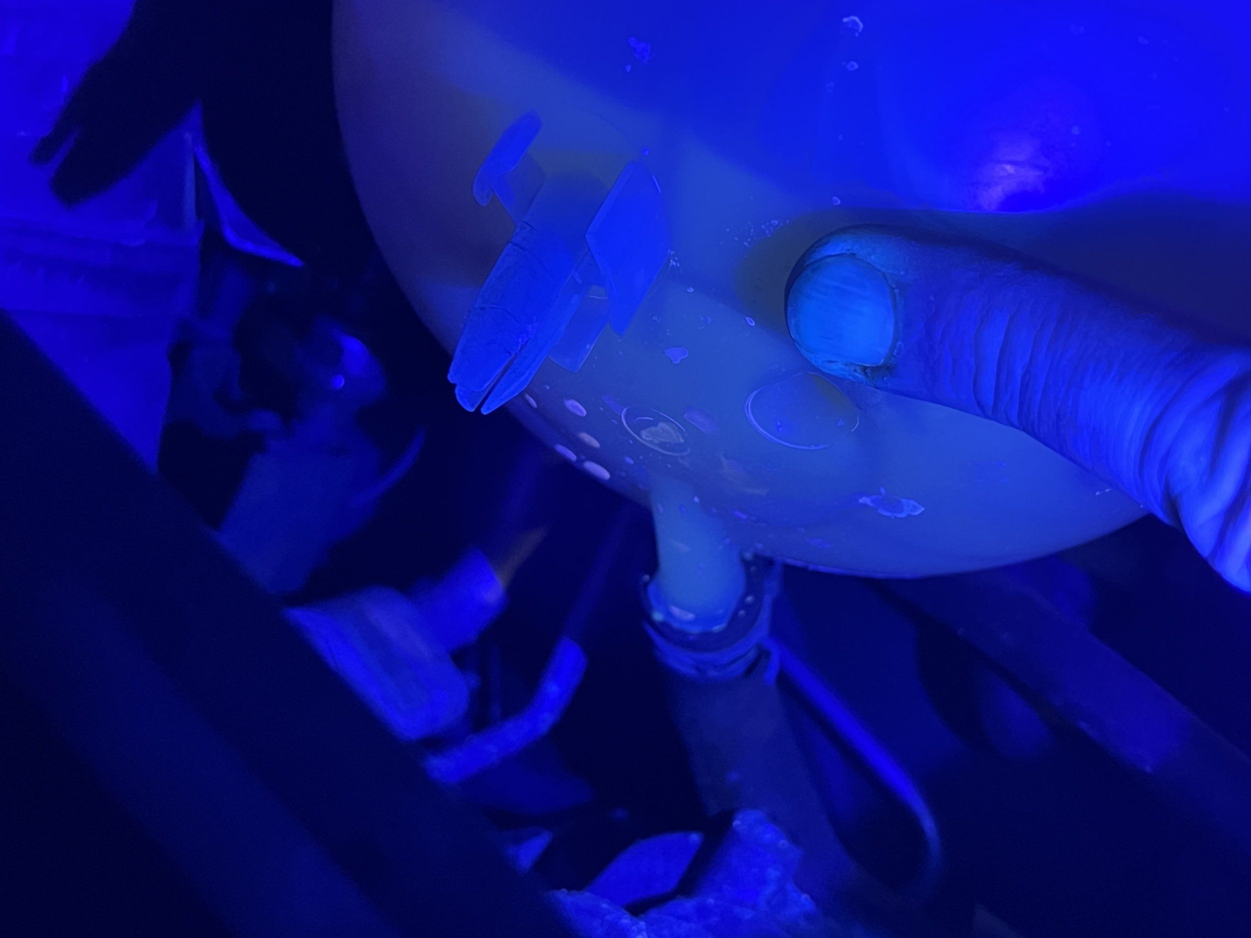

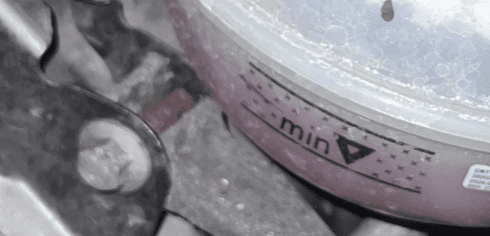

Added UV dye to the coolant and yep looks like it’s coming out of the overflow hole on the bottom of the tank. Can’t locate any leaks anywhere else including after taking off the plastic hood of the engine bay. What could this be a sign of? My coolant reservoir has been fluctuating between 50, 75-80%.

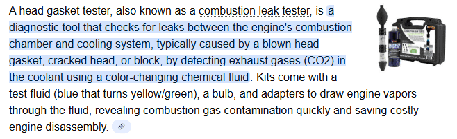

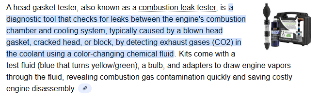

Amino Head Gasket Test Kit showing no Co2 in the coolant system!
