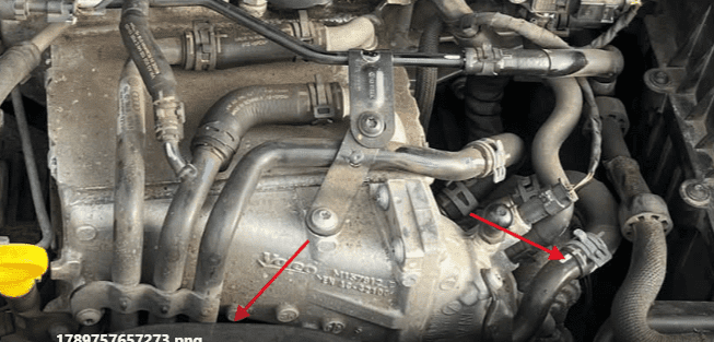

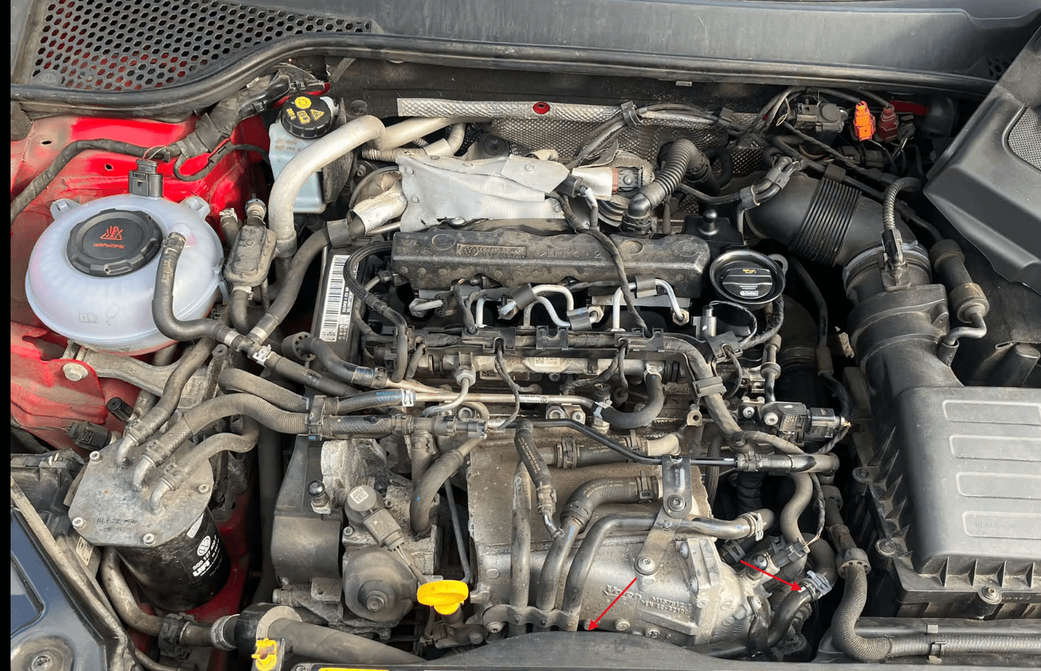

Looking at my late 2014 184 I can see two pumps listed - but its not clear which is for which job?
04L965567A Coolant pump PRE2,DK7
5Q0965561B Additional coolant pump PIERBURG
Reactions: Compo1
And the number which you posted is for the charge cooler pump, I have already replaced that.
It is, and the part number i posted is for the pump you asked for ! Near the oil filter housing.
