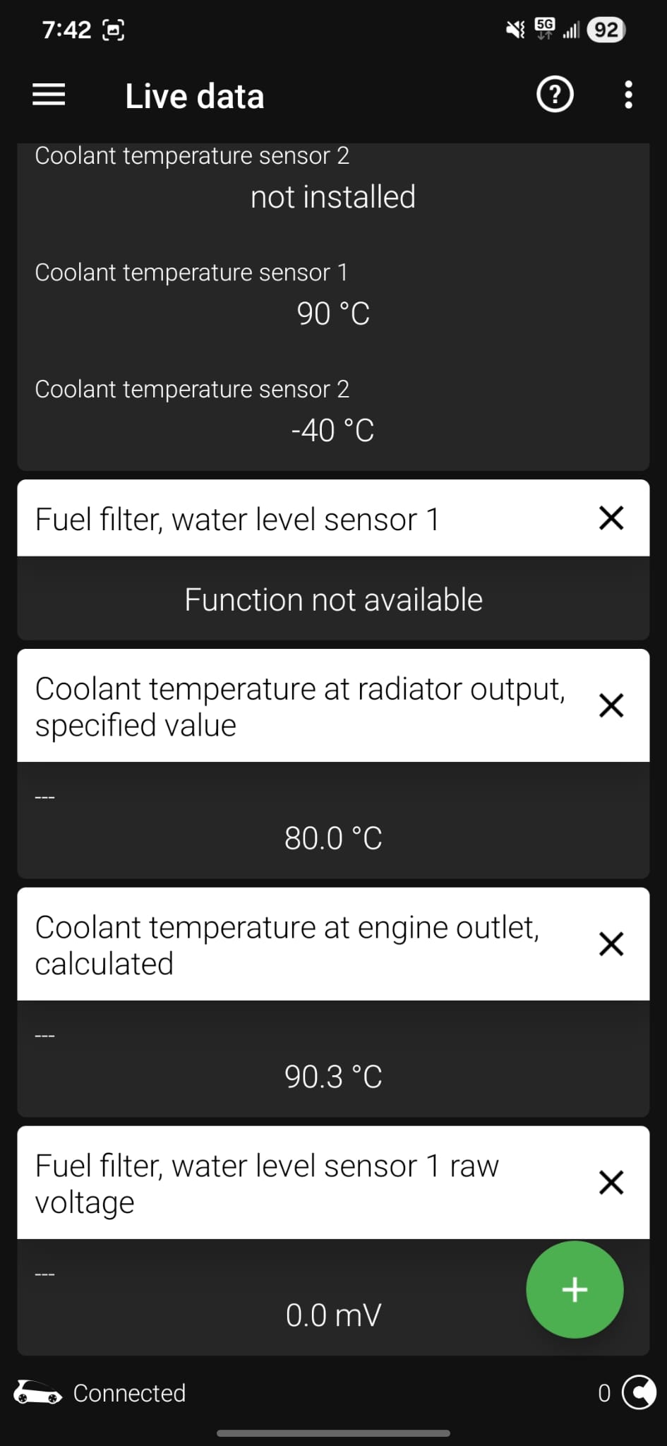

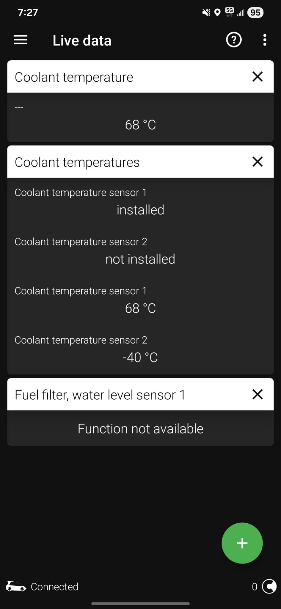

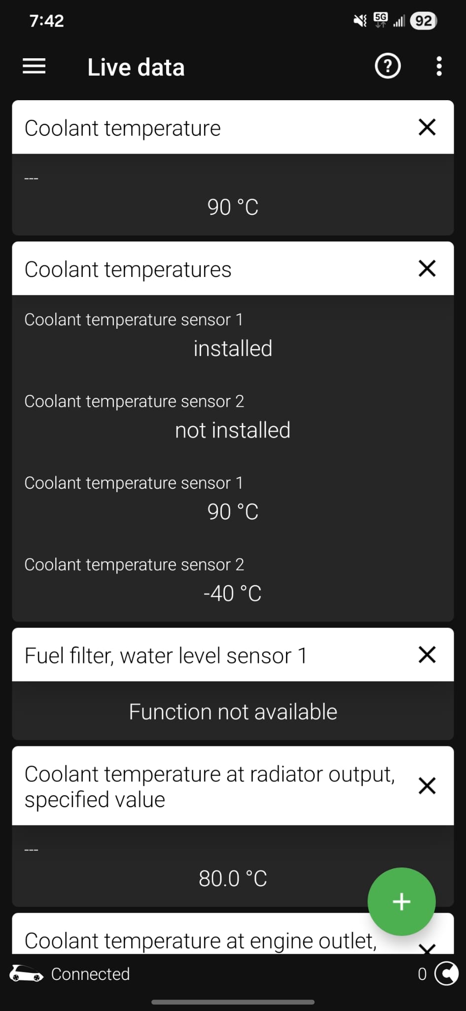

Hi,
I connected an OBD reader yesterday and had the car get to temp and 90° was reached pretty soon. After that it didn't fall below or go too high.
I went and selected live data information for coolant or water related things as there was no actual option for thermostat. Please see images attached.
Do you (or anyone) think (s) that this live information data shows thermostat to be working? Or if it still could be somehow not functional properly?
