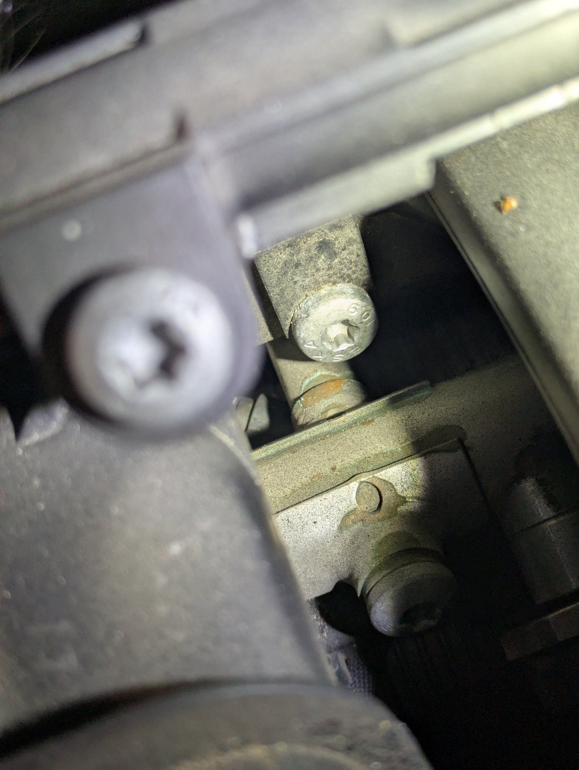

Strangely, I've noticed damp on TOP of the I let manifold. Maybe unrelated.
Some other possible areas....
This one, a coolant coloured drip of the injector rail, how would it get there?

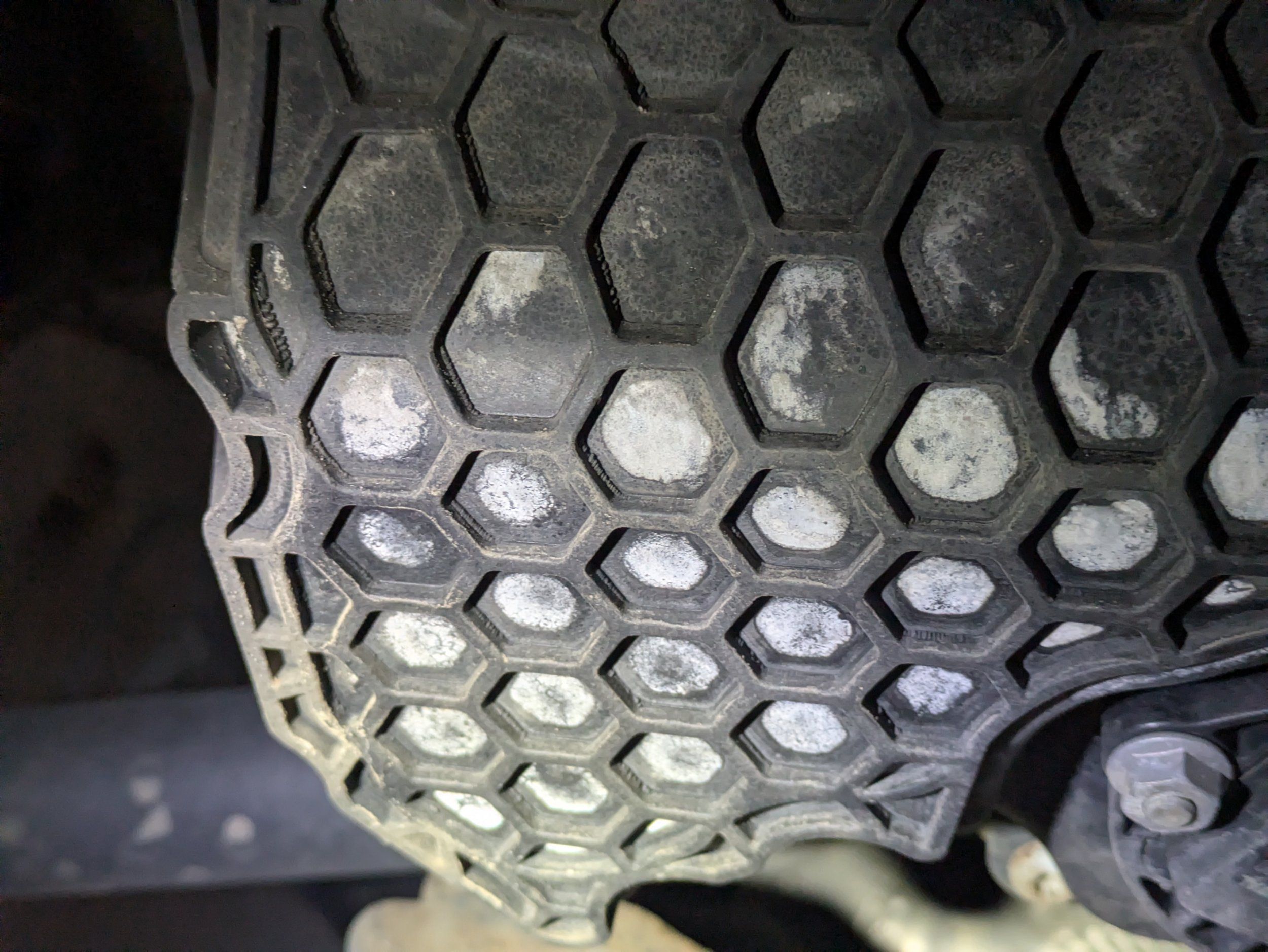

Some residue on the oil pan..white...could that be coolant or is it road salt maybe? I don't think it's this one. But never seen white residue on an oil pan before, then again all my other cars have always had a smooth metal pan.

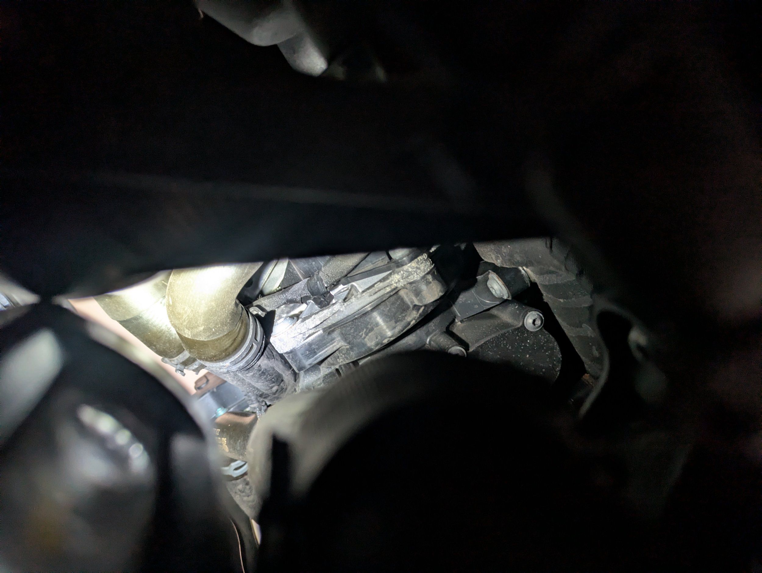

Could it be this coolant connection near the turbo, which I see from Google is common. It's such a hot area...no moisture there, but there is some crusty residue (but it's not G13 coloured!).

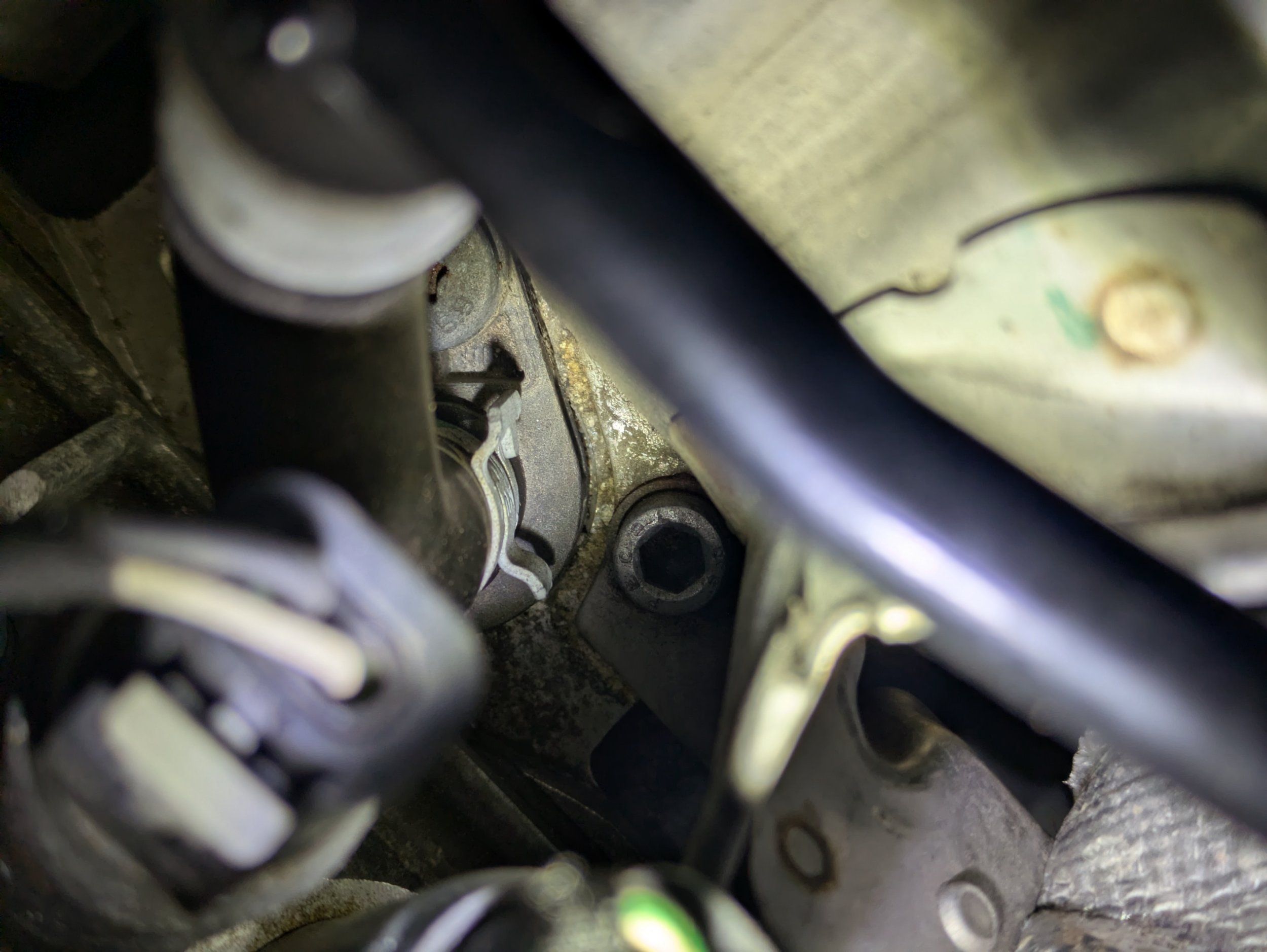

Underside of the waterpump looks OK to me? It's on 80k, I believe. 2018 car.

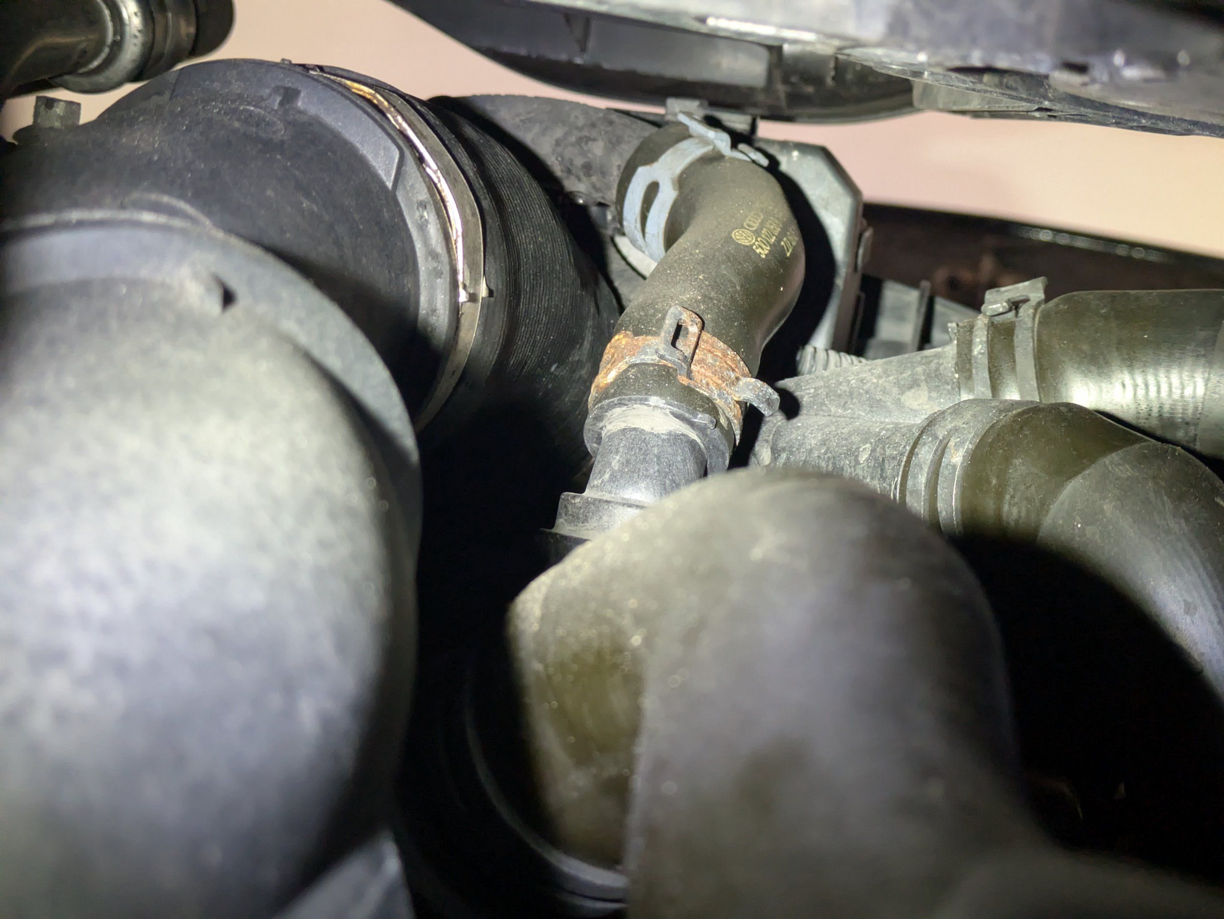

This coolant hose looks like a possibility? Maybe I could switch out that clamp for a stainless jubilee clip?

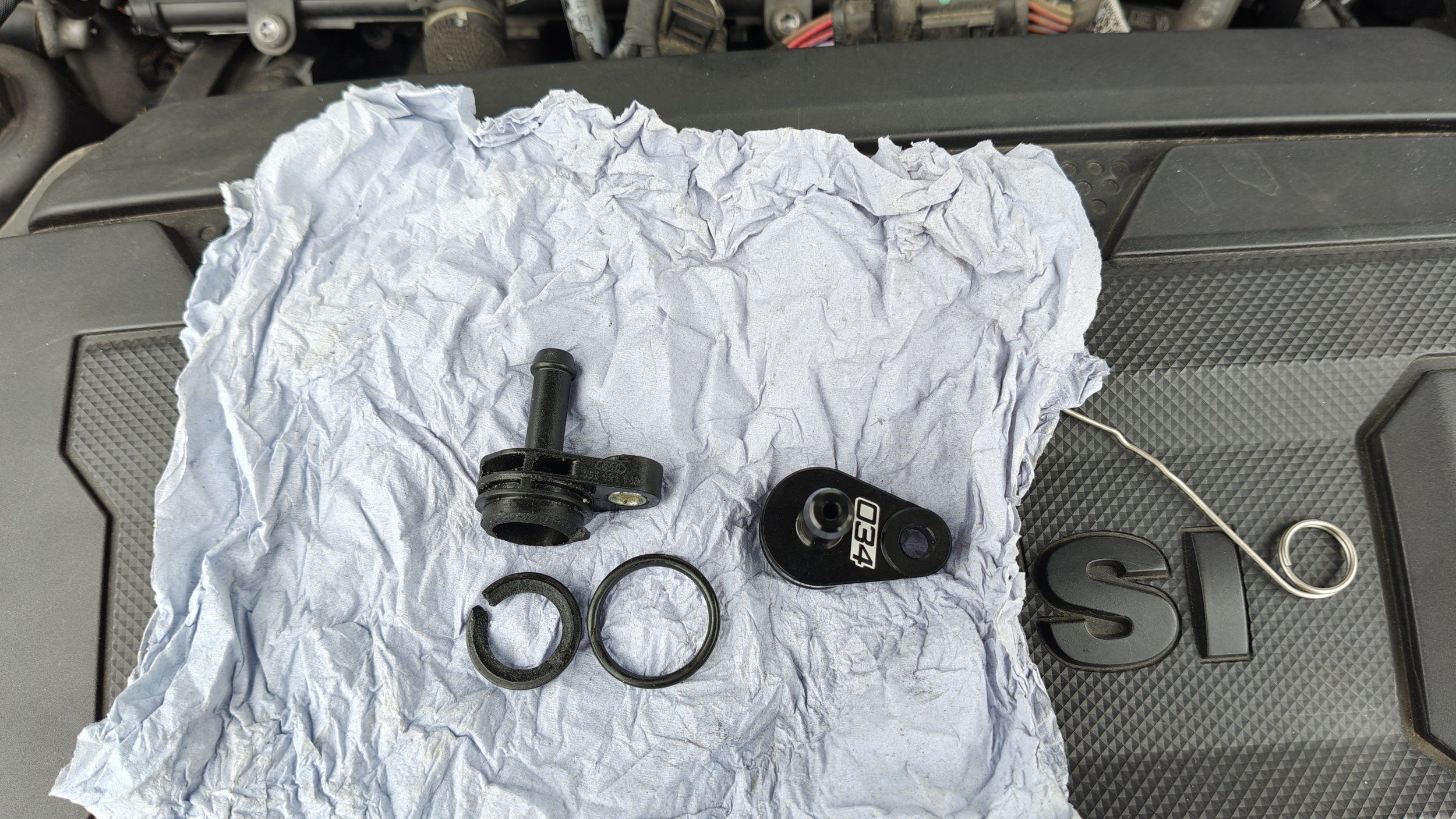

I recommend replacing the coolant nipple with a billet version. Its not that hard and a good futureproof mod. I bought mine from Aliexpress, fitment is 100%
AP1GczNAeWvDgVhhoRvTf9Bicv8zBfSh4pkxHKzKdsF0W9Np7UIRWzkMwnCuZCUNf1SHTq5oxcHwVZmvDCr-_4EWSEN-GoSHzCgwBNFNAAf-z5ABgR5rox1vFCzZex4b8QZZgihC-fMtSDzoS-lTa13RgR2IAw=w1920-h1080-s-no-gm
Have already ordered one to fit at the weekend (I went for an OEM replacement tho - £16 delivered).....

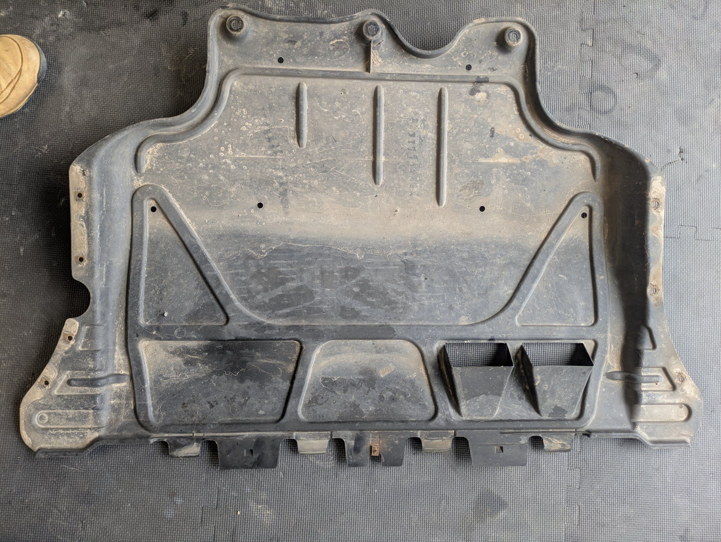

There is airflow over the engine if you have the air snorkel opened on one side (the default config), that might also come into play with your leak (?). You can close it up for a little more air towards the air filter, see my build thread for more info. Also known as the "Pikey R600" mod
This one is also worth it

I had the coolant nipple fail on my oem coolant inlet under the turbo. I didn't actually know it had failed untill I had taken the old one off. The bottom of the plastics O-ring grove had just blown off so the O-ring and lip were just sat inside the hole. The screw kept the flange in place but it clearly wasn't holding a seal under pressure and temp. With the coolant escaping right underneath a hot turbo it's just evaporated away.
I was chasing a coolant loss similar to yours figured it was easier enough and cheap enough to upgrade to the billet one anyway. Mostly went for the 034 one as I live near Awesome GTI.
