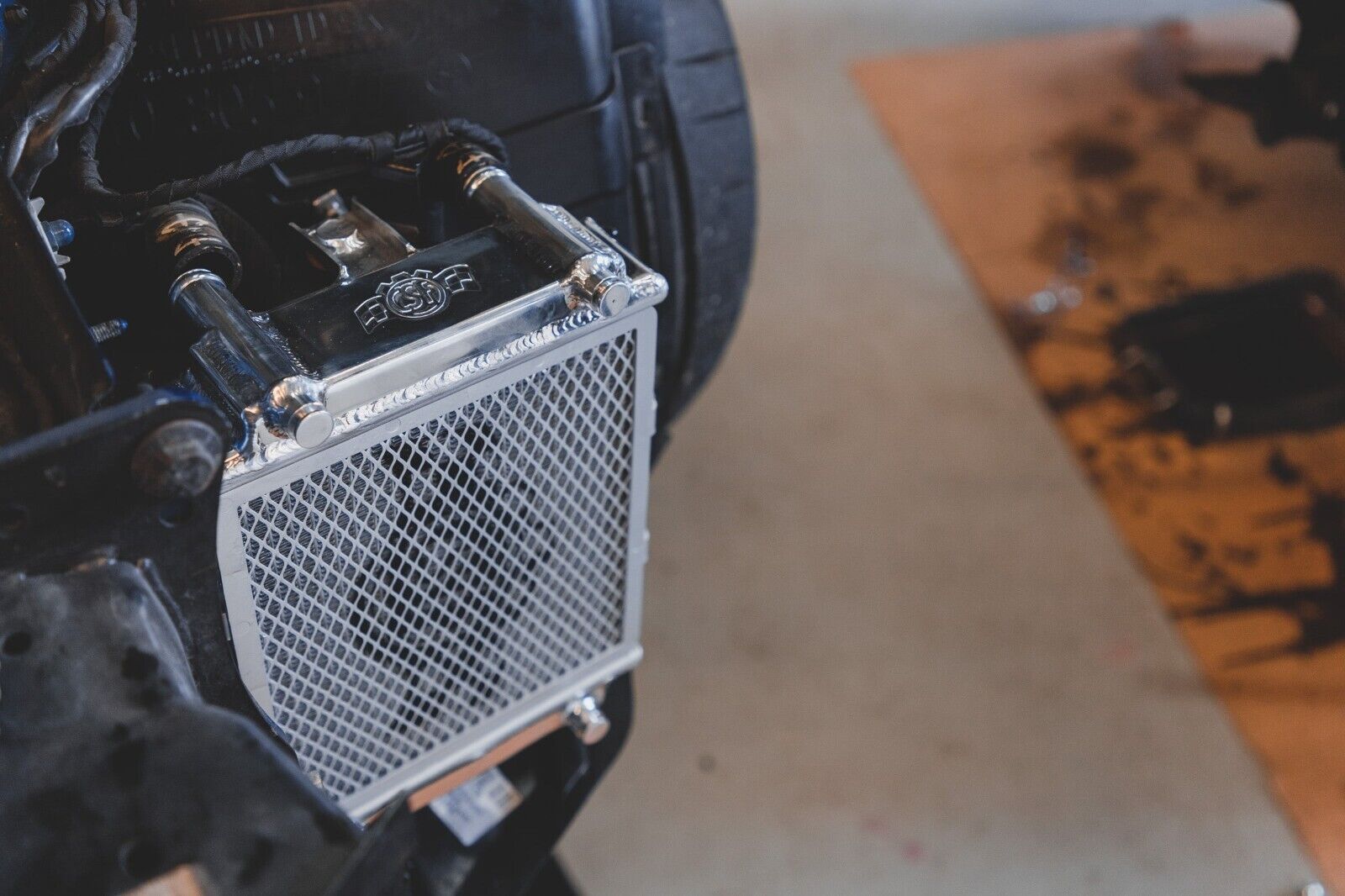

Personally I fitted the DSG Aux Radiator with CSF Quadruple Pass DSG Cooler although Airtec do a cheaper version and certainly when I tested it out on the track it made a big difference to DSG Oil Temps.
