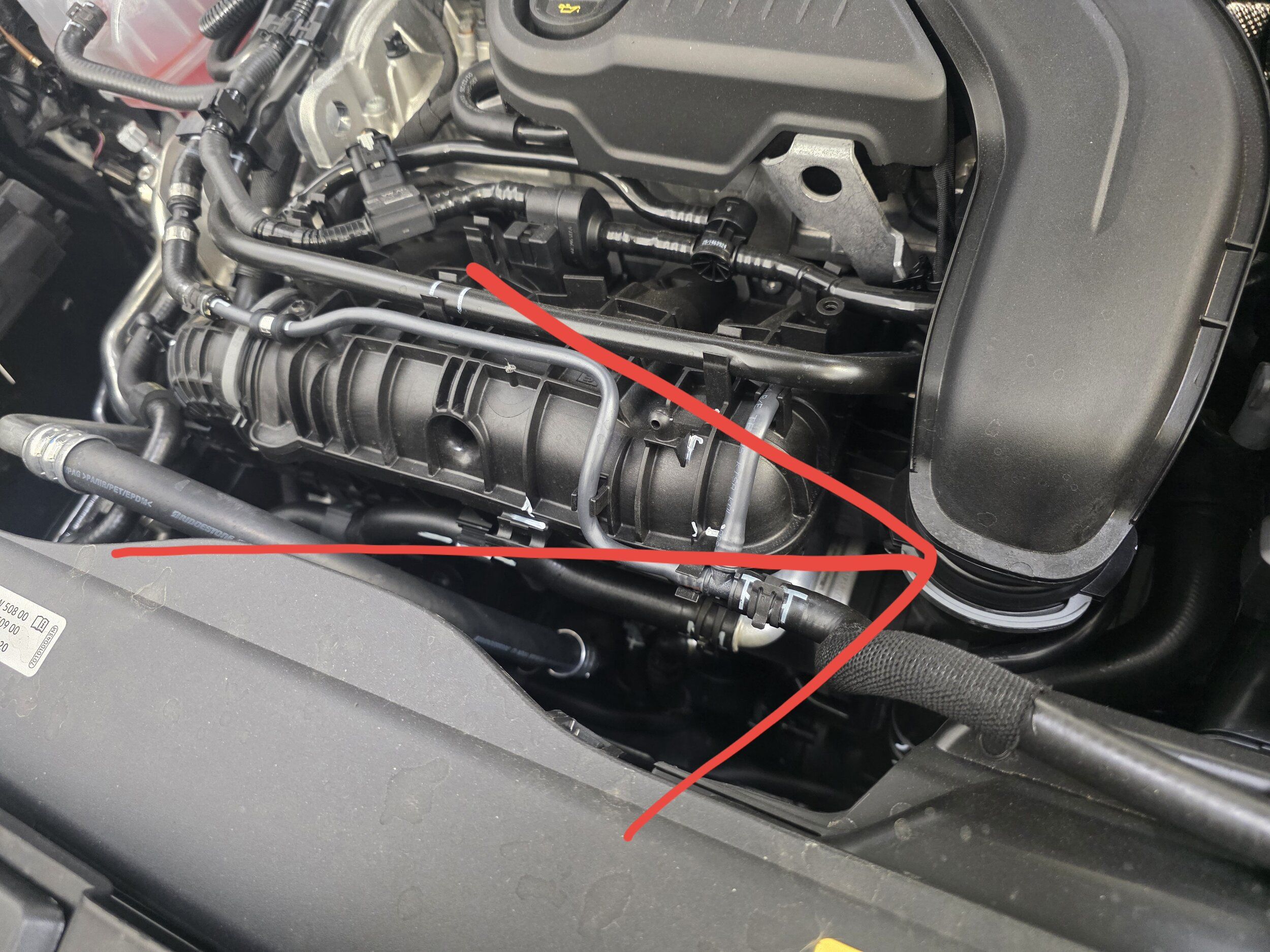

Take the intake pipe off the charge cooler and see if there's a pool of coolant in it.
Reactions: nd-photo.nl
Just lift this intake pipe off, it goes into the cooler, if you look down into it there will be a pool of coolant if that's the culprit.
Or take the map sensor out of the inlet manifold and see if there's any coolant on it.

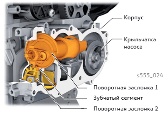

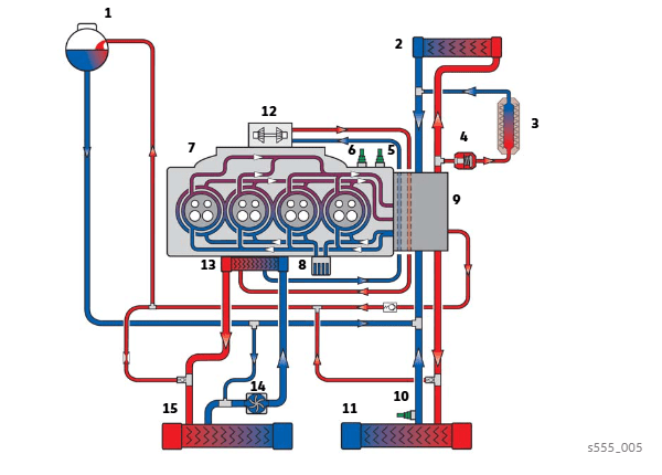

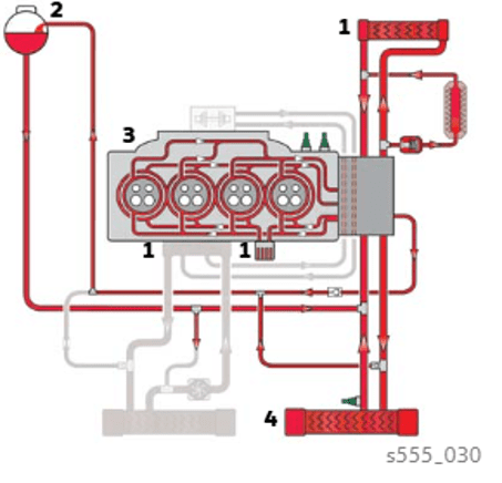

You do have a complicated pump/cooling system/electronic thermal module - so you do not have a 'simple' thermostat.
This has various phases depending on an ECU control - Have you scanned for fault codes?
The matrix is number 2
Coolant pump with engine thermal management system module GX33 is number 9 - depends on how this module is plumbed internally - if the matrix is in series with the head then this could cause overheating (and expelle coolant out the tank) - but if its in parallel I don't think it could.
If you have a blocked matrix you would normally get a temp difference from your left and right vents?
FYI From here:
Operating strategy of the thermal management system
The operating strategy of the thermal management system depends on many different factors.
These include, for example, the speed and torque, the fastest possible engine warm-up, the heating requirement, and high or low outside temperatures.
The engine thermal management system module is activated in different phases, which depend on whether the ignition is on or off, whether the engine is "cold" or "warm", and whether the coolant temperature is regulated in the range from 85 to 105 °C.
Phase 01 Initial position with ignition off If the ignition has been off and a certain time has elapsed (see phase 05), rotary flap 1 moves to a position in which the path for coolant to the radiator is closed. Thanks to this, the coolant remains in the engine and cools down more slowly. If there is still residual heat when the engine is restarted, the engine will reach its operating temperature more quickly.
Phase 02 Initial position when the ignition is switched on and the engine is started
To warm up the engine as quickly as possible, both rotary flaps are completely closed.
The coolant remains in the engine (does not circulate) and quickly heats up from the heat of combustion. The coolant pump operates, but does not supply coolant.
Phase 03 Warming up the engine to a coolant temperature of 85 °C
In this phase, both rotary flaps open individual channels to various components in the following order:
1 Cylinder head, engine oil cooler and heater heat exchanger
2 Expansion tank supply
3 Cylinder block
4 Coolant radiator
Phase 04 Coolant temperature regulation to 85–105 °C
After the engine has warmed up, the coolant temperature regulation begins, depending on the operating mode.
This regulation is carried out exclusively via rotary flap 1. Rotary flap 2 is fully open and remains in this position. The coolant temperature is maintained at 105 °C at low load and speed, and is reduced to 85 °C at high load and speed.
Regulation is carried out steplessly according to programmed parameters
Phase 05 Ignition off and diagnosis
After the ignition is switched off, both rotary flaps are fully opened for a certain time.
The duration of this operating time after the ignition is switched off depends, for example, on the activation of the charge air cooling pump V188 and the radiator fan VX57. Then the engine temperature control module performs a diagnosis of the end positions. In this case, the rotary flaps are first moved to the fully open position, then to the mechanical stop of the fully closed position and the fully open position.
Finally, the engine temperature control module moves rotary flap 1 to the "coolant radiator closed" position. In this position, rotary flap 2 remains fully open
