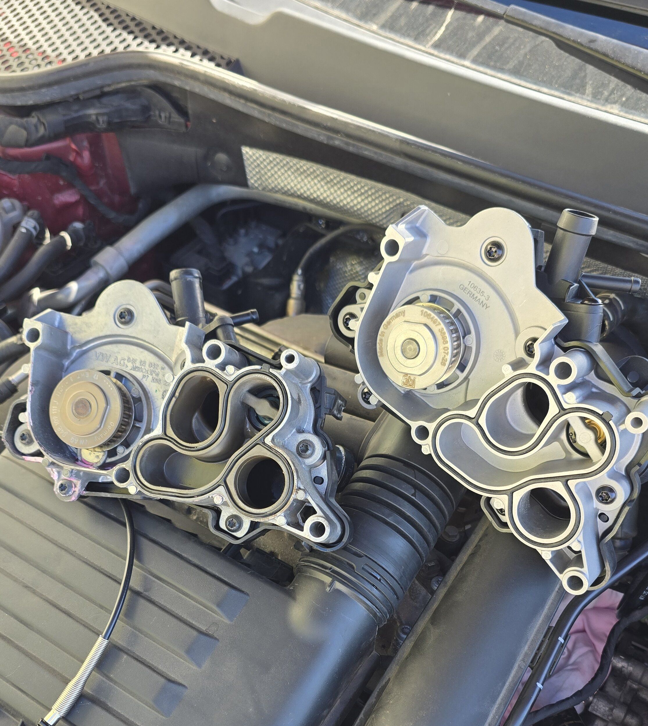

About 1 month ago I checked again the coolant level and noticed it was at min mark which made me inspect all coolant system tubing and thermostat housing as far as I could see. Found the thermostat housing was leaking below the water pump area.

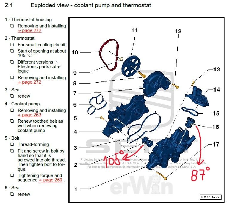

I ordered this part on autodoc from Febi Bilstein brand and did the replacement about a week ago, also the oil/filter servicing at the same time, checked the maintenance manual for the guidelines regarding the replacement of thermostat/pump housing and I think I did everything correctly - the sequence torque while applying 30nm torque for belt tensioning, re-tubing, filling the system and bleeding just like I did last year.

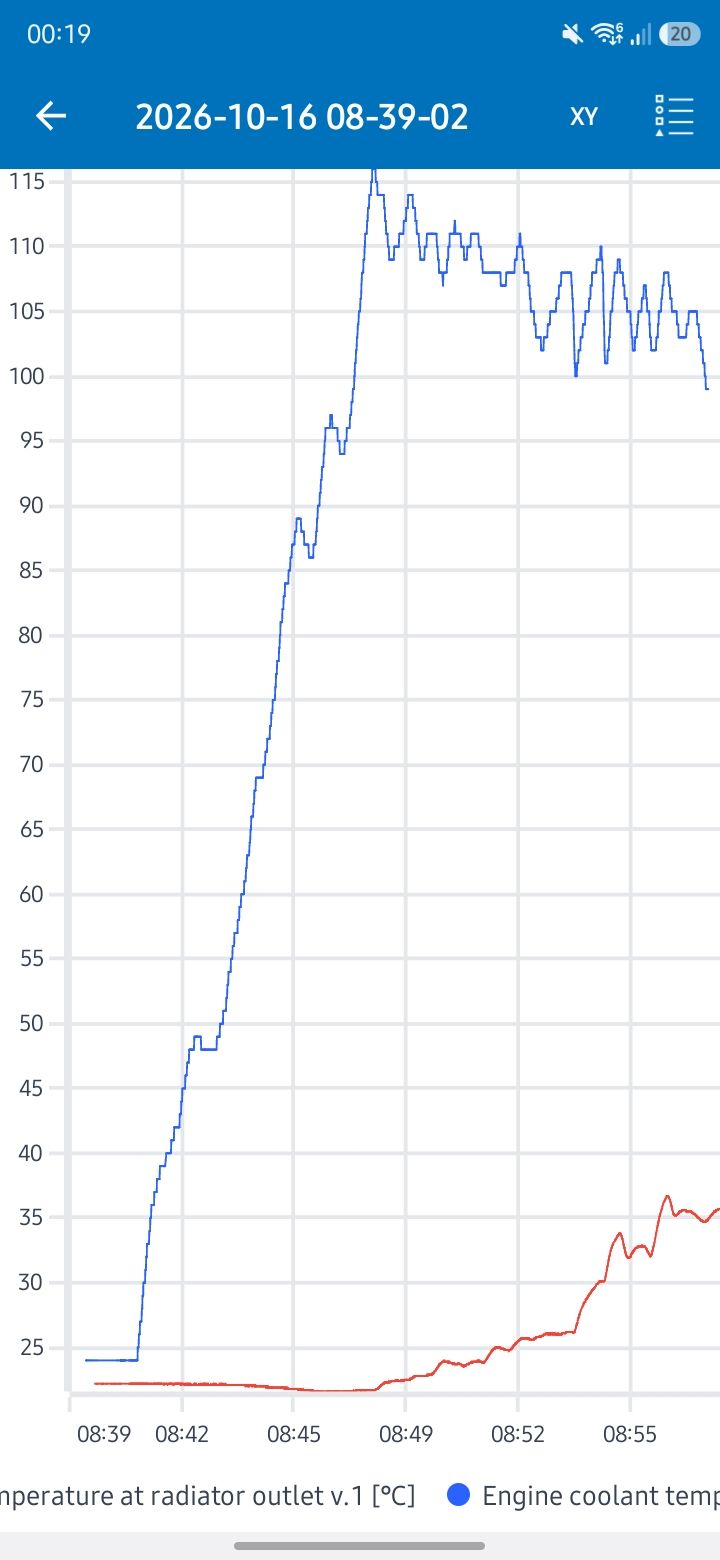

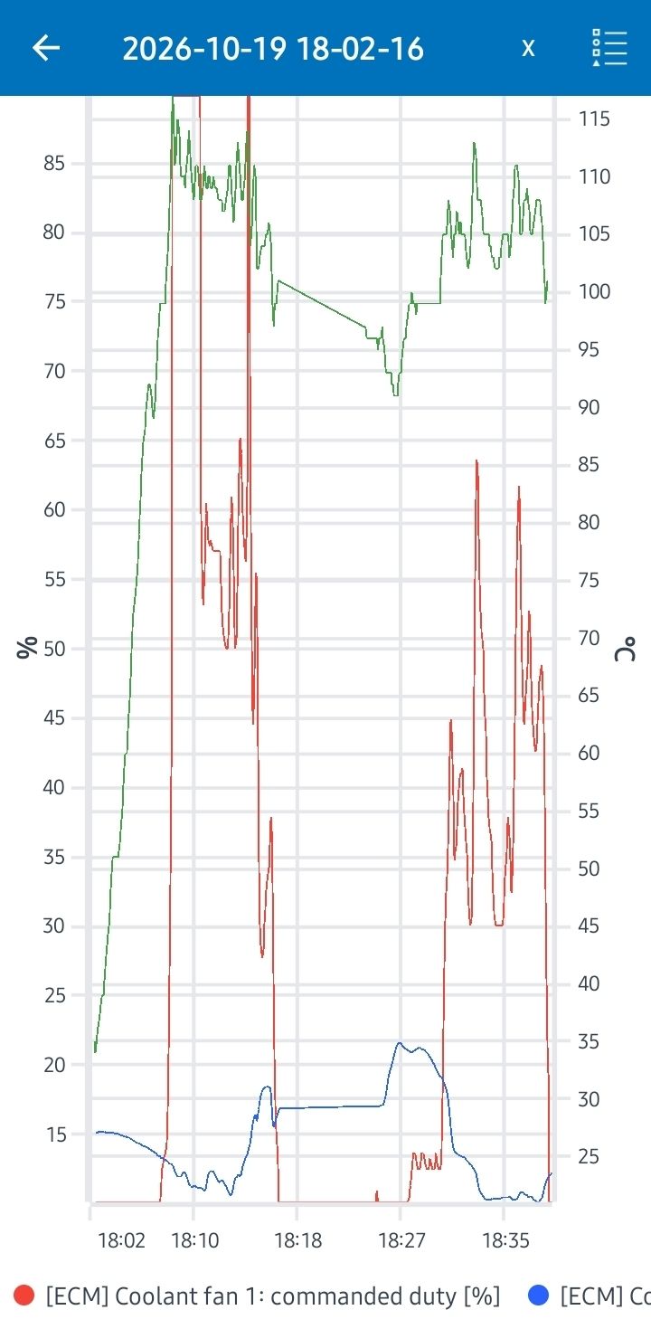

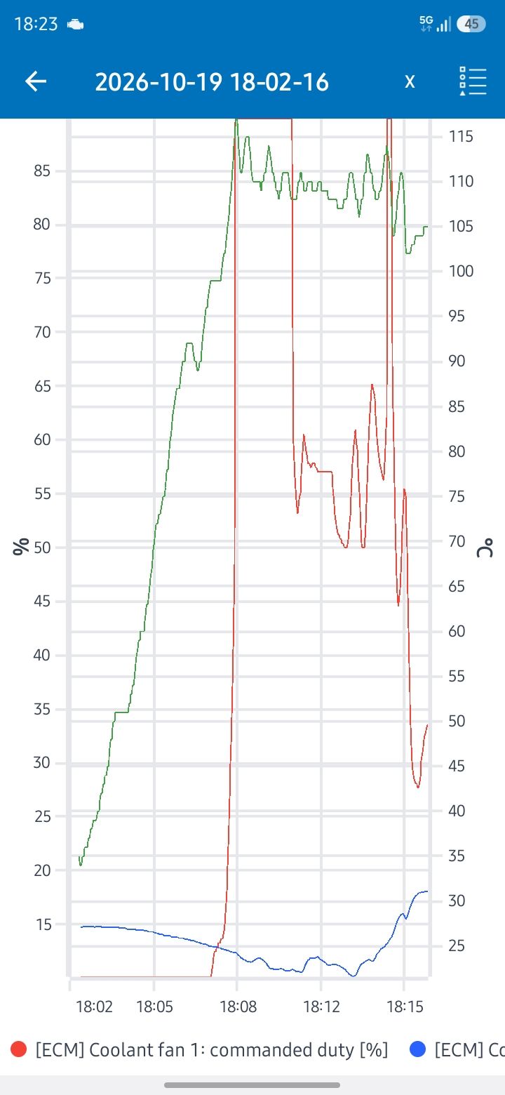

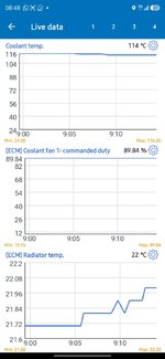

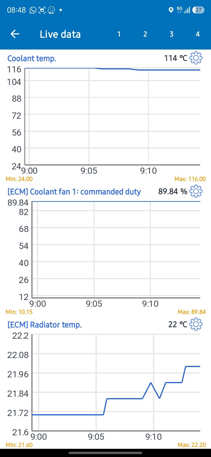

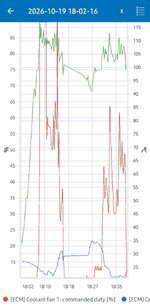

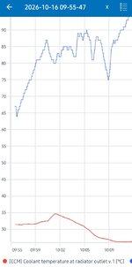

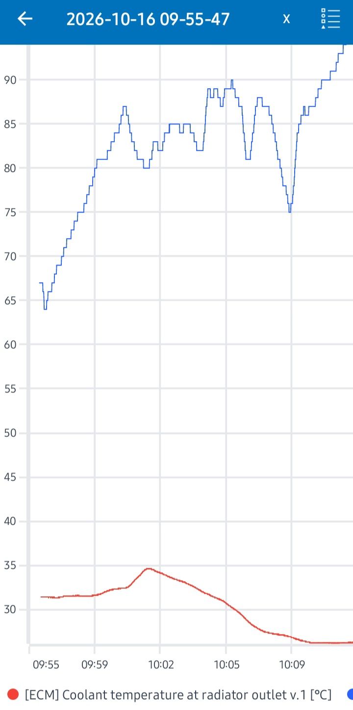

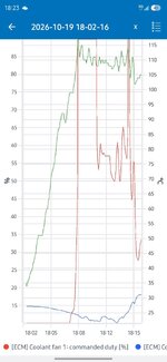

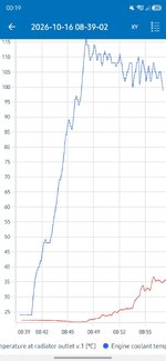

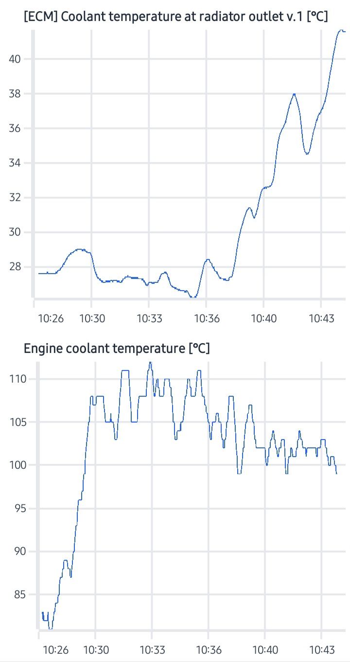

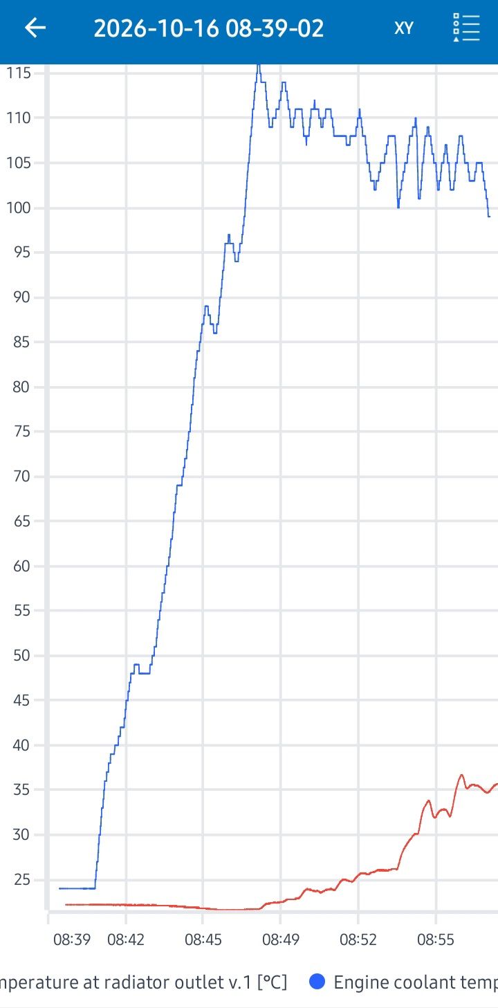

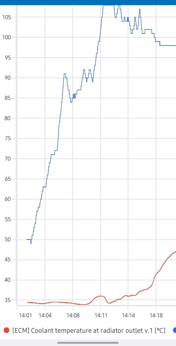

Right now I'm facing a problem regarding the coolant temperature, on the subsequent trips I've noticed the temperature reaching 100c, 110c, even 116c, and then dropping gradually to 100c and hovering between 100c and 110c. I've also noticed in some trips that the temperature kept around 90c +- 3c, not even reaching 100c. All these values were read using OBD2 device.
I'm assuming this might be an intermittent issue with the thermostat.
What's your opinion? Can someone give me an insight about this problem?
