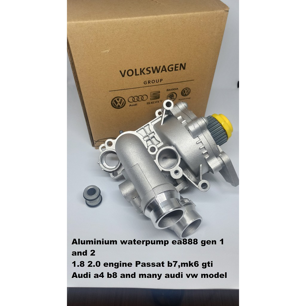

I have seen a number of "REPAIR KITS" and as I have already had the water pump replaced my question is the leaking part normally the thermostat housing and if so are the new revisions good enough That I don't need to worry about the plastic leaking again.
I think I see them existing for Gen1 & Gen2 :unsure: Partnr should be : 06H121026DD

VAG never made a full aluminum housing - this is an aftermarket copy with a fake box.

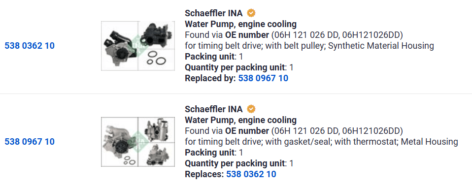

There are some aftermarket brands with metal housing for the older EA888 - for example, INA switched from plastic to metal housing.

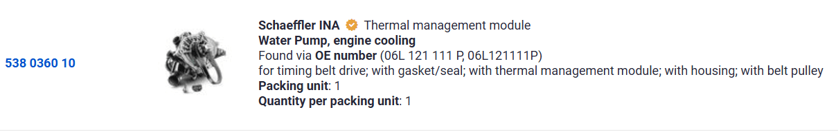

But on your GEN 3 pump - 06L121111P, they still have a plastic housing. I can't see any AM brand with a metal housing for this latest version.
Is this because there is less of a problem with these later versions? - or because no one yet has the tooling to cast the housing? I suspect the later!

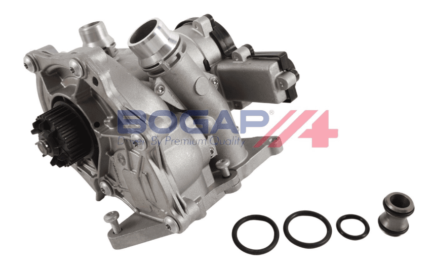

I see there are now some aftermarket versions tooled up using an aluminum housing -
