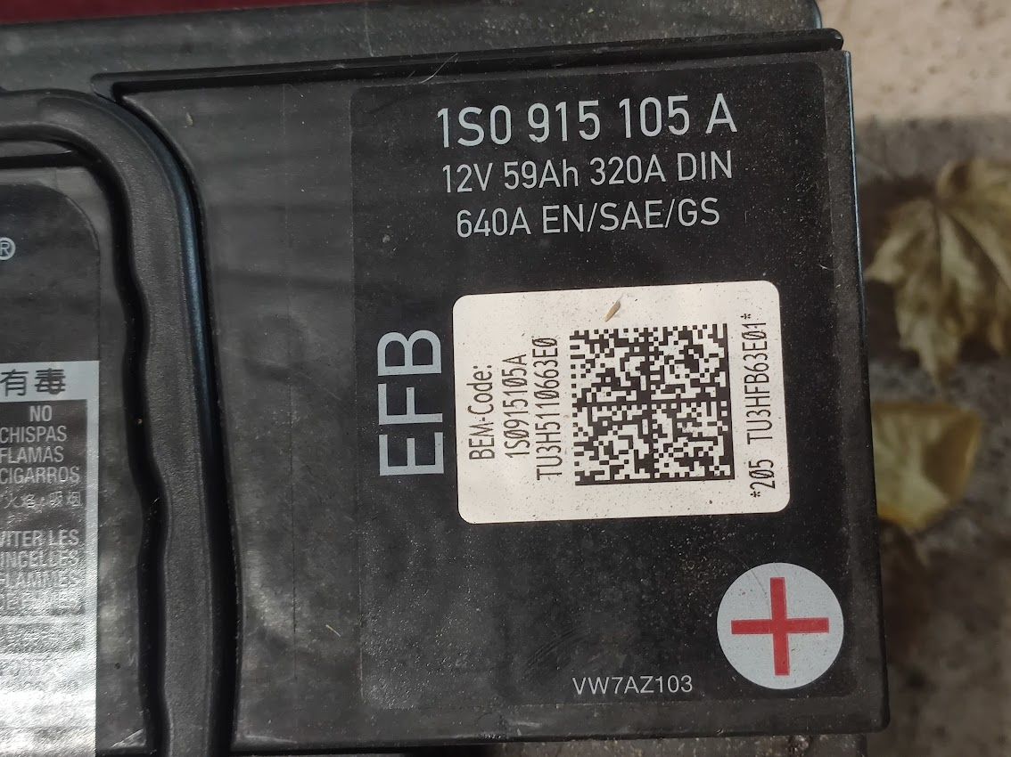

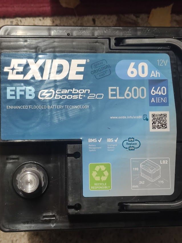

Ok, New battery purchased and fitted. I got the Exide EL600 EFB
Got all matter of warnings upon starting the car - tyre pressure, parking sensor etc etc. But once I drove the car all of them cleared apart from one - the Stop/Start isnt showing an error.
So, I thought I would get the BEM battery code from the new battery & get a friend at work (who, I found out today, has a VCDS device) to enter the codes - however, the new battery doesnt have an BEM code at all - typical.
So, does anyone know what to do in this situation? I would like my Stop/Start back!
Old Battery:
New Battery
Easy, you get that friend with VCDS to connect to your car and change the serial number even just by one digit, that will let the car's systems know that the battery has been replaced.
As a side note, I changed the serial number of the Exide EFB in my wife's 2015 VW Polo 1.2TSI by a single digit, ie I increased the number nearest the end by "1" to see if it would improve the charging characteristics and it did, that battery is on its way out, but so far refuses to cause me any trouble, I only spotted the change in charging characteristics because I bought and fitted a plug in 12V DVM into the front power socket! New bigger size AGM is still waiting in the garage for "its time".
Reactions: SuperV8
ONLY VAG OEM batteries have a BEM code.
All aftermarket batteries - including Vatra/Bosch etc.. don't have BEM codes.
As mentioned just changing 1 digit in the serial number is enough to reset the battery management.
You also need to update the Ah to the new battery Ah.
I remember now that my stop/start didn't work at first but resolved itself after a few journeys with no intervention from me.
