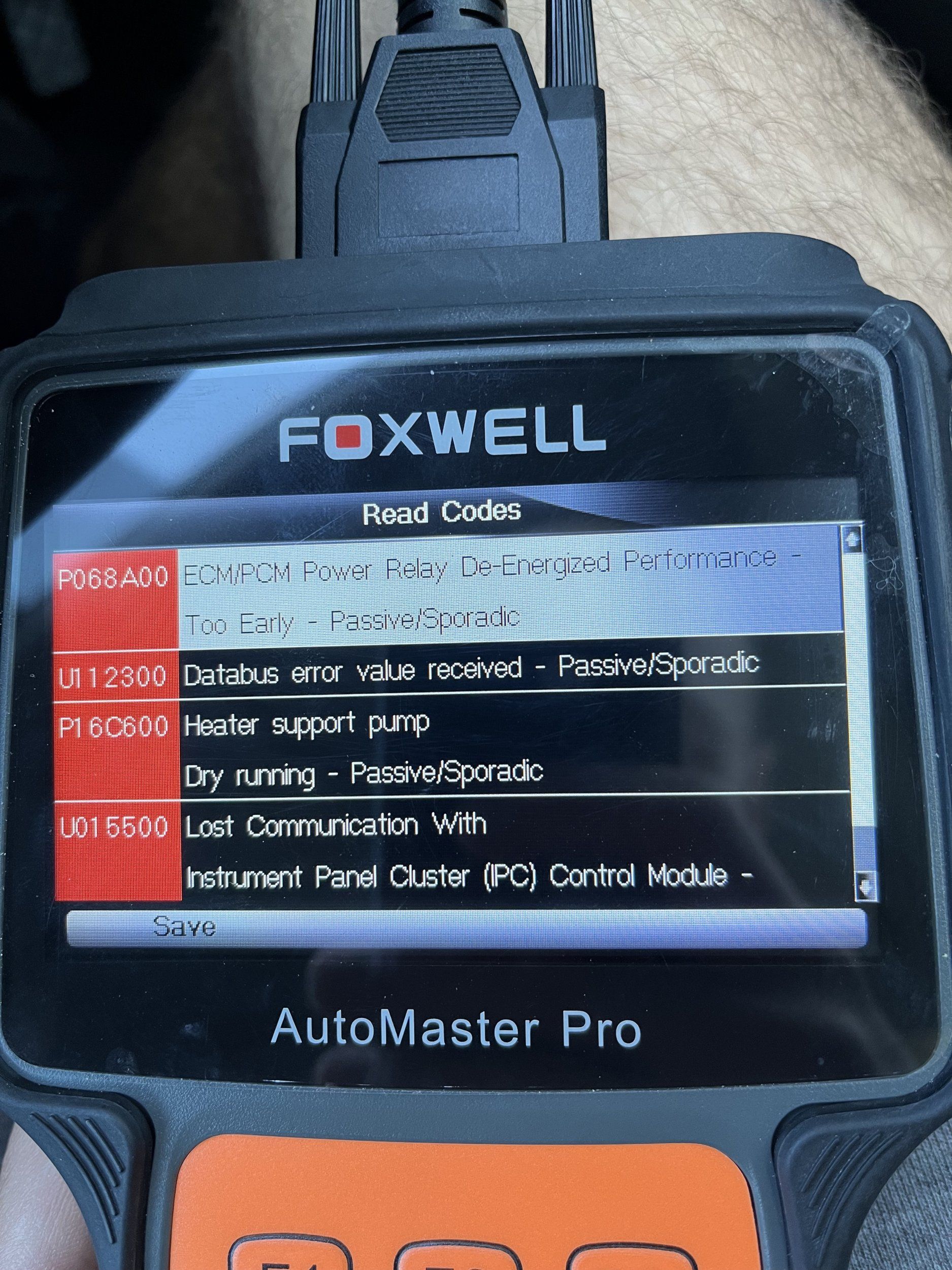

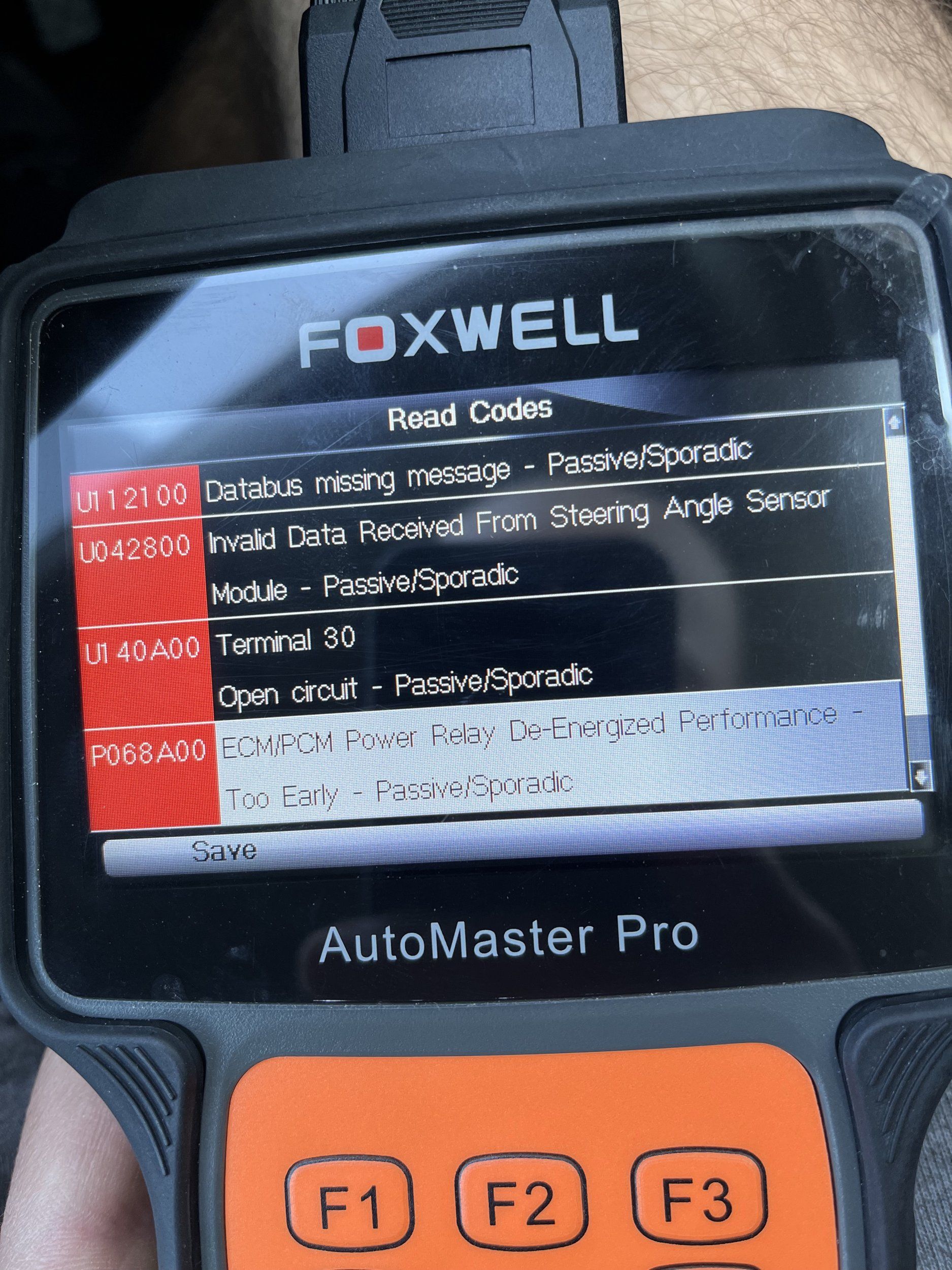

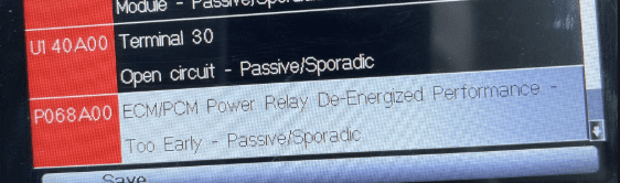

As a test I let the new battery stay connected for 1 month, and when I came back it was still exactly 12.5 volts, so no power draw there. I ran the computer on it, and have among other faults, the fault code P068A00. The instrument panel in the car displays the glow plug flashing and engine management light.
I cant figure out what went wrong?
Did jump starting fry a module, or is the new battery not playing ball, something went wrong or something gave at a certain point but so random I cant figure it out.
My OBD scanner cant register new batteries, and obviously more modern cars such as this will auto register once it does a few miles, but can't do that either.
I have already checked the fuses, and none are blown.
I will attach pictures of the obd scan results, along with other faults that might be relevant. If ive missed info please let me know. I appreciate any response :)

You really need to start with getting the new battery coded in. This ensures the battery monitoring system is still not over compensating for an old battery. Also, it's not a good idea to just drive a diesel around the block to warm it up. This engine needs several miles to warm up properly. Swapping over the battery will chuck up loads of random errors to start with, which won't help, but should go away after a drive and leave you with ones that are an actual issue. Googling that code gives you lots of things to check over. Hopefully it's not the ECU, good luck with sorting it.
Thanks Steve! Do you think if I had someone come over with an OBD reader that could do battery dionogstics, that could sort the battery out? I agree it's not ideal, hasn't seen a motorway for years!
